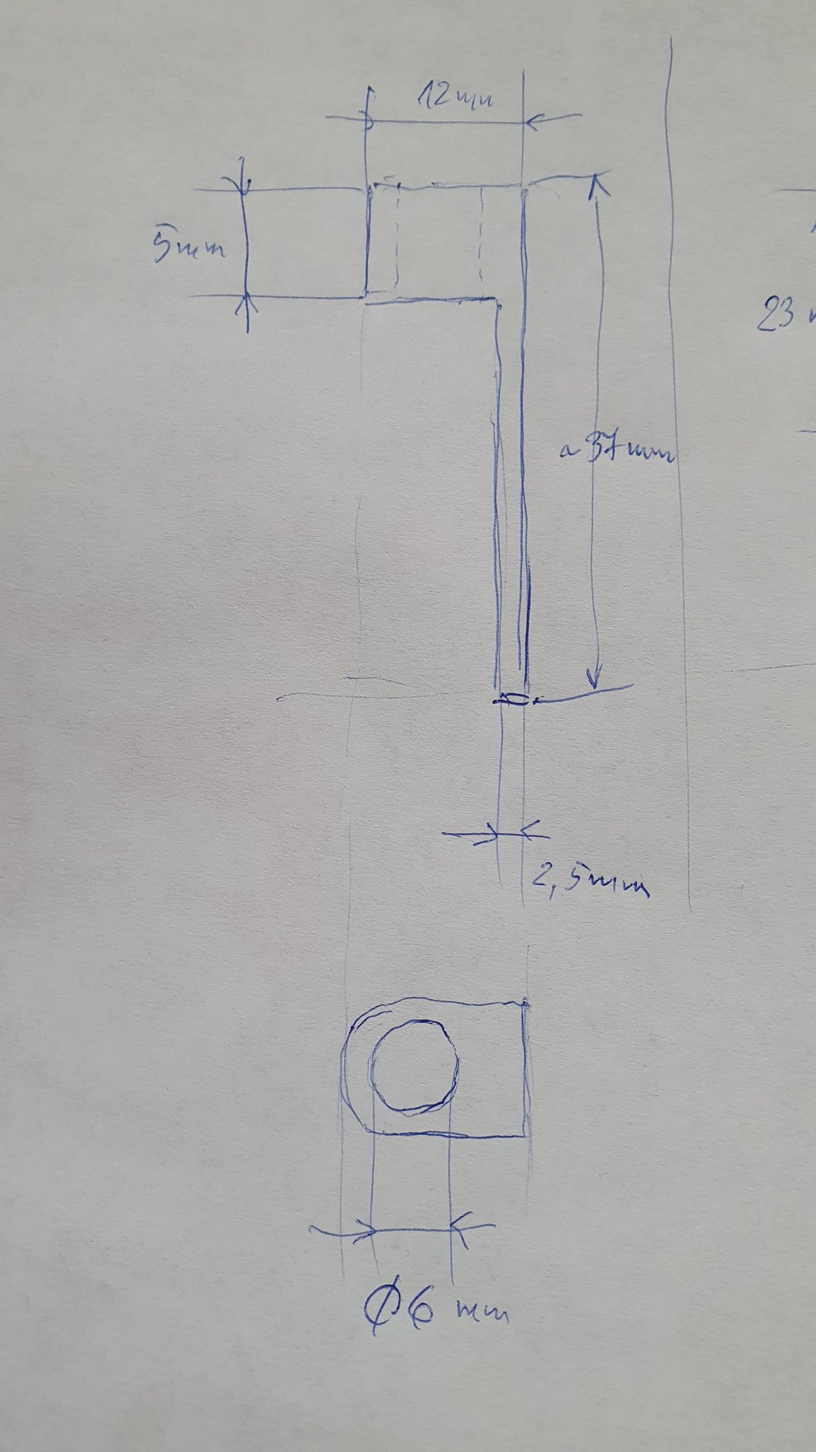

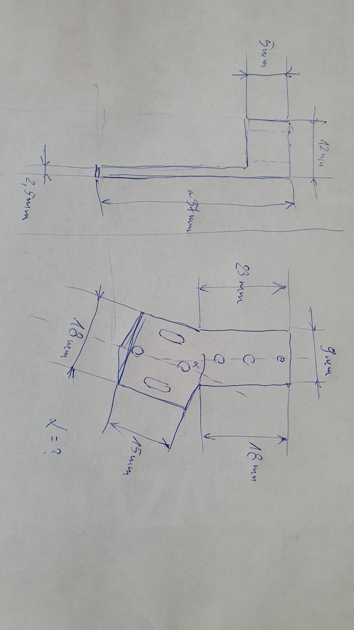

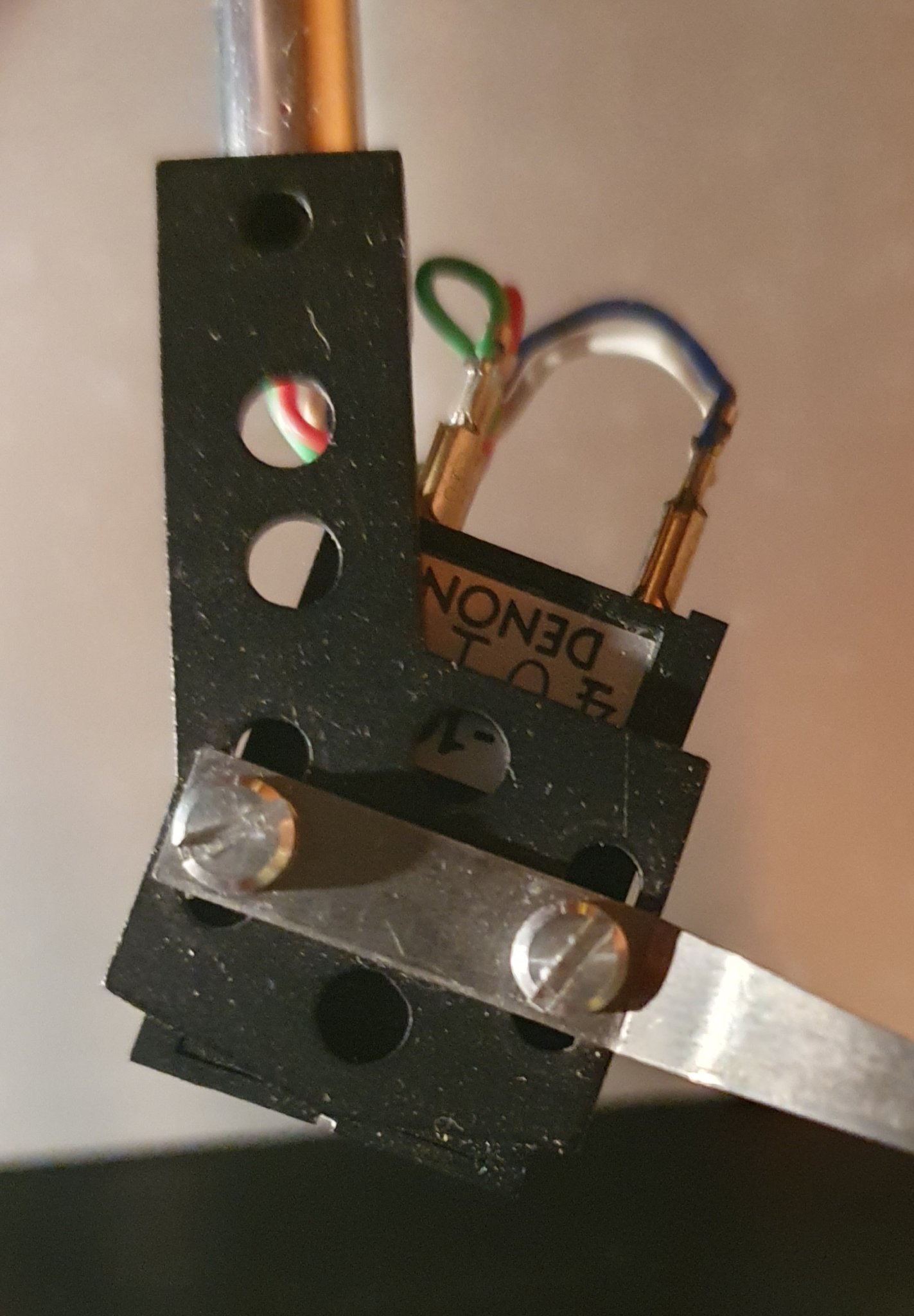

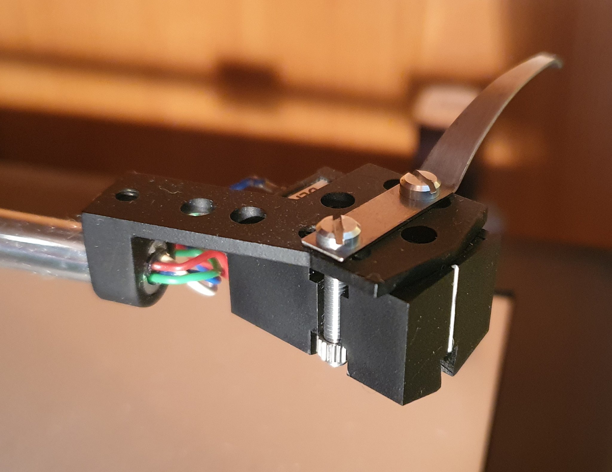

I'm working on some models to 3d print headshells. I wanted to try unipivots again so figured that I'd start with a Mayware Formula 4. I will first print these in plastic. Would anyone who owns one of these be able to help with some dimensions? I believe I'm fairly close but don't have an original headshell to measure against.
The model I'm thinking of has the thicker version of the headshell.
The lengths of the different sides, and the height and width of the end that goes around the tonearm tube.
