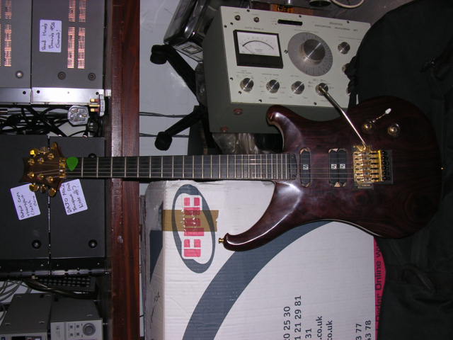

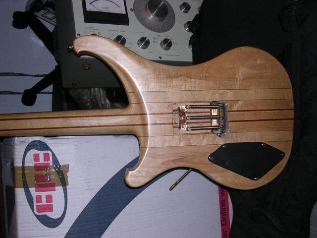

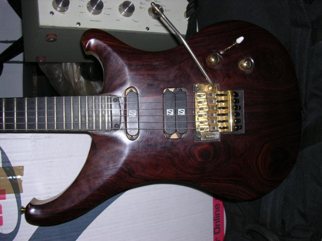

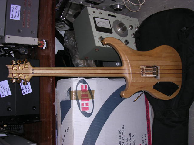

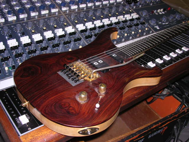

I've built my own electric guitar, go for it!
I went for a nech through body style so the neck is one piece from the headstock right down through the body.
I used Canadian Rock Maple for the neck, sawn into 3 strips then the middle one turned over and the 3 glued back together with mahogany veneer between them giving me 2 funky pinstripes down the length of the guitar and making sure if the maple warps with age the centre strip should warp the other way to the other 2 reducing any over all neck warping.
the fingeboard was ebony and bought as a pre cut item, I then fitted the biggest damn frts I could find.
the guitar body was made from rock maple again to match the neck as it goes through the body, even hollowing this out to some degre it still weighs noticable more than a les paul!
finally the body top and headsock were capped in cocobolo (3/4' thick on the body) and the top sanded into a slight arch top, the body is roughly based on a rickenbacker 4001 bass. hardware is all gold plated gotoh stuff because it was cheap at the time. floyd style trem (it was a good few years ago) and locking nut.
its a great guitar to play if you don't mind something with a very fat neck, the electrics were ultrasonics single coil sized humbuckers and it works a treat.
I still have a Hofner tele neck to make a guitar for my Mrs, been meaning to do that for years, it will need a lighter body for her though, I quite fancy Zebrano for that one.
