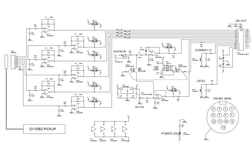

Local preamp at guitar schematic:
Schematic from: https://www.vguitarforums.com/smf/index.php?topic=73.0

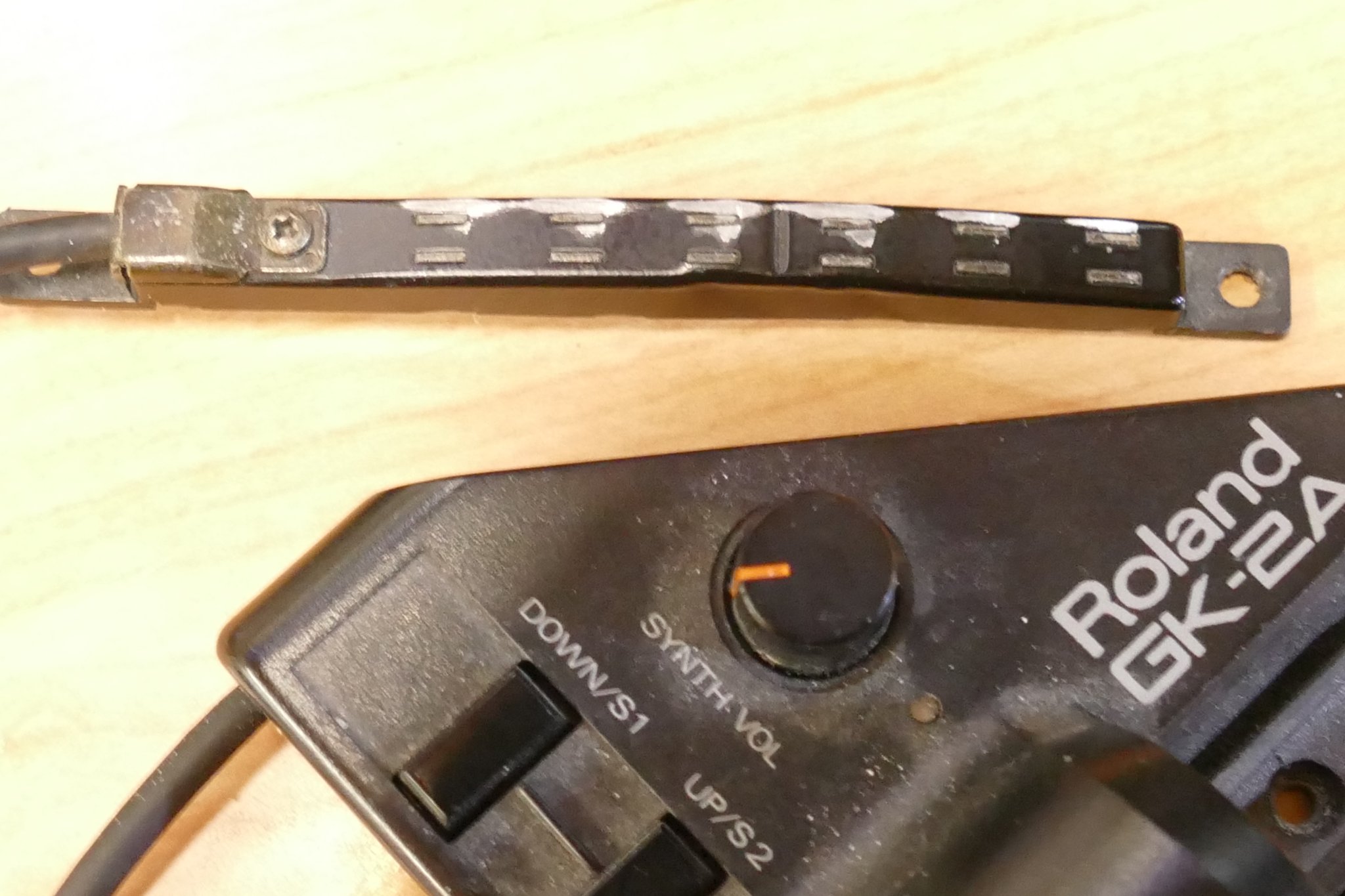

I haven't looked into the Jamstik stuff since it is beyond my budget. I do have a Roland GI-10 Guitar to MIDI interface which includes the GK-2A hex pickup. This unit is from the mid 1990's and is far from perfect. Your schematic is from the GK-3 which is very similar.
I had the GK-2A on an old UNIVOX branded Mosrite clone which was fitted with fairly heavy strings for several years. I had to place the divided pickup very close to the strings to get good tracking. The picture shows that it was a bit too close though I used that guitar for about 15 years until I wore the frets down.
This system and some of the newer Roland stuff did not make the individual string outputs available to the user, though many achievable hacks were published to do this. Some people who did this reported usable audio, some said that it was distorted or muffled. Since the original intent for this system was to provide a MIDI output from a guitar, clean audio was likely not a priority, or even a consideration, as the system left the guitar's audio output unchanged.

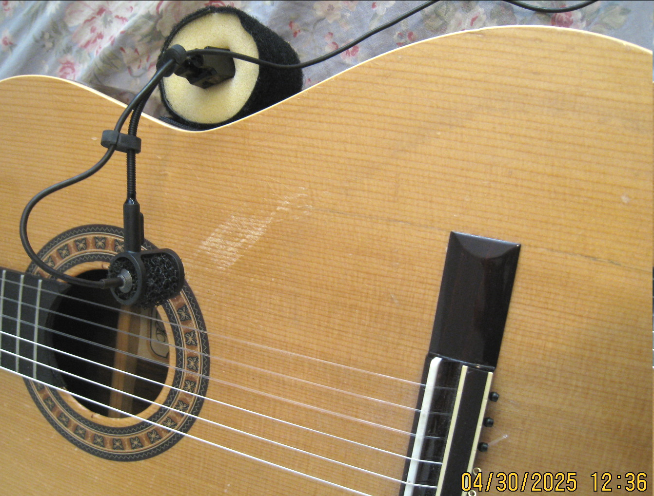

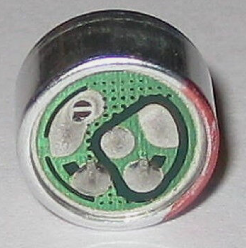

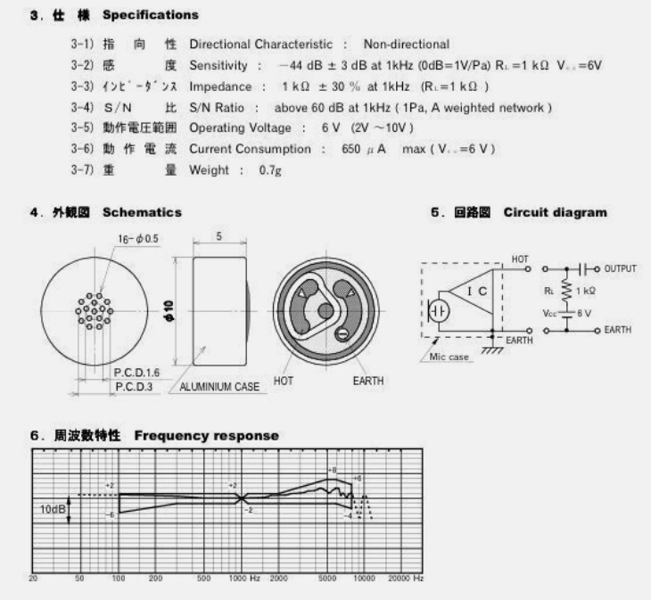

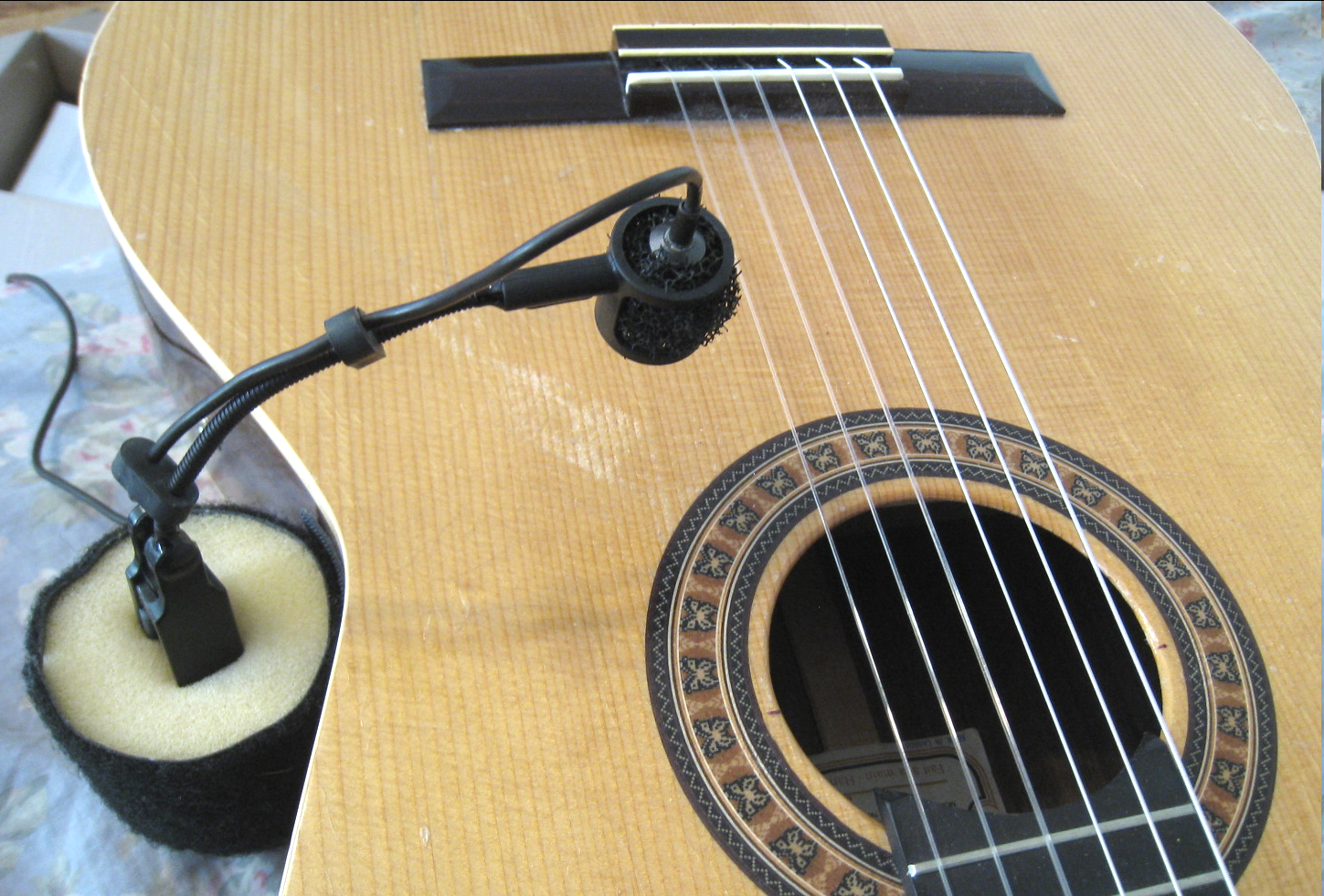

Here's a repeat of an earlier attempt, this time using an AudioTechnica electret capsule microphone, instead of a Shure dynamic. Seems to work better, less prone to vibration pickup.
This is all to try to meet a challenge from another player; a guitar mounted pickup system that sounds like a stand mic'd acoustic tone. He seems currently content with his soundhole mounted mag pickup on his steel core strings, but hasnt yet committed to a drilling out the tail block. I like nylon.
- A round foam plug is velcro'd to the side of the guitar; that way I can remove it fairly easily. The curve of the guitar body is a pretty stiff mount point. I stand when playing on stage, otherwise there'd be leg interference in a seated position.
- The gooseneck arm is an ebay purchase (https://www.ebay.com/itm/186885465340) - it grips the end of a wood stick suspended within the foam plug.
- The mic is an AT 831A, also an ebay purchase.
- The mic is suspended in some kind of filter media, in an attempt to avoid blocking its side ports
- The mic can be easily adjusted to pick up more toward the bridge, or more toward the sound hole. Response is more bass up by the soundhole, however likely more prone to feedback when playing live.
- The velcro adhesive interacted with the guitar's top finish, when I had the cable from the hex pickup attached. It's my Franken-guitar, that I try out different pickups on.
