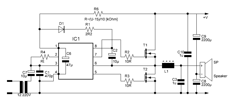

See this simple class D amp with IR215x:
For freq. 100kHz is best (I use 80k)
Calculate freq. same as in IR2153 classic application.10u don't affect to the frequency because that secondary of transformer has very high impedance to cause any change in freq.

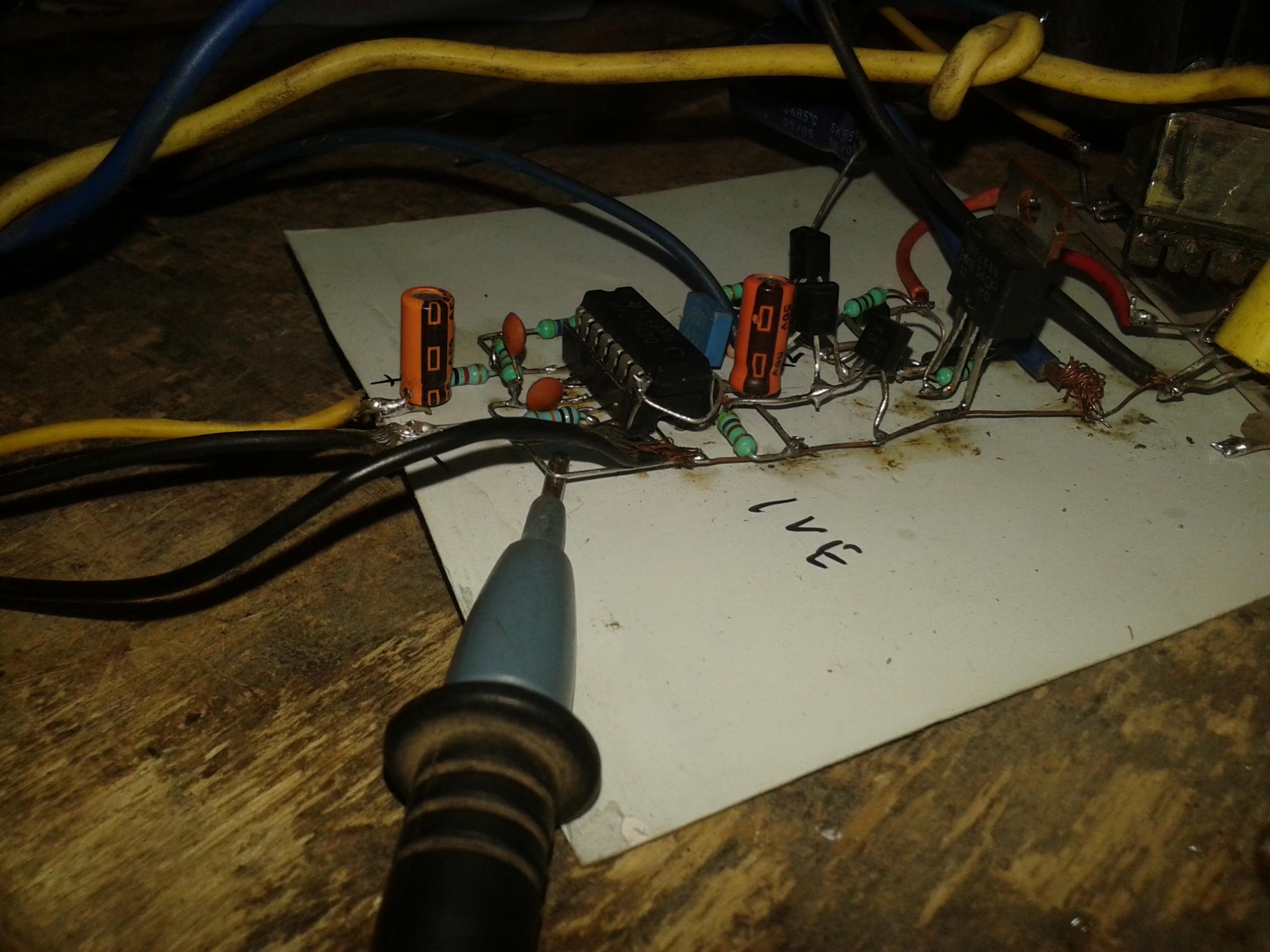

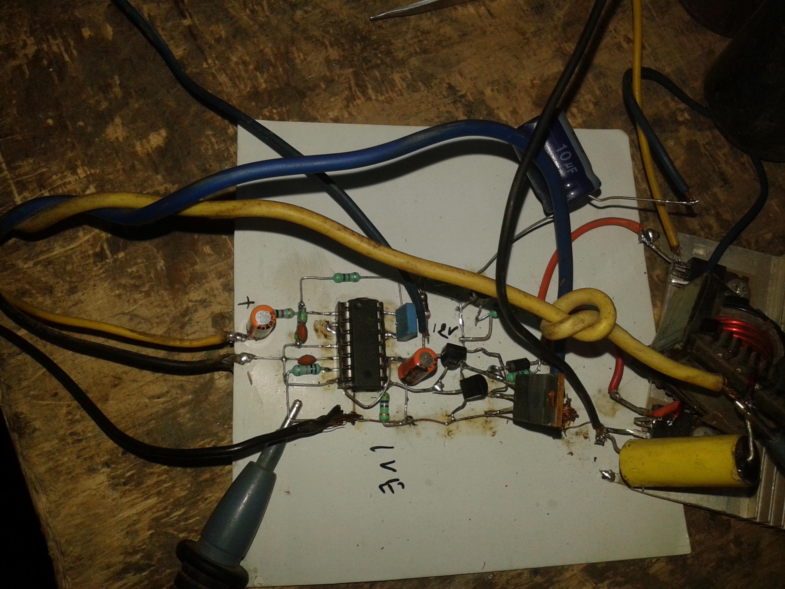

Few pics tonight...
Sound good and no hum or hiss.
I use 12V to 220V transformer,power is not important.220V coil goes to IR and 12V goes to audio signal.One nice thing is that here is no 50Hz ripple on speaker when touch input,and audio source is isolated.Transformer boosts bass and it's used to amplify small signall from telephone,mp3 or another thing
Input 10u cap can be smaller,like 1u
D1-UF4007 or any ultrafast diode

Schematic:
Few pics tonight...

Few new (better) designs from me
All schematics is tested.(second schematic tried directly on 310V line,with IRF740)
