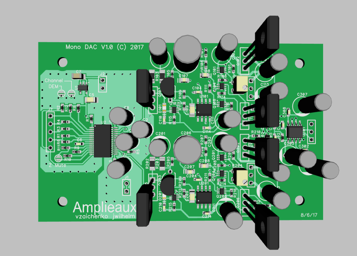

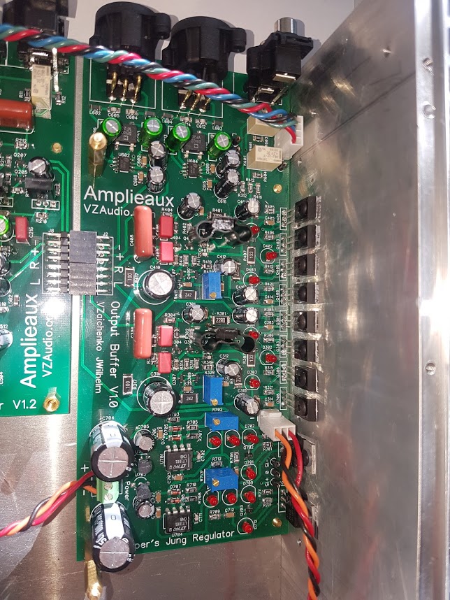

With VZaichenko's help I've been working on a modular design full featured preamp with the design goal being a very good quality preamp DIY option for experienced builders. The initial design vision is to include single ended and balanced analog inputs, optical and coaxial SPDIF inputs, optional USB input, single ended and balanced output an optional headphone amp. I'm looking at optional FM tuners, Sirius/XM, Bluetooth ect. Control will be open source Arduino based with options for control over Bluetooth, RF, Wifi, IR (any format really). A 2U chassis is the target size for the whole project.
I have a couple prototype boards running so far. The analog design is almost complete. The input board has a couple errors and I need to add some more internal inputs, so it will see at least one more spin. Volume control is done with a PGA2310.

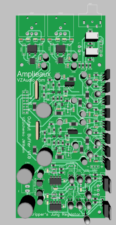

The output buffer board is working very well. It has an onboard Jung regulator designed by Ostripper to clean up the analog input supplies. The output buffers are one of Valery's current drive designs. It has RCA outputs as well as a THAT1646 differential converters for XLR out

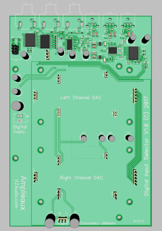

The SPDIF selector board is designed to stack on top of the analog section. I have a first round SPDIF board operating, but I want to add extra inputs for I2S selections. This board also acts as a back-plane for the DACS. Mono PCM1794 DACs with output I-V converters and buffers designed by Valery will stack on this back-plane. These boards contain power supply pre-regulators and regulators locally for all their circuits as needed.
I've designed all digital controls to accept multiple voltages to allow for control from more modern 3.3V microcontrollers.

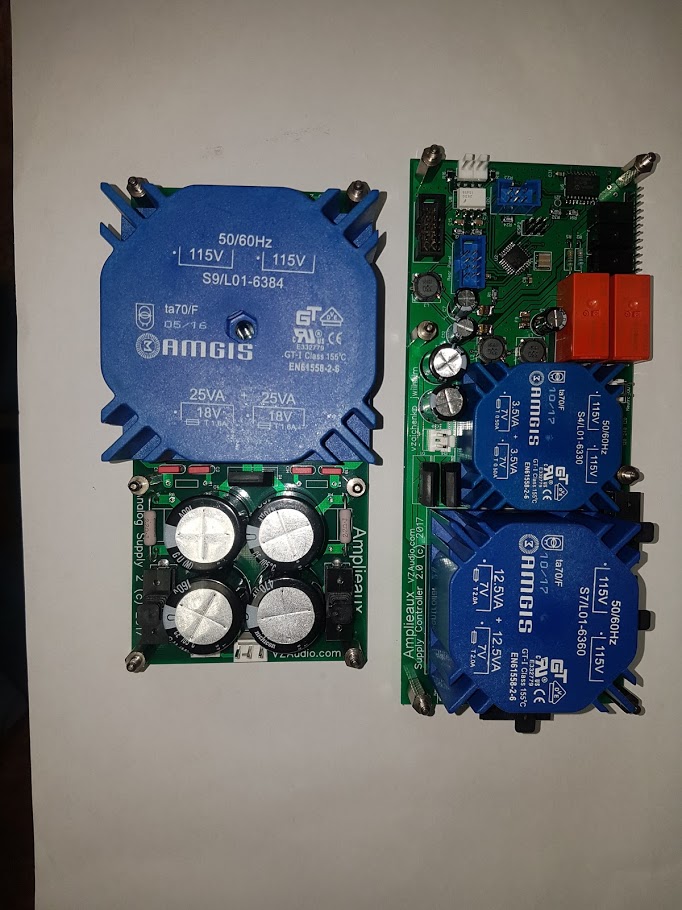

I have power supplies designed to fit in a separate chamber/Faraday cage to the side of the preamp. The analog supply is a simple unregulated supply with CRC design, the Jung regulator on the output board feeds all analog power to the rest of the preamp. The digital supplies is a lot more involved. It has a control transformer that powers all switching and controls with an onboard microcontroller controlling the analog supply and monitoring it's voltage. It has 12V, 5V and 3V3 outputs that are switched by onboard relays for any digital control needs. It also has a second unregulated supply for the DAC and SPDIF boards.
A lot of hours (and dollars) have already gone into this design and there are a lot more to go. I haven't done any formal measurements on anything yet, but the input and output buffers do a wonderful job, not adding anything or taking anything away from the sound. Output noise is under 25uV, so it's dead silent. Ostripper's Jung Regulator design is delivering wonderful clean DC with ripple well under 500uV from no load up to 1A+. The SPDIF switch is performing perfectly. The board outputs I2S signal to the DAC boards with no issues. DAC designs have had a few bumps but are coming along well now.

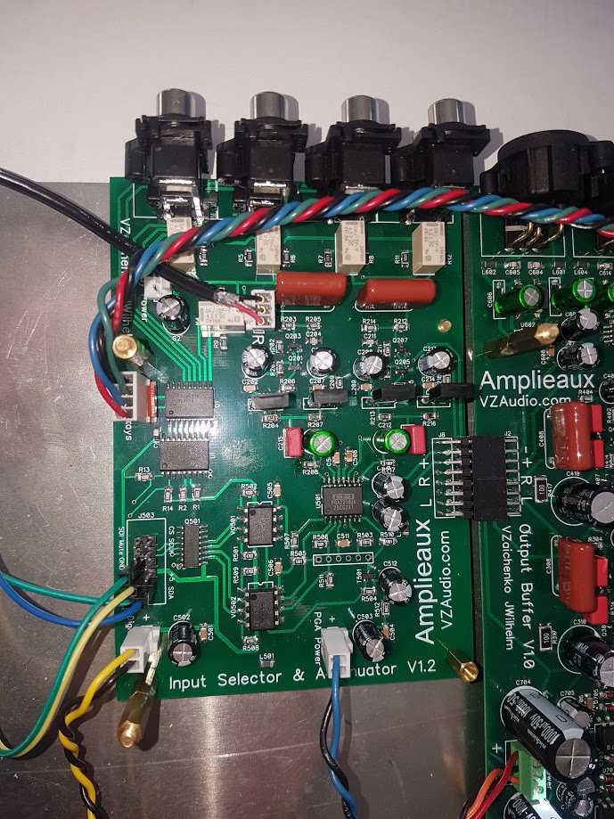

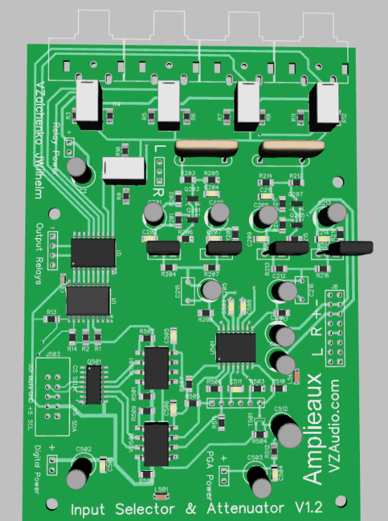

Since you use bjt input opamp/buffer without match input impedances and no means for output dc offset control, how do you plan to control it? Btw, I like the basic principe.
The input buffer is fet input. There is a bit of DC on the output, but it's AC coupled to the PGA2310, so it's not an issue anyway. The output buffer is trimmed by R320/420. This is the same input as our VHex+ amps use. It's very stable, only drifting a couple mV from cold to warm operation.

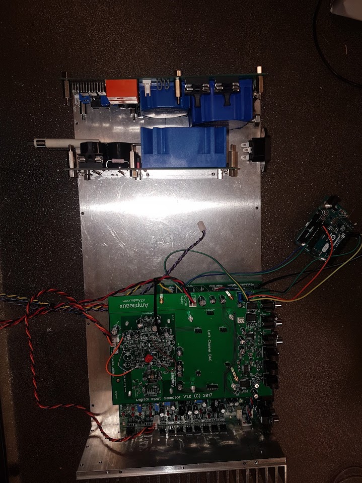

The supplies are assembled and ready for testing. The layout is working out well. Power entry is short and sweet!

1)On the PS/mcu schematic, I see a net called "GND" connected to J1-6(ICSP conn) and the un-named part Q2-9(ULN2xxx?), where else does this net connect too?
2) You are putting regulated voltages through fuses F7-9, why? The SMPS regulators, U1,3,4 have OCP. If you need the fuses, then why not monitor the o/p after the fuses to see if they blew or not. I think you have some spare pins on the m328, adc0-3
3) Does Y1, have internal phase shift caps? More expensive part than a reg xtal. Probably can use the int rc osc fuse option on the m328 and not even need a xtal.
These boards are all just first round proof of concept boards basically. I just put them all together quickly for prototype testing with the intention to test what works and what doesn't then design a final version. The schematics are pretty much just cut and pasted circuits from other designs to get up and running quickly. There will be some anomalies in the schematics.
On the power supply schematic, all grounds are common, whether marked GND or digital GND.
The fuses were an afterthought in case I make a mistake while connecting hot during testing. The final design will monitor these outputs.
The resonator does have internal caps. These are cheap and really easy to install. AWSCR-16.00MTD-T ABRACON | Mouser Canada
I've already found an issue with this board design. I've used this same switching regulator circuit with this same Atmega328 circuit a few times recently. This was all cut and pasted from a previous design. On this board programming was very sporadic and the processor would run fine, then stop working completely for no apparent reason. I finally figured out the Atmega328 didn't like the supply and needed a bead in series with the supply to operate. Silly problems like this are why I do multiple versions and don't sweat the little stuff in the first round.
