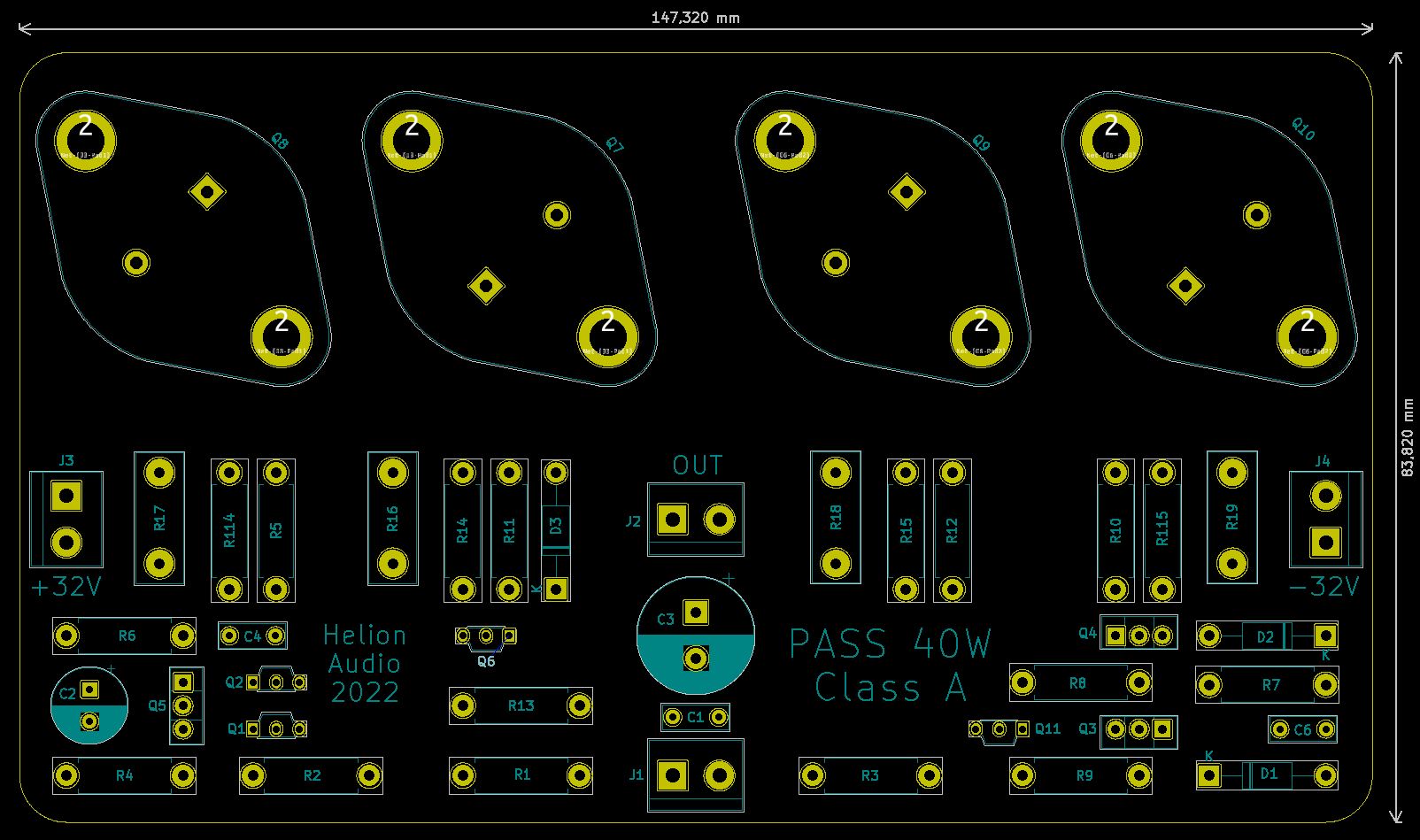

Some day, in this life or in the next, I want to finish my Pass 40W amp... PCBs made 3 years ago.

But here's the 40W, that may generate too much heat for the cooling bracket?
(I have commented on this elsewhere: Helion Audio is my imaginary Audio company. I don't sell anything and hardly make anything - except the occational PCBs,,,.)
