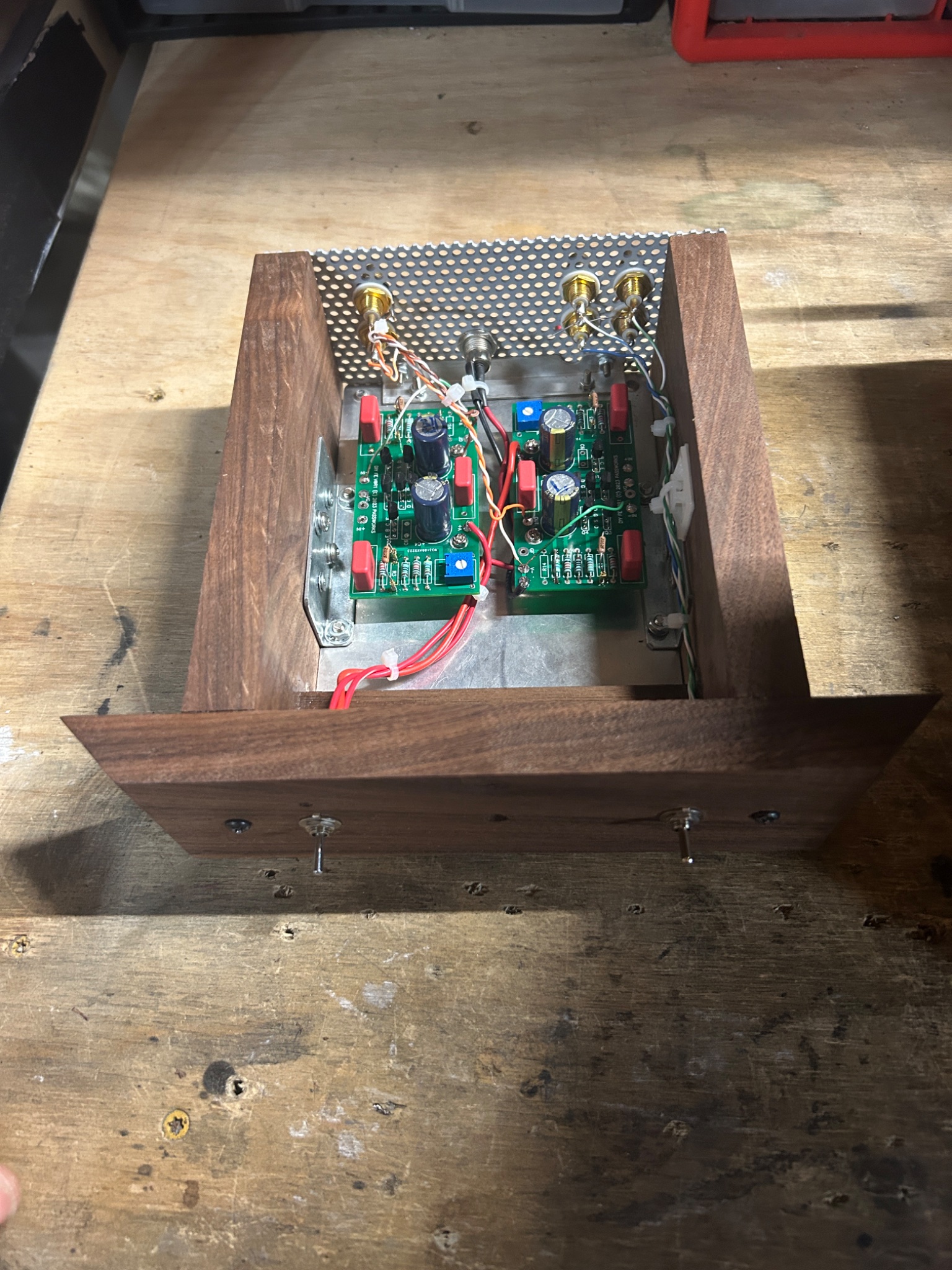

Question about this front end kit when using a 48v Single V+ switching PSU.
I am getting a high pitch squealing sound with the larger 48V, but when using 19V and 24V the unit is dead quiet. Tried 3 different 48V Meanwell supplies and each one squeals.
I have R13 stuffed. Could that be what is causing the issue with the 48V wart?
  • R13 stuffed
  • R10 is jumpered
  • V- being used as ground jumped to -in
  • VG is not being used
  • I am not using Marks SMPS filter
The preamp is powering Amp Camp monoblocks at 5db of gain. Is it even necessary to get the larger 48V PSU?
Any help is appreciated!

Were C6 and R14 omitted?
DIY FE with 5dB of gain - what resistor changes did you make?
Amp Camp Amplifier does not need high voltage input signal (has 14dB gain (5X) and 5W output) so 48VDC power supply is not necessary for the DIY FE.

Yes. C6 and R14 both omitted but I stuffed R13 with a resistor. I snapped this pic before finishing.
I can take a new one tomorrow. But knowing a 48V is overkill maybe 24V is the way to go?

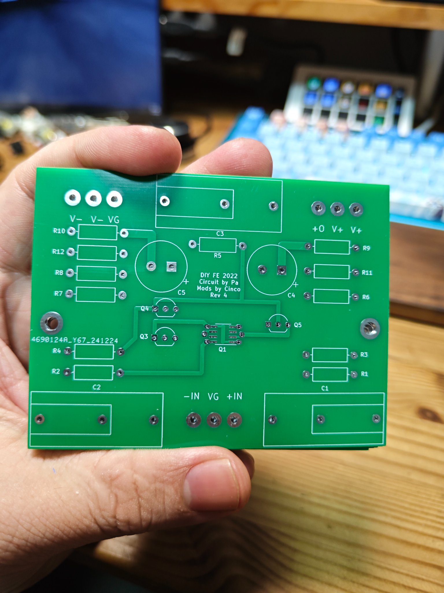

I started with +12dB (which is R3 & R4 = 40kohm) on my MoFo. I like to socket things until I settle on a permanent value,
When I'm happy with the value, I remove the socket then solder in permanently.
BTW, these are my own PCBs with Texas Instruments JFE2140 as the long tailed pair. Can also use LSK389 SOIC or TO-71.
I got a little impatient waiting for boards to be stocked in The Store. :sly:

Somebody is either breaking down or oscillating at the higher voltage.
Try using the compensation cap on the 2nd stage. If that doesn't do it, try replacing the P or N channel devices on the output stage. Also (easier) load the output with some resistance to ground.
And see what you get.
Thank you for the recommendation here. I ended up sticking with a 24V PSU and no issues there!
If I go up to 48V in the future I will try the compensation cap.

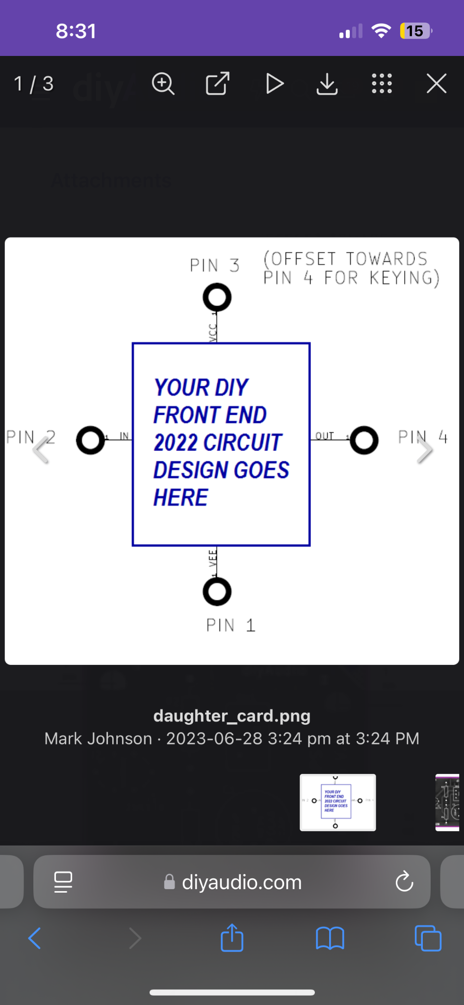

Has anyone took Mark’s advice and used the front end as an input for the m2x (as the daughter board). I would use the boards from the store.
I’m thinking of trying it but a couple questions.
- to power the FE boards, should I take the the V- and V+ to the Pin 1 and 3 M2X posts or direct from the psu board?
- for Pins 2 and 4, can I take the output of the FE directly into Pin 4? This would bypass CO, R1 and R2, correct?
- what gain would be recommended? I was thinking 5 db or 10 db.

Re. gain: the other option is to employ the fe2022 as the sole gain device and omit the edcor trafo completely.
Of course some people will say it's no longer an M2x, but to me the main feature of M2x is the total lack of NFB, local or otherwise.
With fe2022 in place you are introducing FB at least to a portion of the amp and that will definitely make it sound different, not necessarily better or worse, just different.
