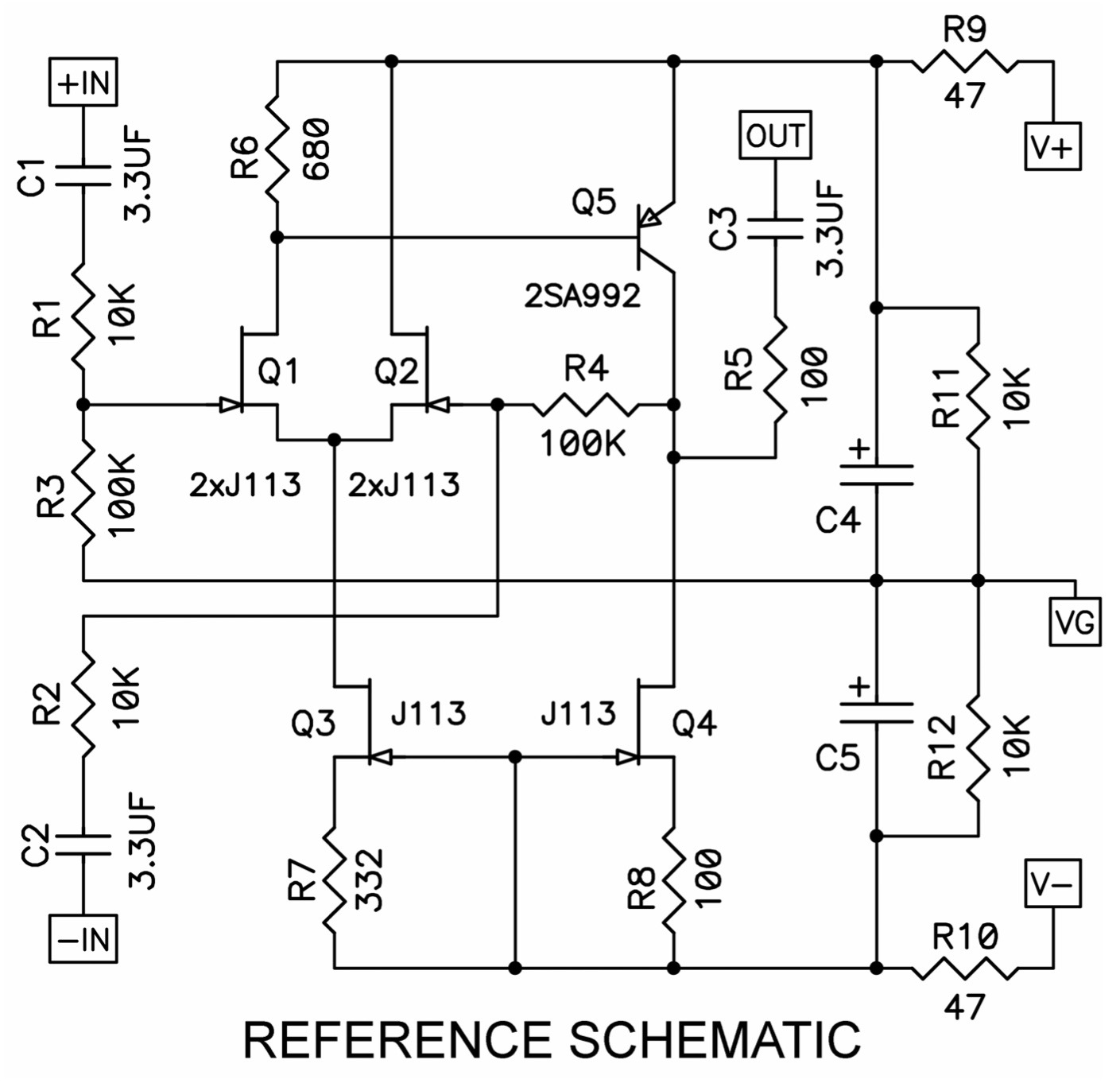

Question : If my psu is single rail 34v, I’m I good with 25v caps for C4 and C5? My understanding is that since they are in series they share the voltage but I may be wrong.

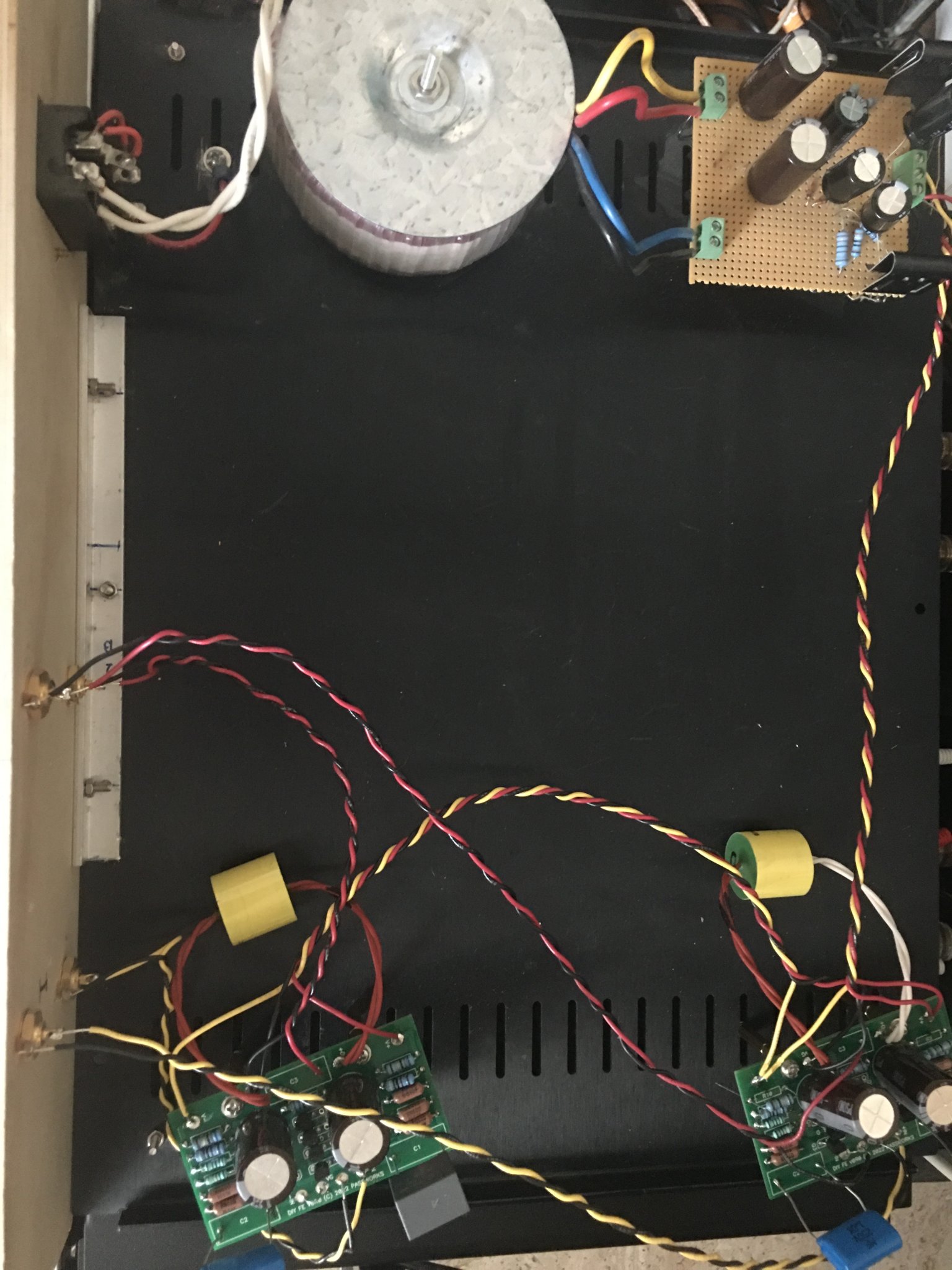

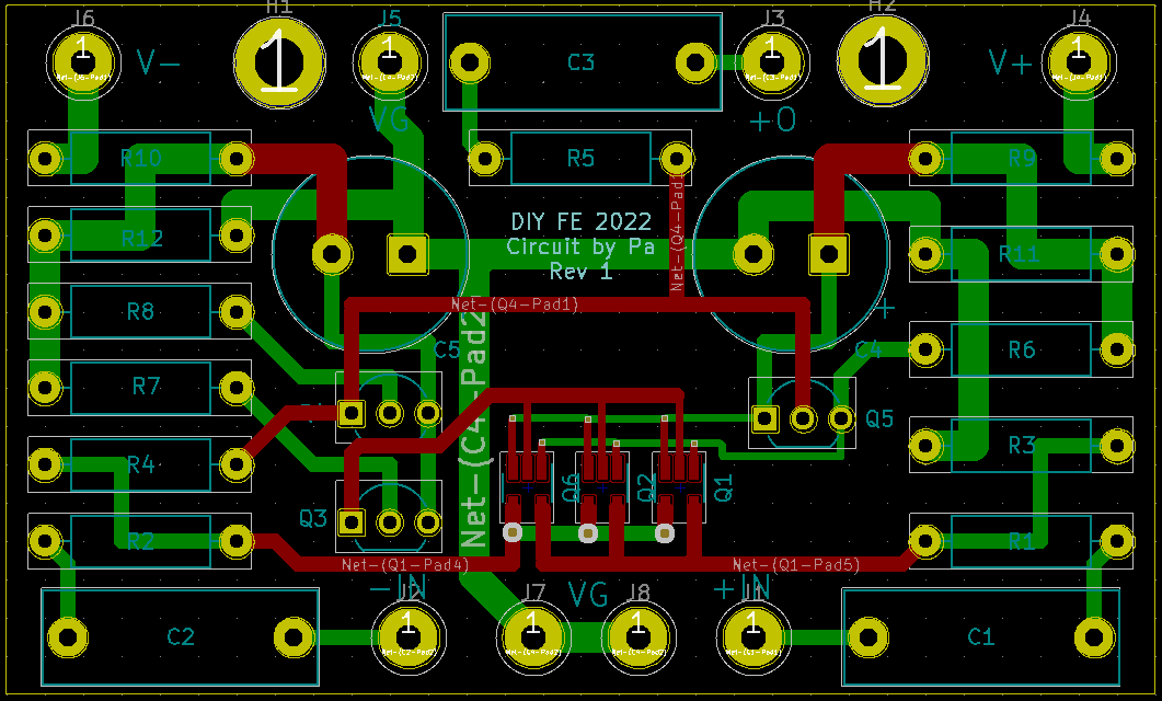

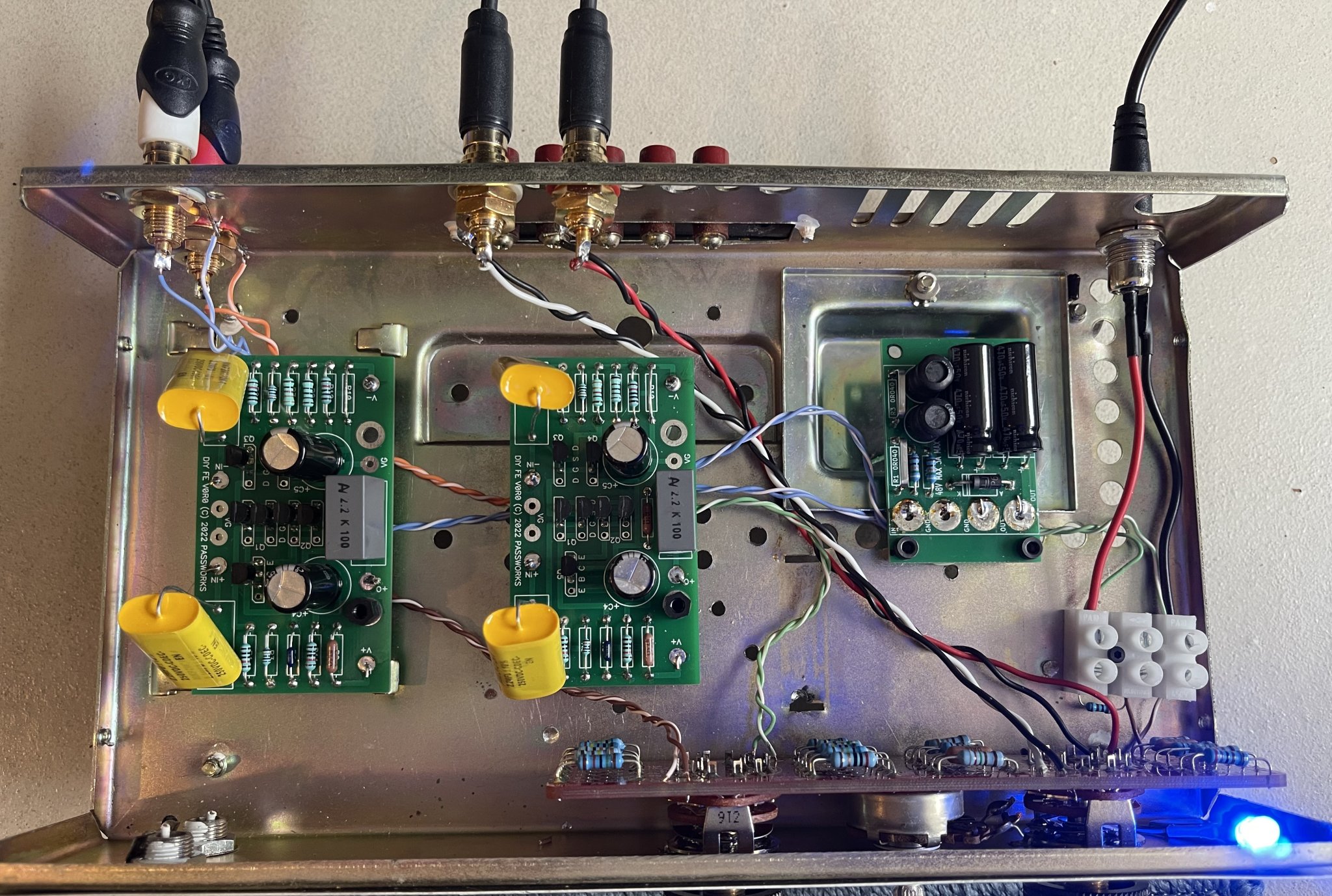

Attenuator output ground attaches to V-, not -IN.
-IN jumper to V-.
Yes, the V- pad gets a lot of wires to it.
Thank you, 6L6. I updated attenuator ground connection to V- and that made the difference. I also cleaned up the wiring and made things a bit neater.
For those keeping score at home for a single rail power supply, SE build, I had 4 wires at the V- connection (for each board)-
1. Jumper from -In to V-. (A small length of wire under the board connecting -In to V-)
2. Wire from ground of input RCA jack to V-.
3. Wire from ground of output RCA jack to V-
4. Wire from power supply ground to V-.
VG connection points were not used.
I was using a thin wires and I was able to get all four wires into the V- connection. With any thicker gauge wire, you'll need to be creative since they won't all fit.

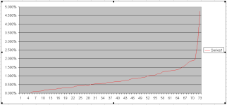

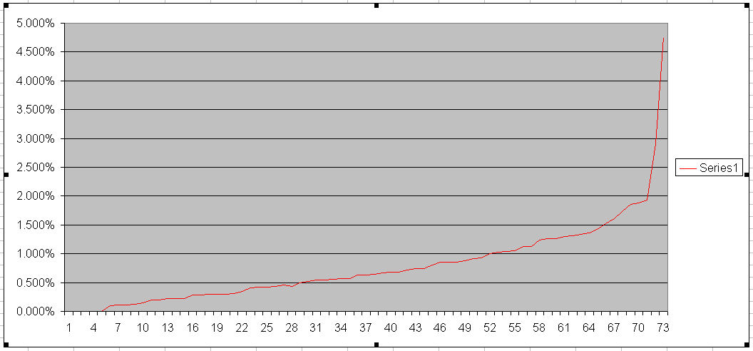

So I got curious about how good the matching on some of my JFETs was for this FE:
LSK389B, 6 samples, here's the percentage error match between the Idss of the 2 sides of the dual. I paid about $8.50 ea for these, $51
%diff Idss1 Idss2
1.29% 11.44 11.59
1.63% 10.83 11.01
2.51% 6.60 6.77
2.99% 8.10 8.35
4.03% 6.91 7.20
5.58% 10.66 11.29
That 4% and 5.6% are a little disappointing. The 5.6% is still within the +/- 1mA tolerance spec BTW.
J113, 100 samples for $27, (need 2x of these to equal gm of those K389's).
I binned these at 0.3mA increments. 17.4 mA ave Idss, so about 1.72% matching in those bins.
Could bin to 0.1mA to get 0.57% matching.
2SK2145-BL, 120 samples, $41 (only 73 tested, 'cause I got lazy and had enough to get the matching I was looking for at the time). [need 2x of these to equal gm of those K389's]
Wow... the side-to-side match of my 2SK2145's was better than I remembered. Attached the chart. 8.21 mA ave Idss.
Hmm... might get boards for these instead. 🤔

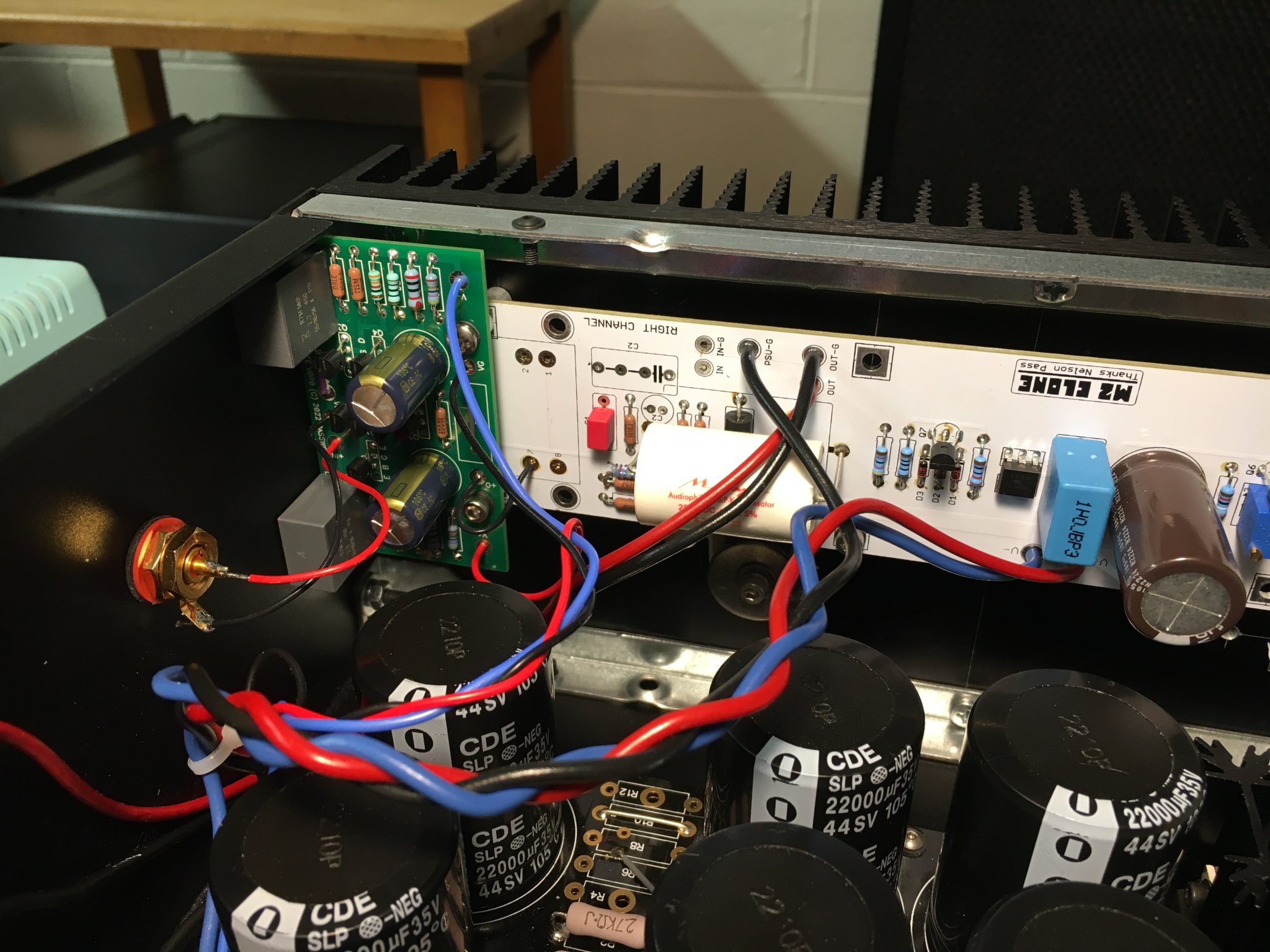

How does the 2022 FE sound driving the M2 OPS? Pretty darned good so far. I'm going to continue to listen to this setup for a while to get a good measure of it, then I will dig into some of the ideas proposed in Patrick's The M2 Output Stage in Class A/B, and maybe a Power WHAMMY thread. Specifically I'll be looking into the nested feedback configurations and alternate output devices. But that is a discussion for a different thread.

Cinco, thanks so much for sharing your measurement data, that is really encouraging regarding the 2SK2145's. Could you share your raw Idss numbers so I can get a sense of how many matched pairs of 2SK2145's could be created from the parts in your sample set?
The 2SK2145-BL data is similar to mine for GR.
Of course because of the larger Idss of the BL grade, the difference in % is slightly lower.
I personally only use 2SK2145 in GR grade, although it does not matter in this circuit.
Here you go...
