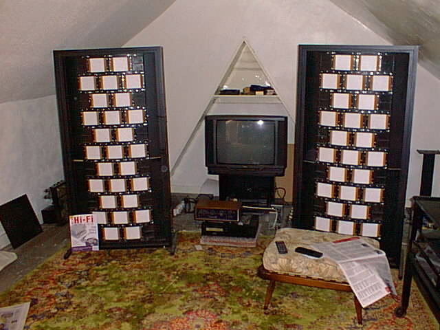

Wow the Blatthaller!!!!!!
From the this came the Orthophase design of drive unit developed by Gerard Gogny and Marcel Poutot in the mid 1950's.
Then in the late 60's early 70's Ernst Spiteri developed the ESL Orthophase .
I have a pair of the GeGo OR3 W4 Orthophase of 1959.
I also have a pair of ESL Orthophase OR27 by Ernst Spiteri.
L' Audiophile published an article on the Orthophase and its history in issue No: 48 juin /juillet 1989.
Also a page or two in Gilbert Briggs Book More About Loudspeakers 1963 pages 125 and 126.
These orthophase sound fabulous.
Unfortunately i do not believe that ESL are in business anymore.
Ernst also made some of the craziest turntables arms and valve amps that i have ever seen. Parallel tracking arms being one of his passions.
There is a crazy french web site which shows a very crazy french horn system and in the photo is Ernst himself.
He used to have a very upmarket shop in Paris in the 70's before retiring to Bretagne.
He was a lovely bloke and was very kind to me on the 2 occassions that i visited him .
Yes, i have seen it.
Unfoutunately the picture doesnt reveal any details about the construction that makes the difference from ordinary magnetostats.
Anyway, i have been thinking of winding a "coil" on the back of a stiff membrane with some hefty magnets both infront as well as behind it, maybe it will work.. :smash:
