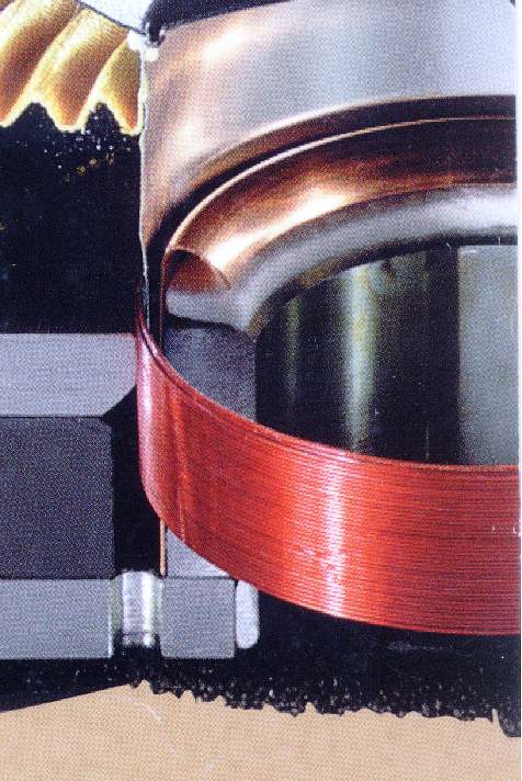

Cooper ring!!
speeker1qeek,
check the Audiotechnology sitehttp://www.c-quenze.com and give attn, to driver picture!!!!

copper ring part. :2
In Audiotechnology Dk. copper ring called "Symmetric drive".
-Symmetric drive uses a copper ring placed around the enter pole piece.
-The driver obtains a wider useable freq. range with clearer, more detailed sound.
- Greather thermal power handling.
-With S.D. the rise time is constant no matter where the cone is placed - lowers intermodulation distortion.
-S.D. lowers the inductance of the voicecoil and creates a more consistent impedan ce response.
-S.D. typically increases the rise time in the higher frequ. by factor of 10!!!
-S.D. makes possible both full bodied bass performance and fast clear midrange reproduction

welly welly well! an extended pole piece is what it is then! could someone give me a laymans explanation of a faraday ring then? the extended pole piece thing is a great idea if it would work. so adding washers would extend the reach of the magnets control over the voice coil then? could you do it on the other end also? i am sure it would take quite an effort to cut out the pole piece, glue it onto a circle of metal and glue that onto a plate. whew! i just confused myself! anyways, this sounds like a very do-able idea! i have many many cheap drivers laying around from old speaker i could try this on.
This is how I think of it. Imagine yourself sitting in a small boat and holding onto a pier, pushing yourself away from, and pulling yourself toward the pier. If the pier is made of 1000 tonnes of concrete then it is going to remain almost perfectly still, but if it is made of sticks of wood poking out of the water then it is going to move back and forth a little; the opposite direction to you as you play physics experiments in your boat.speekergeek said:could someone give me a laymans explanation of a faraday ring then?
When the voice coil flux pushes (or pulls)against the magnet's flux, seeing the magnet is not infinitely strong, it's flux is reduced somewhat (or increased, depending on the polarity of the voicecoil flux). Now if we put a copper shorting ring in the airgap, the varying flux from our wobbly old magnet induces a current in this shorted turn copper ring (only while the flux is varying!). This secondary flux has it's own magnetic field which opposes any change in the main field. It doesn't make the main field any stronger, it just makes it resist sudden changes better.
Sort of like putting a really big capacitor across the output of a dc power supply. It won't supply any greater continuous amps, but sudden changes in load won't shake the voltage around very much. Or like a big flywheel on an engine. It lowers the dynamic "impedance" of the magnet.

I don't think you do understand the principle, from what you say above.
A Faraday ring must be inside the voice coil, and there is no room for one.
Only way to do it is pull the driver apart and copper plate the pole piece.
Extending the pole piece with magnetic material will only work for an ineptly
designed magnet structure. Most cases it will make things a lot worse.
In this case the material must be magnetic, so copper cannot be used here.
