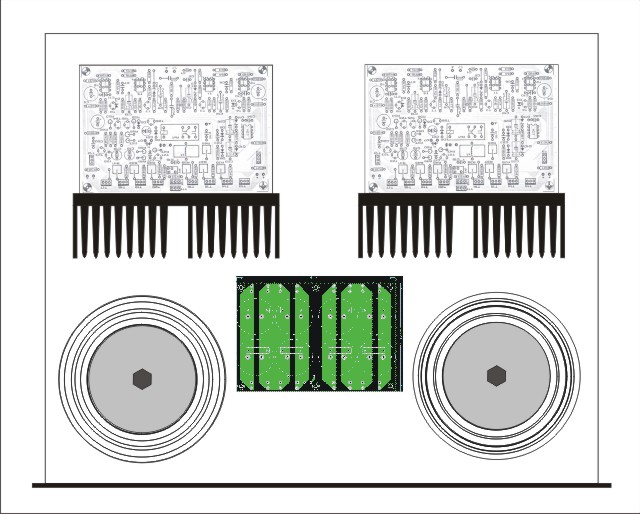

R!RC!... your image is so pretty, that is better to
Have a good wooden board, paint it white, keep wires hidden under the board, and fix it into your wall.
Do not cover that beauty...let people watch it.

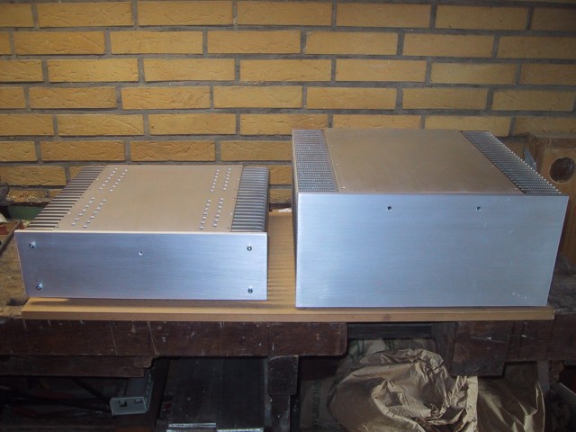

Depending on what they are meant for. For inspiration, here is two specimens I just finished today. The smaller one would be nice for a small ClassA amp or a hefty classA/B amp. The bigger fellow, well go figure.... If you wonder how the finish is made on alu-plates, have a look at this:Are you sure those are adequate for a power amplifier???
http://www.diyaudio.com/forums/showthread.php?postid=474195#post474195
Steen😎

steenoe said:Depending on what they are meant for. For inspiration, here is two specimens I just finished today. The smaller one would be nice for a small ClassA amp or a hefty classA/B amp. The bigger fellow, well go figure.... If you wonder how the finish is made on alu-plates, have a look at this:
Steen😎
Steen, they look realy good
