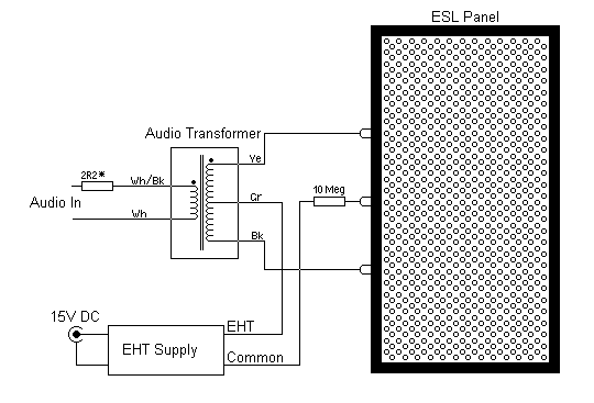

Thanks, I have a toroidal 220v--->6v (Chile have 220v at 50Hz). My transformer have 2 in and 2 out ??? What is the mode of conection, for ex. http://sound.westhost.com/p105-f4.gif 3 point out, my toroidal transformer have a 2 out. What is the mode of conection to EHT and Stantors.
U have diagram of conection ???

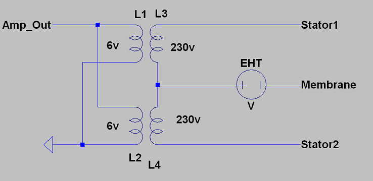

I think it should look like this.
You need two transformers for each panel. Note : between EHT "-" and "membrane" there must be ~20 Megaohm resistor.

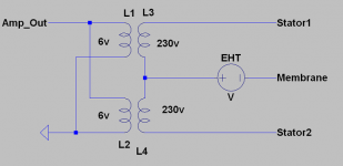

I have bought a pair of 80W 220:12V trannies. They start to saturate at input voltage of 13V at 50 Hz. I think that slightly higher crossover point may be better(i am thinking about 250-300Hz , if i split 12V secs into 2x6V) , because it would keep the core saturation lower.
