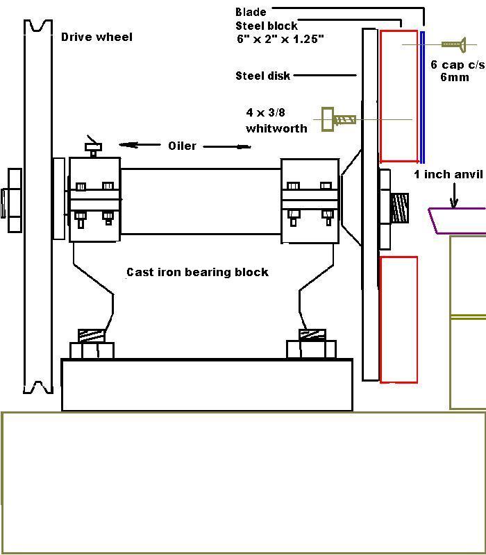

We decided to build a mulcher. It had to use an electric motor because I had one. It had to be strong and sturdy and it had to be cheap. And it had to work.
I experimented with two small hatchets attached to a rotating spindle. Apart from the very dangerous aspect it was completely useless. Just bounced off the thicker prunings.
The next plan was more realistic. I happened to have in my garage an old shearing shed comb sharpening device which consisted of two steel plates about 18 inches in diameter 1/4 inch thick bolted onto a 1.5 inch shaft fitted on two plain bearings. One thread was right hand and the other was left hand. In normal operation this machine was bolted to the shearing shed wall near the shearers and driven by an electric motor. The steel plates had some kind of sandpaper glued on. The idea being that shearers who were paid by the number of sheep shorn could sharpen their shearing handpieces very quickly with almost no down time.
The cast iron base holding the shaft was about 24 inch long weighed a 100 pounds or so and was all rusted and seized.
After soaking in kerosine for a few days it freed up. I took it apart cleaned and checked the bearing play and the end play. It was quite good. Almost no bearing play, small amount of end play which was taken up with some large washers.
After making a wooden tray with two wheels, the casting was bolted in place and a blade made from a used motor mower blade.
Initial trials were very dissapointing.
The speed was too high causing the contraption to rock back and forth in a dangerous manner.
The blade hit a moderately thick pruning and the nut simply unwound.
Using a large dia wooden wheel we got a large speed reduction down to about 200 rpm
Now it was starting to cut the prunings but we needed an anvil for the blade to cut against. Did this with a length of steel plate slightly ground so as to have an undercut.
The anvil made a big difference but still not satisfactory. It needed a lot more weight at the blade.
Fitted two heavy steel blocks. One under the blade, one opposite to balance and it works very very well.

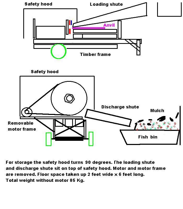

We have a downwards inclined shute longer than your arms. Load the prunings onto the shute, push them down with a wooden pusher or other prunings and they are cut into 1 inch long segments.
It is very fast. It cuts as fast as you can load the shute and throws the mulched bits into a bin. It can reduce a heap of prunings as big as a car to shredded mulched parts about the size of a wheel barrow in couple of hours. And the motor (3/4 hp electric motor) doesn't even get hot.
Safety. Initially everything was exposed and dangerous but have fitted 3/4 inch exterior plywood covers over the belt, shaft and cutting blade and now its very difficult to get close to anything dangerous.
If I was doing this again the frame would be steel. Even 3 lengths of 4 x 4 solid dry timber bolted together bends under the cutting pressure so I cannot get the blade and anvil as close as I would like. Presently it has 1/16 inch clearance. I would like it closer but 1/16 inch does work very well
I would have two or three times the weight on the blade. Its the rotating weight powering the cutting blade that does the work not the electric motor. That just spins it up to speed between cuts.
The threaded shaft securing the disk and blade is an excellent safety measure. Occasionally bits of hard prunings over 1 inch diameter get put in and the blade stops, the nut unwinds and no power is transmitted. No damage.
Total cost of manufacture $20 for a pnematic tyre. Everything else I had.
Time to build about 6 weeks. Couple of hours a day.
