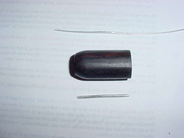

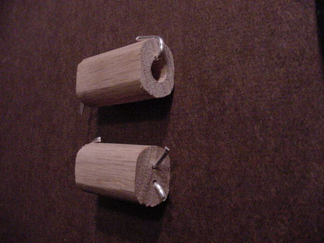

I made a set of these today using scrap oak and .9999 silver wire. They came out really nice ( way better than they look in the pictures) but I havn't had a chance to hear them yet. It took about 20 mins to make the two of them. I will do them over again real pretty now that I see they work.

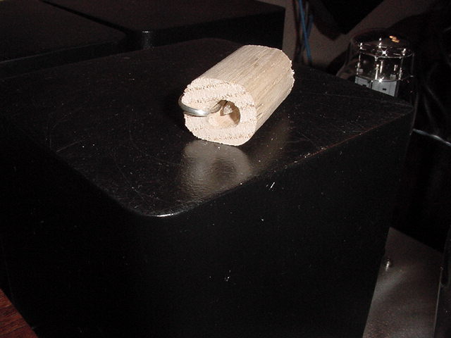

I was not aware of the 47 labs connector.
Now that I've seen it, I will try to copy that.
peter
The center pin is just a silver wire, bent at the back to keep it snug and bent slightly at the front to make contact at only one point.
I will also try to remove some of the contact area on the return wire to resemble the eichman a little closer.
I'm really kicking myself for not doing this earlier.

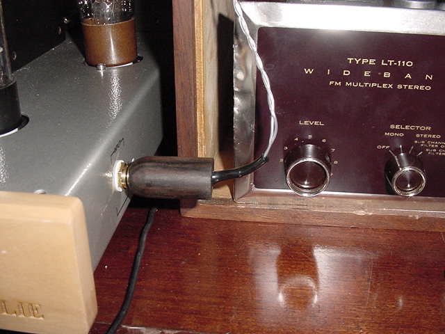

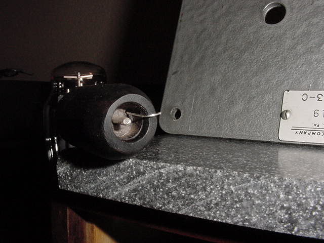

Version 2.0
It's like a hybrid between the 47 labs and the Eichmann. I am working on doing away with the center pin but I'm not quite there yet. It sounds really nice. At first listen a layer of glare on the letters S, F, and T has been removed. Doing one at a time and listening made me want to do the other one right away.

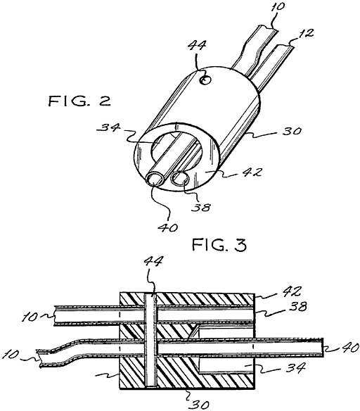

You might find some more inspiration from the following patent
<a href="http://164.195.100.11/netacgi/nph-Parser?Sect1=PTO2&Sect2=HITOFF&p=1&u=/netahtml/search-bool.html&r=25&f=G&l=50&co1=AND&d=ptxt&s1=tubular&s2=cogan&OS=tubular+AND+cogan&RS=tubular+AND+cogan">United States Patent 4,954,095
Cogan September 4, 1990
Cable employing tubular conductors </a>
Thin copper tubing is available here <a href="http://www.ksmetals.com/Cuttolength/default.asp">K&S ENGINEERING: 6917 West 59th Street Chicago, Illinois</a>
Regards
James

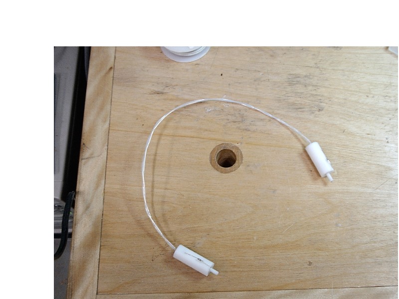

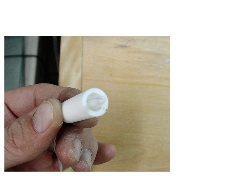

I ordered a few materials from McMaster-Carr and built this little number today when the material came in. I just couldn't wait until I got back to show them. I only know that they work but not how well yet. These are solid virgin teflon connectors made from 1/2" rod drilled out 5/16" and 1/8" rod pin the wire is 24AWG solid silver wire with a teflon jacket. The 1ft in length. Sonic reports to follow in a couple weeks. On problem noted so far: teflon is slippery! :clown: Next possible set will have some kind of grips machined in them so they are easier to get off the back of the unit.
