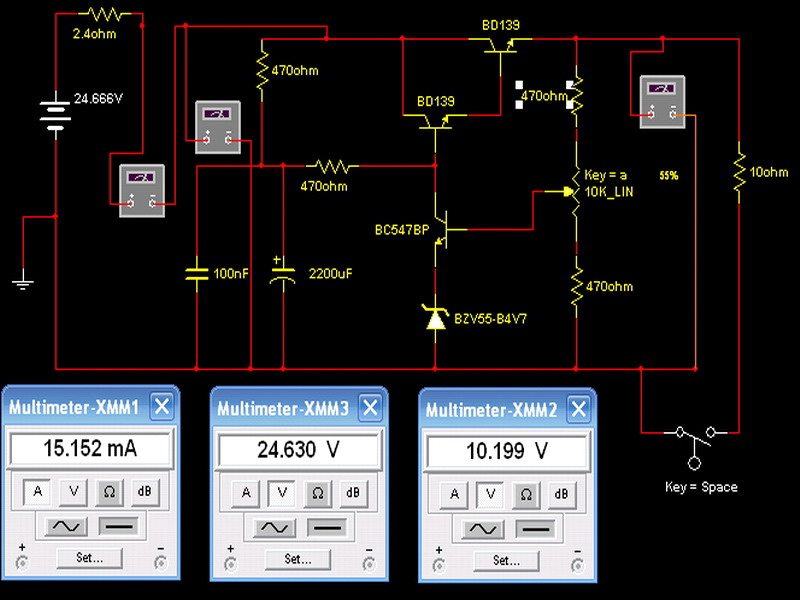

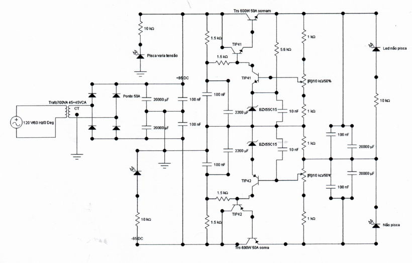

There are also lot's of other ideas. Elektor had long time ago a PS which used two transformers and the main thing was a current generator as reference. I have built it but the schematics are available, some help me? The article was published in the mid 80's.
The idea of Elektors have I seen in commercial lab PS and it's pretty good.
This one is beeing used last 35 years, and modified
Are also beeing used by 22 local Radio Amateurs.
The HAM use 20 amperes and 13.8 volts, and this must be hardly stabilized, as current jumps from 1 ampére to 20 amperes in a flash time!..... following the audio signal, when using suppressed carrier transmissions.
Of course the input voltage and many resistors are different to receive 24 Volts DC in its input.
This one works fine.

Yes...of course bigger transistors in parallell
Here is some image of the simulation.
One without load and the other with load.
Of course the transistors must hold the VBE voltage the maximum needed current and adequated dissipations...so.... they need ot be changed when you change your need.
Also resistors and zener need to be adjusted...also the electrolitic condensers need to be adjusted to the needed working voltage.
But this you already know.
regards...and be happy!
Carlos
As you can see friends, this is only a low current and low voltage supply
But works as an example.... adapting values, it will work with bigger voltages too, and i normally use them.....never had problems...voltage stable under 5 percent normally.
Sometimes i can have better regulation.
I will stop to feed this thread, as we have correct place to that....answered here just to be kind with the one opened the thread...but i am finishing my cooperation here, not to broke, too much, our forum rules of organization.
regards,
Carlos

Yes Christer...i had removed the protective capacitors, the output loaded
And many counter oscilation things.
This schematic shown is the basic from the most basic things.
Fast to introduce into the simulator, small to publish, easy to understand.
The ones interested, can go deeper.
Related oscilations...well.... 35 years running in many homes, and connected to oscilator friendly equipments (radio frequency transmiters)...it was hardly tested.
regards guys...LM317 is fine...also 78XX series and many others.... long life to the electronics hobby!....nice thing.
