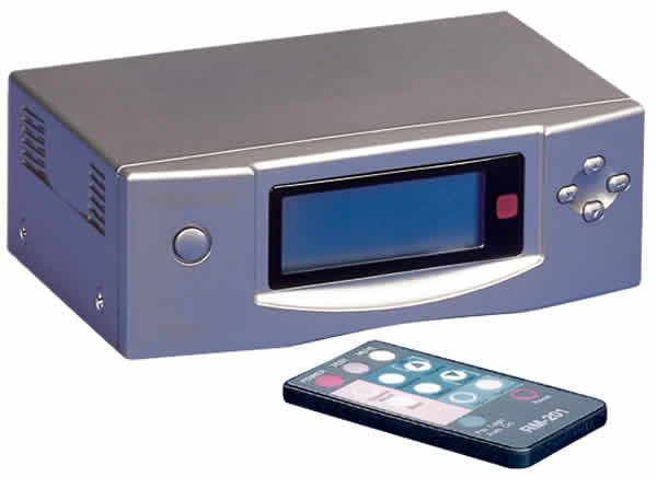

Thinking similar thoughts and googling my brains out I found a handful of these things and posted this in an earlier thread:
I think this decoder costs less than $100 US. Ive been thinking about this or one of a few similar devices marketed for desktop computing as the decoder for a similar project.
http://www.videologic.com/Products/...roduct=VL-60510

It would be interesting to see what kind of performance could be achieved with such a device if the incumbent A/D and D/A were bypassed and something a little more esoteric inserted.
I would also avoid the use of digital attenuation and gain, especially on a cheap core like this. Perhaps the DIPCHIP electronics guys could be persuaded to emulate some control code in order to bundle it with there relay based attenuator or digital crossover projects.
