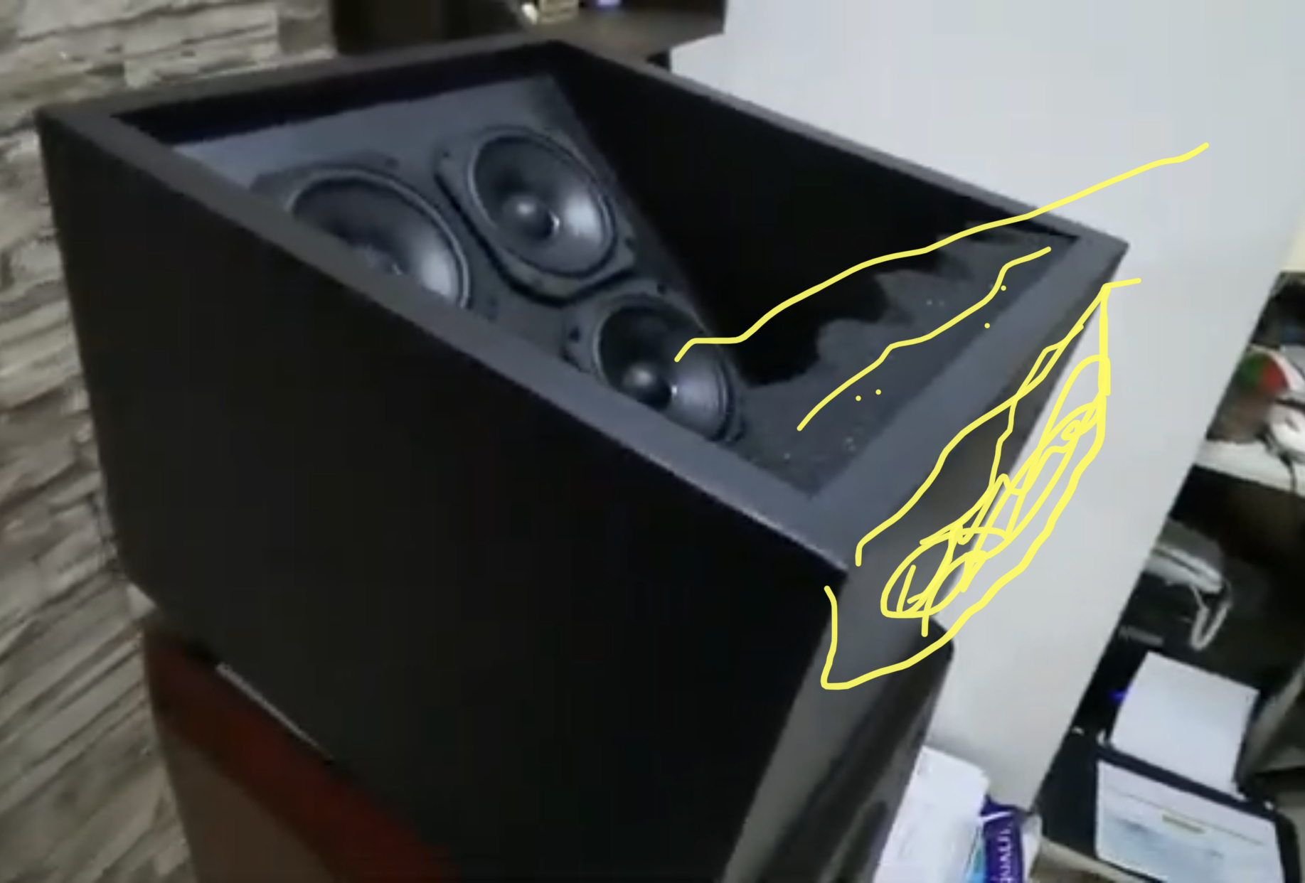

One question, to you think that the front wood plate is maybe blocking some of the sound from your diy atmos speakers ?
Look at my crude yellow lines showing where I believe it’s blocking sound
Yes, I think its blocking a portion of the sound from the lower driver. I am thinking of buildng another box with 40 degree angle and deeper depth so that the lower drivers won't get blocked.
