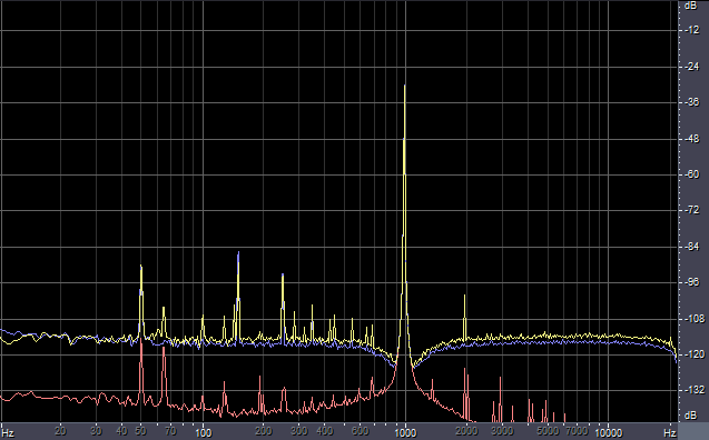

Improving on the test equipment described in a previous thread, I have constructed some circuitry dedicated to distortion measurements. It consists of one bandpass filter to purify a sine wave and then one notch filter to magnify the relative amplitude of distortion components.
Tests suggest that it can measure distortion down lower than -120dB. Much of the time that's lost below the noise floor. It's fixed at 1kHz only, but that's usually enough to get a good idea of how well a circuit performs.
You can read details on this page on my website.
Attached are some FFT results from the test equipment itself (red), an OPA134 (blue) and an OPA604 (yellow). Since the 1kHz fundamental is attenuated by 30dB by the notch filter, the magnitude of harmonics etc can be read directly off the scale. Note that the OPA604 is rubbish. You can also see a lot of noise picked up below 1kHz. I'm still working on trying to reduce that, although it doesn't affect this particular type of measurement.

Both are active. I tried a passive RLC bandpass filter at first, but the distortion was significant. The required inductor size was too large for air-core, so I had to go active.
Still, the performance is very good, as you can see. I used an OPA227, which is a new one to me. It's quite possibly the best op-amp I've seen in terms of THD+noise.
Your results look nice.
I built wien-bridge oscillator from op37 with classical bulb stabilation. Best i could do was something 0.0007% distortion with OLD aureal wortex2. Needed quite heavy aweraging as this was at least 10db below noise floor. i couldnt find bulb that is specified in linear appnote anywhere but after trying couple of choices and fiddling around with component values i could reach that 0.0007%
I abandoned that project because at this low level of distortion oscillator took half an hour to stabilize and if i knocked pcb even lightly it went unstable. And sometimes it didnt start to oscillate, little knock on tin case and it started. Next life I am going to try LDR in feedback.
OPA604 is bad
My own measurements suggest that even OPA134 and OPA2134 have quite high THD, especially at supply voltages below +/-8V. The 0.0008% claimed in the datasheet will only stand at the most optimal conditions. At normal line level the real value is more like 0.01% from 20 - 20.000 Hz.
I recommend OPA627 which has ultra low THD under almost any circumstances, making it the best choice for building THD measurement filters.
