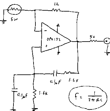

Jim Williams oscillator
Wow, I had forgotten all about the Williams version of the HP200 (wien using a lamp). So I quickly built one myself just to see. Yup - 0.01% distortion (as far down as my HP 333A goes) right off the bat. No extra filtering, just a one opamp oscillator.
I used a common 5W nightlight bulb we had on hand. They're quite easy to solder to. See schematic below for a 1kHz frequency. Adapt as you need, but this is one quick and easy project.
Now 0.01% may not be low enough for some of you high-feedback fans, but for my zero-feedback tube amplifiers, it's adequate. I measured my new "Cornet" phono preamp with this oscillator (padded down to 5mV) and got a total 1kHz distortion level of 0.02%. Not bad! 🙂
