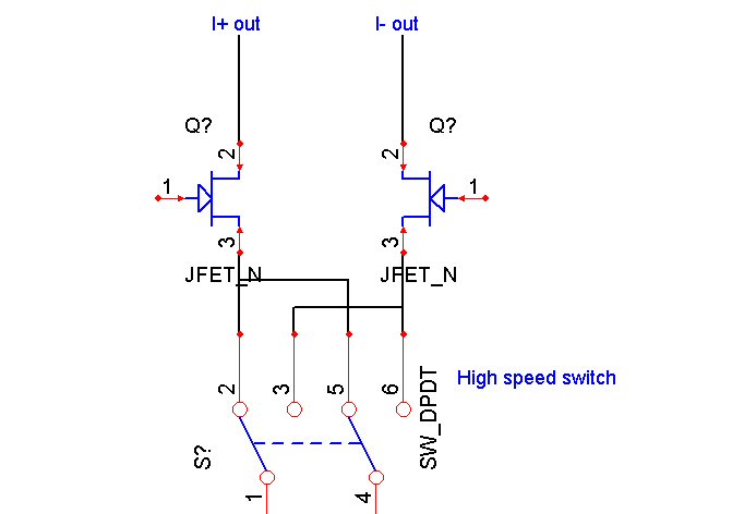

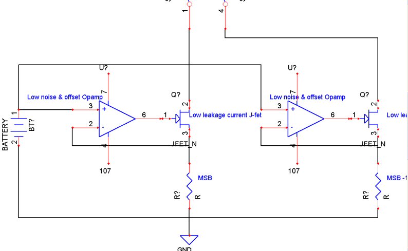

My idea was to make a current switched DAC.
Basically it consist of 16current sources, the values should be proportional to the value of the bit.
I think a current source can be made with at precision needed to accomplish at least 16 bit of resolution.
A two poled switch should then route the current fitting the input value out of the dac.
I think temperature drift is a major problem, if a high true resolution should be reached. The constant current solution will have a very stable temperature since the current in the resistors, actually deciding the precision, is constant.
Oven controlled operation(temperature controle), can be used for the most critical DIY’ers.

What do you think about the current switch DAC ?
Should i draw some schematic in order to make it easier to understand ?
The DAC should be calibrated, no matter which conversion method is used.
The calibration can maybe be done automaticly, by using voltage controlled resistors, but i think this is aiming to high.

Yes we should only concentrate on getting the short term relative levels correct.
but i think the very critical parts like the resistor network will be easier to controle if the temperature is constant.
Kuei Yang Wang said:
In that case I would suggest that in the simple DAC shown the channel resistances of the individual outputs may be sufficiently large and sufficiently varied between individual outputs and devices to cause issues, plus PSU contamination will easily feed through into the audio signal.
I would suggest to add analogue switches with guranteed limits on variations of "on" resistance and a super well filtered and very low impedance (Op-Amp buffered, RC filtered reference?) low noise reference voltage which is switched by the Analogue switches onto the R2R network.
Sayonara
Yes this some of the most critical elements in the R2R converter.
In the Current switch'ed(or weighted current sources) dac, the variations on the on resistanse isn't that important because the correvt current will be delivered, no matter wich serie resistance is added. To a certian limit of coarse.
Bernhard said:No wonder that the performance of this DIY dac was bad, the guy used 5% resistors 😀
I didn't notice that, must be a realy heavy distorted low level perfomance this dac offers.
