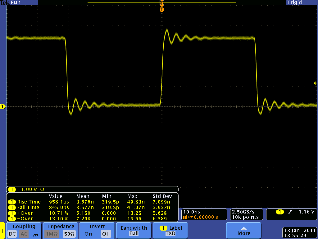

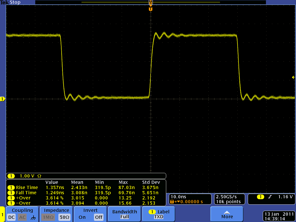

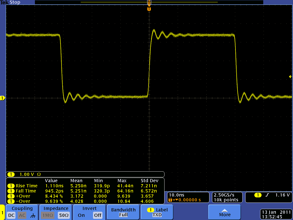

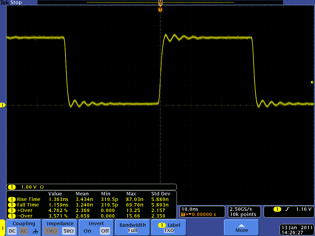

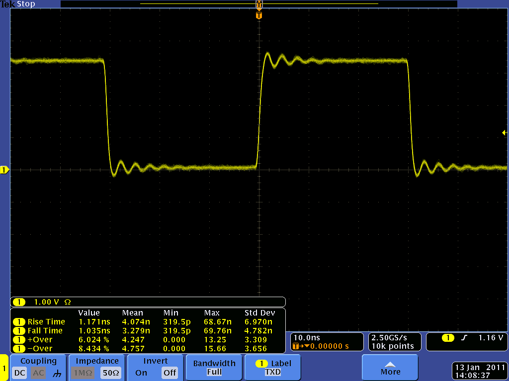

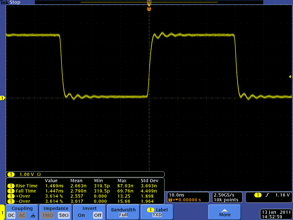

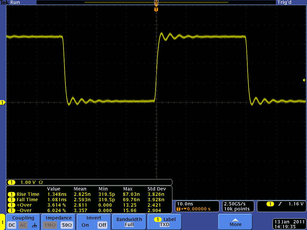

Without simulating the transmission line or performing actual measurements you can only guess (or us standard practice) values for the series resistors....
Here are some real world measurements of the effect of various series resistors on a signal, in this case the driver output drive current was too strong for the short line so had to be tamed by the series resistor to reduce the reflections caused by this high drive capability. The series resistors (placed as close to the driver output as possible) reduce the current drive, slow the rise time reducing the harmonic content of the wave and reducing the overshoot and ripple.
The original cap was a 22R used because that is what is usually used.
