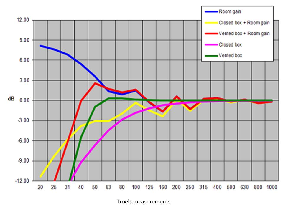

Hey
whatever design / speaker you pick i suggest that you make sure there is a gentle bass roll of starting at 150Hz. Your speaker placement will result in a hefty increase of bass (corner) and reflection fr8m the desk top increases frequncy response around 150 Hz.
If the design has a rear fireing port you can try lengthening the br port and placing it on the side or top of the cabinet.

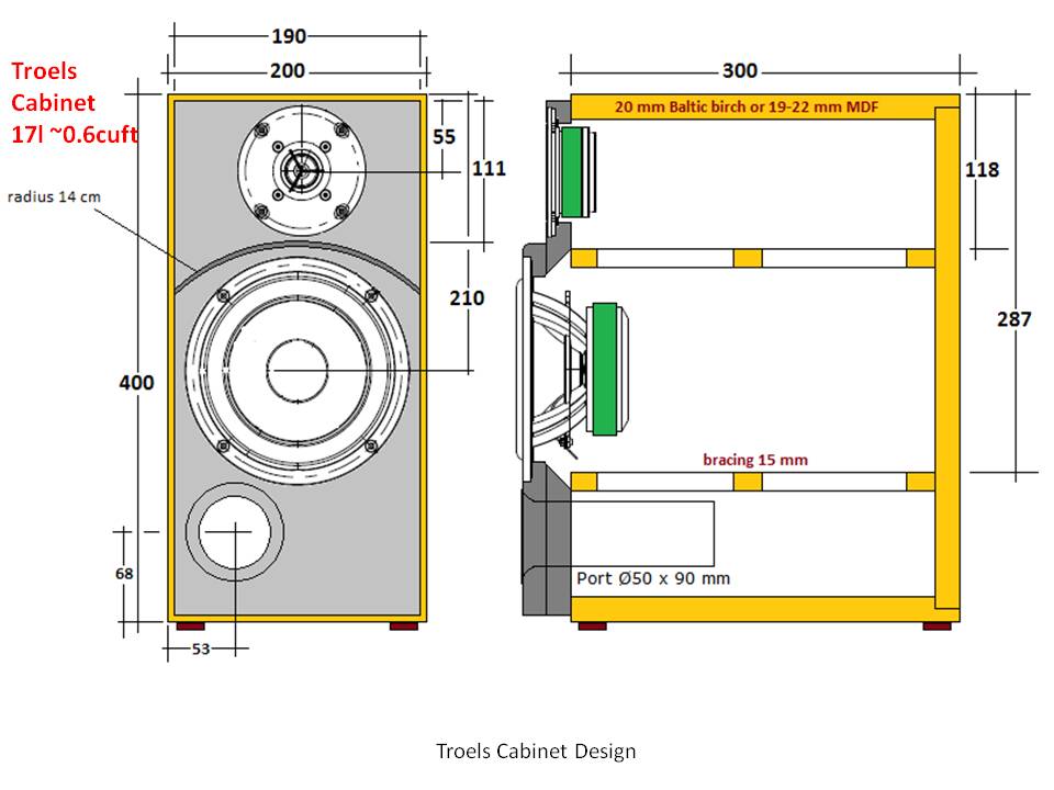

FIRST LEVEL: What woodshop tools and talent do you have?
SECOND LEVEL: Decide upon 2-way vs. 3-way, AND largest acceptable box size.
Your budget will allow you to build a 2-way with "premium" drivers and crossover parts, or a 3-way with "high value" drivers+crossover.

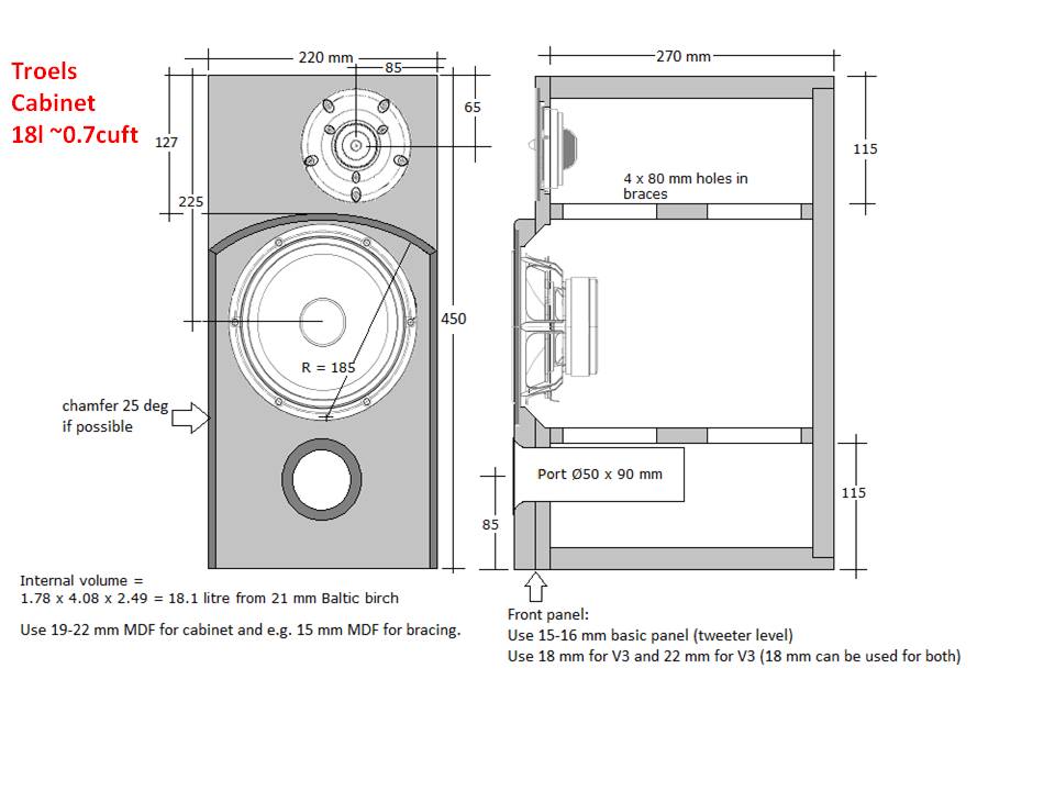

Look over the 2-way box size(W200xH400xD300) used by Troels. (1" dome + 6" midbass)
SBAcoustics-61-NRXC

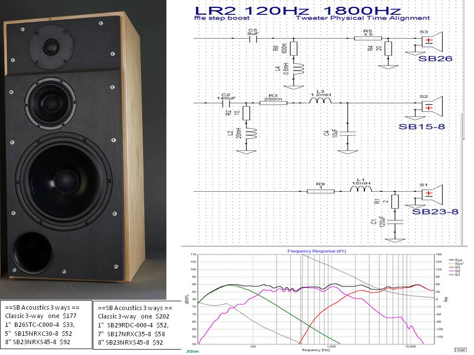

Look over the 3-way box size(W280xH600xD340) used by Troels. (1" dome) & (4" or 5" midrange) & (ported 8" woofer)
Using SB_Acoustics drivers will meet your budget.
SBAcoustics-3WC
SEAS-3-Way-Classic-mkII
For greater 3-way dynamics, you can use a 6" midrange.
For more powerful 3-way bass you can use two 8" woofers in side-side low-vibration cabinets.
SBAcoustics-61-NRXC

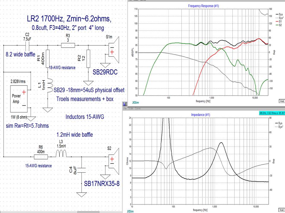

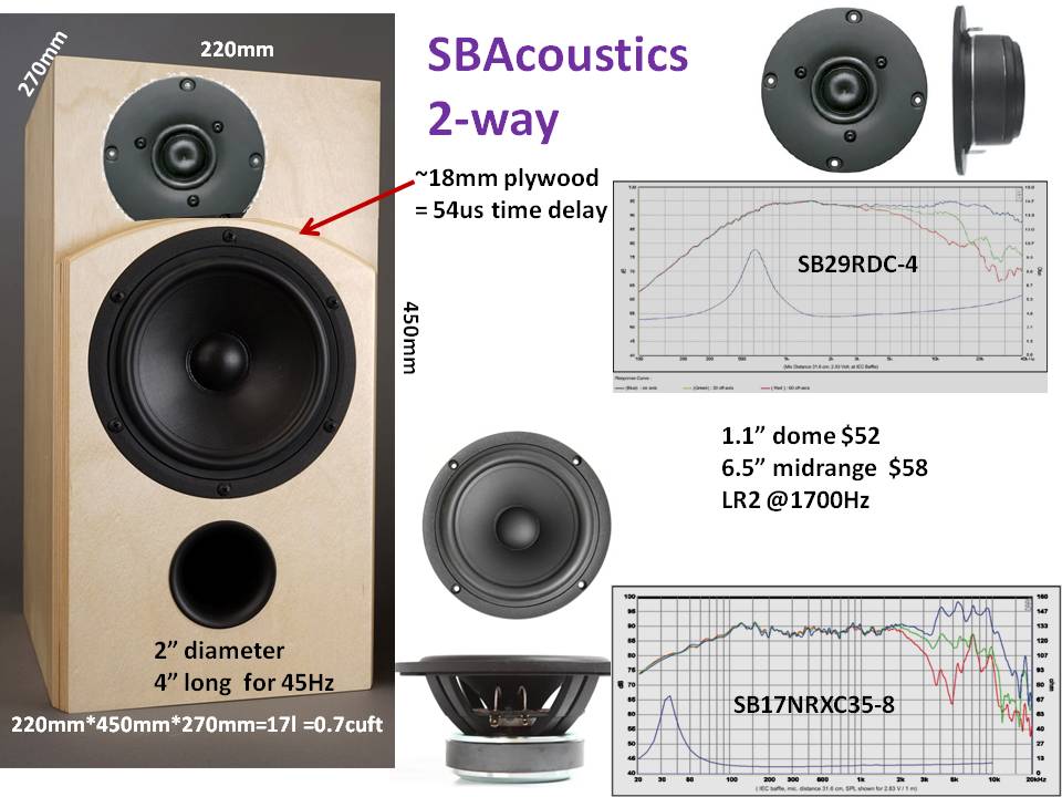

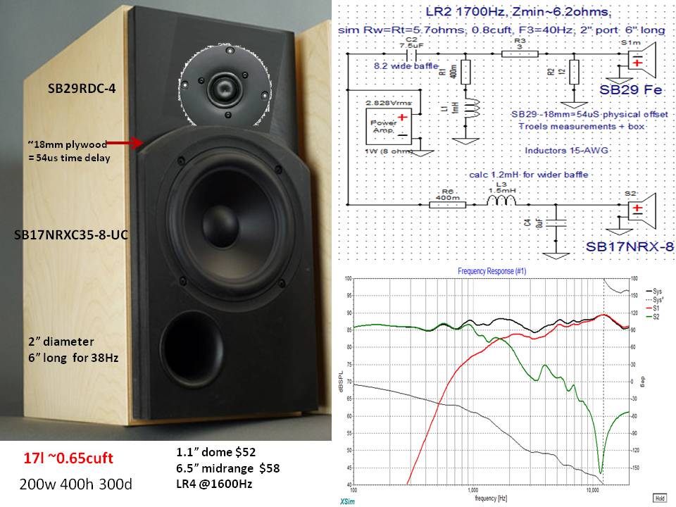

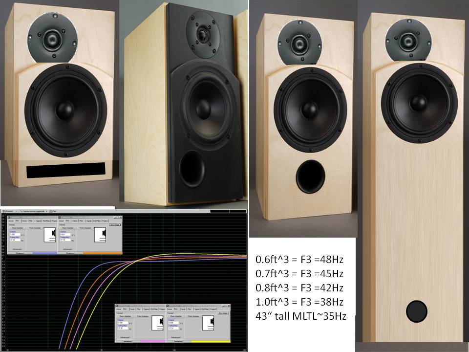

For your goals, a 2-way speaker using a 6" midbass in a ported cabinet is a good first design to consider. A 17liter - 18liter box can generate good bass, and you can build smaller boxes with less bass extension if necessary. Room gain from near wall, and near floor/desktop placement can increase bass SPL. Troels website has detailed cabinet construction information. It is common to use perforated hardboard (peg board) to mount the passive components, and common to solder the connections. There are screw-down connectors (cylinder with screw) which can also be used, and electrical twist-connectors are another option.
A web search for the SB_Acoustics SB17NRXC35-8 midbass and SB29RDC-4 tweeter will produce several alternative designs you can compare.
