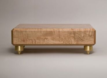

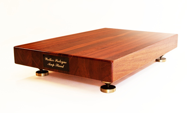

Another way to personalize the electronics would be to make a nice wooden platform for the amp/receiver to sit on, using a nicely finished piece of local hardwood. Add your own signature and a date by carving it in. It may sound trivial but I think these are the touches that make a difference and if you size it large enough it can still serve use if the electronics are updated in some years later.
