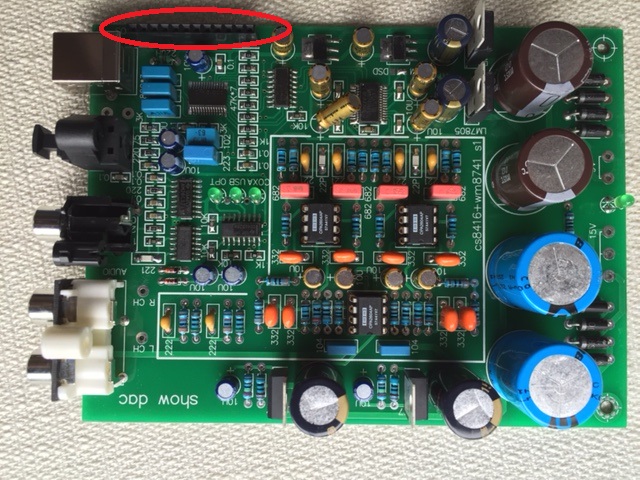

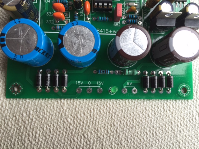

I am pretty new to diy electronics. Recently bought a DAC board from ebay. Obviously I didnt think it through to buy the power supply transformer. It requires a 15v-0-15v and 0-9v transformer. Found one on ebay (115V 230V 30W High Quality Audio R Core Transformer 15V 15V 9V 9V for Preamp | eBay). I have a lot of questions and I am sure you guys could be of great help here.
1. Not sure about the wiring aspects. which wire from this transformer goes where ?
2. Any idea what exactly is that ( circled in red ) on pic 1613 it says XMOS.
3. Is it worth using an enclosure ? I was planning to, but as I look at the board, the LEDs are all built into the board. If i were to do an enclosure, I want the LED indicators on the front pannel ( for eg. coax, usb, toslink etc ).

Thanks. Attached is the pic of the transformer. After reading further I think I need to do the following combination
15v-0-15v : YEL - YEL+BRWN - YEL
9v : BLUE - BLUE
Then keep the WHITE away.
Any idea how and which wire to ground ? is that the BLACK ?
Thanks for the help in advance

yellow /green is ground : connect to earth on mains recepticle
Black and green are AC, if your country is 115v mains supply , Black and red if your country is 230v.

15-0-15 should be Y- Y+B -B . Test with multimeter connected to single Y AND SINGLE B you should read 30v if you get 0v change the Y and B that are connected together.
Follow Groundloops suggested reading to get safe understanding of what you are doing : always very wise when playing with mains voltages.
I would put the board and transformer in a box.
You would need to remove the LEDs and solder two wires to a LED on a panel, you can buy chassis mounting LEDs.
The plastic resin has a small flat to indicate polarity so you should wire them the same way, otherwise if the LEDS does not light up, just swap the wires round - there is 50/50 change of wiring it up correctly by guessing, and you won't damage LED if you got it wrong the first time.

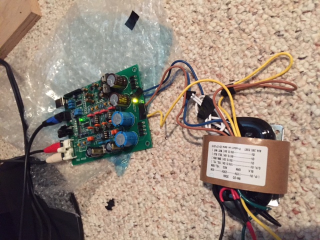

Success !!!
Update : Received the transformer and temporarily hooked up everything. Played some CDs. Connection was like this, DVD Player toslink -> DAC toslink input, RCA output from DAC to my amplifier. I really liked details of the output. Some key observations, bass is low and volume dropped significantly. Is the volume drop normal ? What should i expect after the burning in period ? Thoughts and suggestions appreciated.
