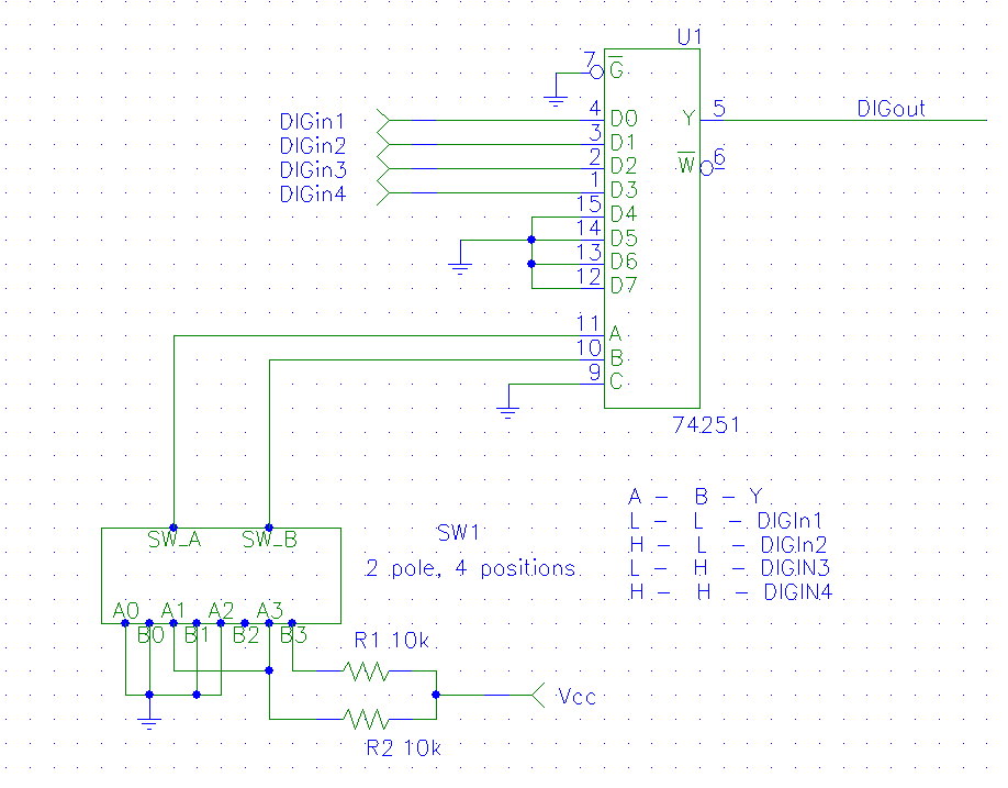

I've also been experimenting with the rotary switch. As you can see in the attachment I "borrowed" the rotary switch from a four-to-one switchbox.
It works fine, but I noticed a (half expected) side-effect of the use of a rotary switch. These switches have gaps in between the positions where the contacts are not connected to anything. While turning (slowly), this leads to a short period where A and B on the multiplexer are undefined, i.e. neither connected to GND, nor to Vcc. In practice this leads to A and B becoming high enough for the 74LS251, that I used instead of the 74HCT251, to be interpreted as a logic 1 and thus selecting the source on input 4 (A=1, B=1 -> Y=D3). If your DAC, like my Micromega DAC1, locks very quickly to the incoming source, you will shortly hear input 4 until the switch clicks into the next position.
How "bad" this gets may depend on the switch used. A switch with a wide gap between the contacts will be worse than one with a narrow gap.

I spent the better part of a day trying to come up with a simple solution to prevent the "annoyance" I mentioned a few posts ago. But after a while I decided on living with it. It's going to be more complicated than I thought and I realised that it needs more space than I have left on the board, and I'm not going to add another one.

No, while experimenting with delay circuits I found out that the switch does not have gaps, as I thought, but it actually has overlaps. It's the overlapping that's undesirable.
I use a laboratory power supply for the breadboard circuit which has the possibility to limit the current to anywhere between 0 A and max output. A red LED indicates when the set current limit has been reached.
I noticed the red LED on the PSU flashing while I was switching between the sources. From that moment on I knew the rotary switch shortly overlaps between the positions. The overlaps between positions that are wired for high (Vcc) and those that are wired for low (GND) create a short circuit! This should be avoided at all costs as it leads to a drop in Vcc that affects all circuits.
It's not a problem if you use the 10k resistor between Vcc and the rotary switch as in post #16. It simply limits the current to an acceptably low level in the overlaps (if I hadn't removed it, I would not have noticed the overlaps at all!). With the switch I'm using right now that resitor is not optional but mandatory. The 10k resistor will limit the effects of the overlap to the annoyance.
I'm thinking that a switch with gaps - if it exists - will present similar problems, but those might be solved by a simple delay circuit. As I don't have that kind of switch, I can't experiment. I'm not planning to either. The 4-to-1 switchbox has been unused for years so I will mod it to take the S/PDIF switch and, of course, make use its rotary switch (keeping things on a budget). The board should just fit in.
In post #21 I wrote that in the undefined position A and B go high and hence Y=D3. Thinking back, that was wrong.
I just experimented some more and it turned out that what seemed to be a gap at first and an overlap later on is actually a short to GND. I think that was done deliberately to prevent pops, this switch is meant for analogue sources.
With all four inputs receiving music, if I turn slowly, between every position the first input will be heard. If the positions were overlapping, that would not be possible. E.g. turning the switch from pos. 3 (LH) to pos 4 (HH) has one pole that stays high in both cases. An overlap would not cause that one to go low, and yet I hear the source on pos. 1. That MUST mean that the contacts of the switch travel over GND pulling A and B low -> selecting input 1 (D0).
Measurement with DMM on the switch revelealed this to be the case indeed.
Good chance that another switch will not do this... Maybe an overlapping switch (WITH 10k resistor between Vcc and switch) is a good solution after all - if they exist.

Just disassembled the switch-box to have a closer look at the rotary switch. My first and last ideas of a gap and short to GND were wrong. It actually has overlaps between positions.
So why hearing input 1 in every overlap? As I wrote, that should not be possible between certain positions. But I just realised that it is possible because of how I wired the poles of the switch.
Look at the schematic in post #16 and you'll see that I wired all poles that need to be low together to GND and the same thing for the other poles to Vcc, behind the 10k current limiting resistor.
The implication is that any transition from L to H or vice versa will lead to all "high" wired poles becoming momentarily low and thus selecting input 1, until the switch clicks in the position.
The solution to get rid of the "annoyance" is elegantly simple: do not wire all "high" positions together, but keep a separation between the poles, giving them two 10k resistors. When one positive pole is pulled down in the overlap, the other one will stay as it was (i.e. if there is no transition in that one).
The end result is that the overlap will go unnoticed. No more input 1 popping up!
Or so I thought at first. Look closely at the transitions, and you'll see that going from pos 2 to pos 3 the overlap will pull both poles down shortly as both poles undergo a transition (and thus input one will pop up in the overlap). The others should be fine though.
So, now I'm going to think about a solution to get rid of this too.

And here it is. I shifted the wiring on the switch so that no more than one pole goes from low to high (or vice versa) at a time. To achieve that I swapped the "coding" of the rotary switch between the last two positions (3 and 4).
To compensate for this I just swapped inputs 3 and 4 (D2 and D3) on the multiplexer. This way the outputs on the outside of the S/PDIF switch stay in chronological order without rewiring of the RCA connectors (in my case, as inputs 3 and 4 are coaxial).

I just made the changes to my board to see if my reasoning was correct...and it was! Every switch between inputs is a clean one.
