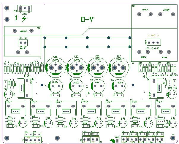

hi all,
this is the new power supply jmep image of the PCB.
improve stefanobilliani advise,
the ground loop was improve more, relayout all the ground area in the [power supply area. I use 96db speaker full range & 94 db ( TAD speaker) & test low noise. The original also no problem in normal speaker. Only high efficiency will little noise.
1. New layout of the power supply.
2. increase the capacitance of the caps before the diode from 3300uf >>>>4300uf+0.1ufMKP ( 3300+1000+0.1MKP). or if diyers still like to increase more. (3300+2200+0.1ufMKP)
I was so sorry that if I use too large capacitors te sound will little lower. or I will advise paralell two 470uf on the 3300uf & 1000uf caps. ( use BC philips & test good)
I use ,my friend with 2X15inch woofer & horn(2'throats to test)& alnico tweeter for more dynamic sound & noise, over 97db.
If the capacitor was too large, the sound will little slow. So if U heard classis & more dynamic music will not so good.
3. All the isolated power transformers was mould into the pcb. approx no cable seen into the dac.
thx
thomas

Hello Thomas and all ,

Since LM regulators are themselves ICs and needs to be away from ground loops aswell, it is nice to place them where they are needed , pratically close to the DAC , Receiver, Digital Filter etc.
I think that way it is more easy to control the returning pahts .

Thomas,
In your quest to reduce noise and improve power supply, I would like to inform you that Walt Jung has made important researches on regulators. He found that the 78XX, 79XX, three terminal regulators are not adequate for audio work.
You are right in using the adjustable type LM317, LM337. According to Jung they are better, but may be, you would like to read the interesting articles he contributed to the audio community.
You will find it here: http://waltjung.org/Regs.html
