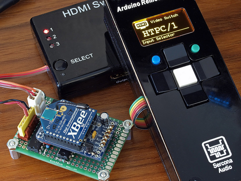

new functionality: both (actually, even 3 or more) units stay in sync.
volume can be changed from either side; the unit or the remote. if you go to one, the other needs to stay updated, and now it does. both units can GET as well as SET values.
its responsive, too. I'll try to shoot a demo video to show it in motion. turning the rotary encoder has the led display updating at its natural rate (which is instantaneous, essentially) and the remote oled display, while many times slower, does not seem to interfere. I've structured the code so that the display update is unhooked from the incoming serial command and reply stream. incoming data is always processed and so the unit (remote) always knows the current value, but the display might skip some middle values so that it keeps up. while the values are being changed, you do see the bargraph move and it keeps up nicely with the rotary, so the overall feel is acceptable.

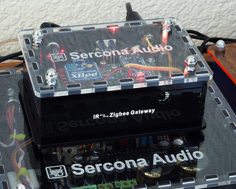

there is a 3rd player, not shown, that also works. the IR to xbee gateway is another talker/listener and if you use a sony dvd (example) remote and program the gateway to send out xbee messages on the up/down sony ir messages, the preamp vol control engine does update, its display updates and the oled remote updates 😉 its a pretty cool demo, having 3 controllers and as long as you only send commands from one of them at a time, things are fine and everyone stays in sync.
a webserver (serial to xbee) adapter is next on my to-do list and it should play along just like the others, plus giving the phone and tablet guys their chance to play 😉

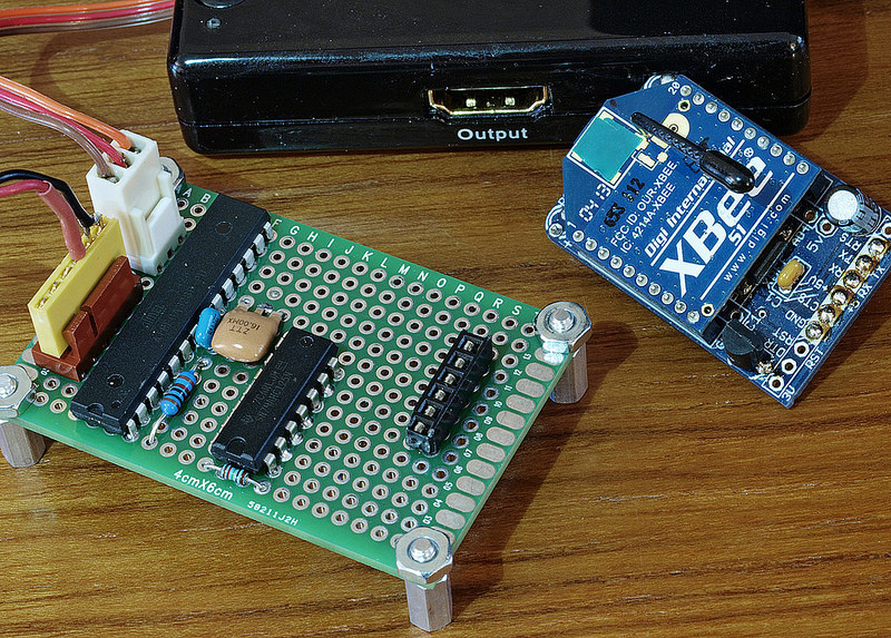

more progress toward the large solution.

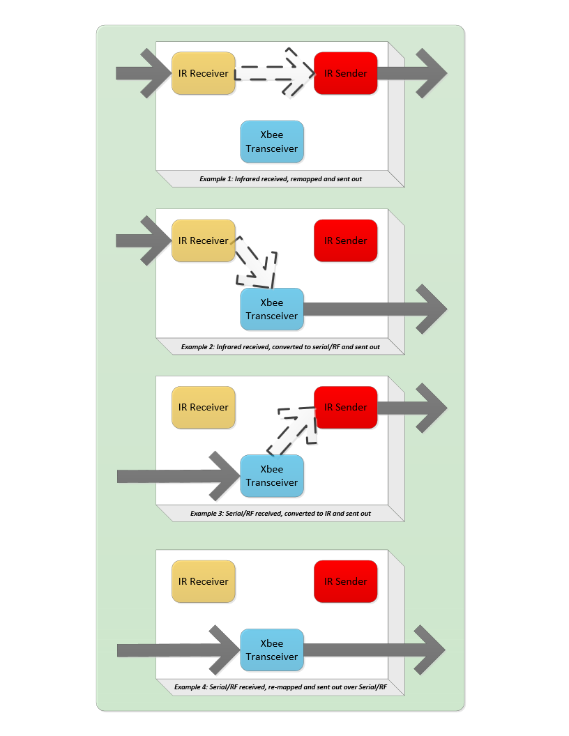

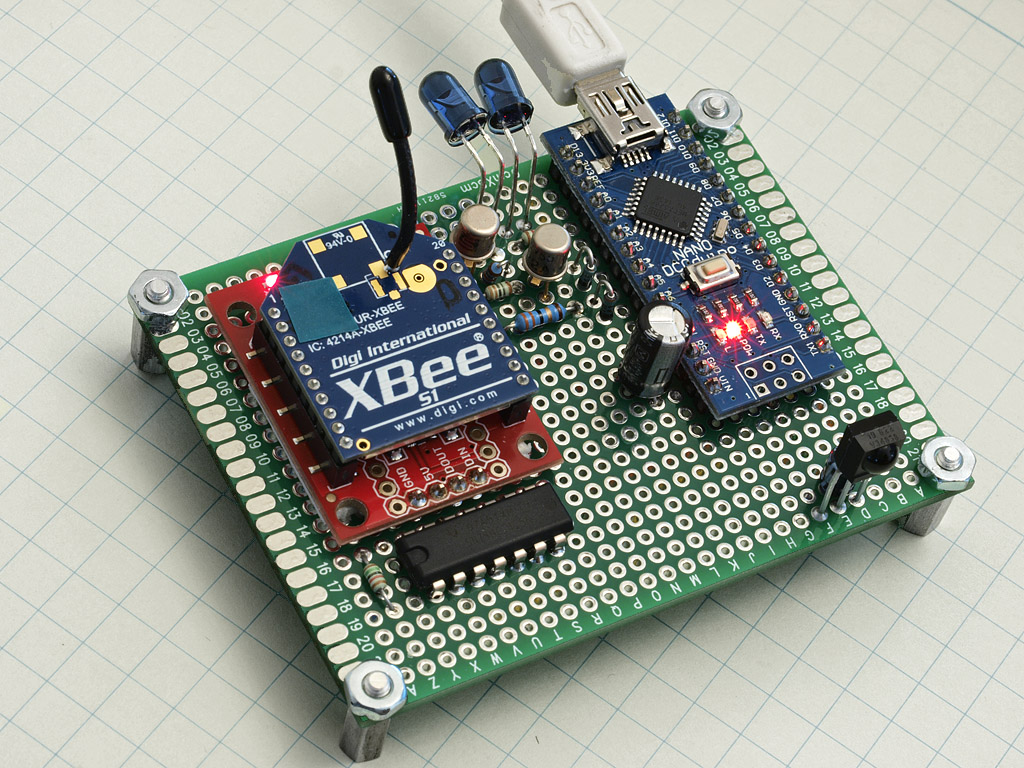

first, a document showing how IR and RF can both be used, as inputs and outputs, to control a miriad of devices. then, a proto board that implements that idea.
the first thing I used it for was to capture 2 IR codes; one from one remote and onefrom another - and store it inside this board. then, create a 'cross connect' so that when code-1 comes in over IR receiver, code-2 is sent out on the IR transmitter. I was able to have my sony dvd remote (that I like a lot) control my vizio tv. I only needed 1 button to be emulated (the on/off button, lol) and this does that job nicely. it saved me having to use a universal remote; in fact, this board acts like a universal remote of sorts.
the next thing I did with this was to convert other IR codes (on that same sony remote control) to xbee serial/ascii messages - that I listen for in my other DIY audio boxes. instead of having to use a custom remote, I can use any old ir handheld and still be able to (send only) commands to xbee-controlled systems.
I also plan to support xbee remotes (or, later on, webservers that have xbee on them) as sources and IR as destinations; so that 'dumb cd players' (or set top boxes) that only speak IR can be controlled with a fancy rf-based remote.
and lastly, if you need to translate ir to ir or xbee to xbee (to remap data or to talk to an older firmware box) that is also possible.

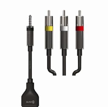

today, I added a new one that some may find interesting. I bought a DAP a few months ago (fiio x3-2) which is a really nice high-def audio player; has bit-perfect spdif/coax out at 192/24, has a nice cs4398 dac inside and even supports dsd (a dsd file is converted to pcm if sent out of the spdif-out port). it has line-out and phones-out, too.
anyway, it has an inline-remote feature, like a play/pause/skip control on a phone headset. except this player does not use resistor programming for the button functions, it uses clicks on the 4th (trrs) band! well, ok, I can handle that 😉 the arduino now can watch for IR or xbee incoming commands (unused keys on my IR remote) and if a << or >> is pressed, the circuit sends out the right number of clicks on the 4th band to gnd. 1 click is play/pause, 2 clicks (120ms apart) is for skip-forward and 3 clicks is skip-backard a song. no seeking (that I found yet) but at least it has play/pause and skipping of songs.
I added a small 8pin ssr to the board and that's enough to 'click' the inline remote and have it do the right thing. LAA110 claire chip is a leftover from a previous project and it works just great, here.
the zune cable (lol!) is the thing to get; it has the TRRS 1/8" connector and 3 rca's; the usual left and right audio but the 3rd is a video-out (for zune) and I'm using it as the clicker. short center to gnd on that yellow plug and the inline remote commands are acted on by the player.
cable is $10 or less (not bad quality, either). this is the one I got:
http://www.amazon.com/gp/product/B000IXLHOM
so, for those who might have a system that might benefit from remote control but uses the so-called inline remote protocol, this gateway circuit might be useful for you.

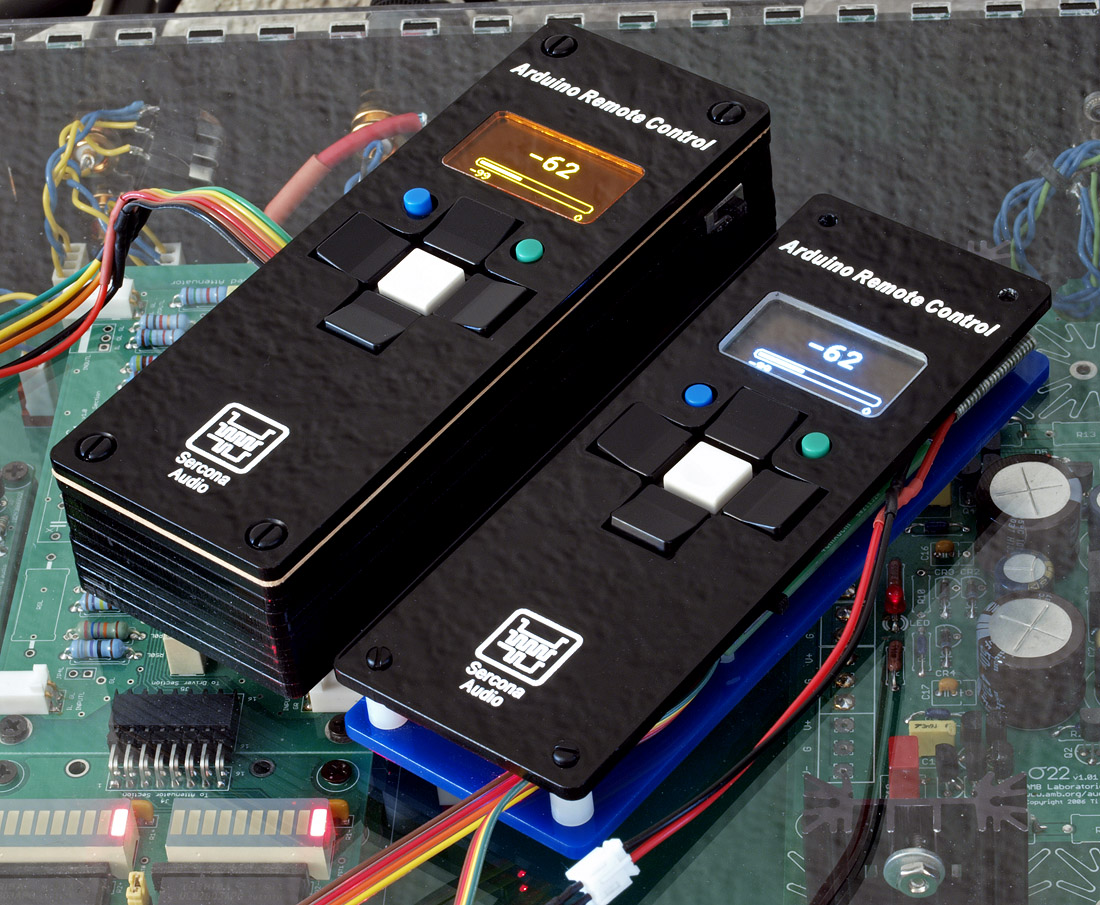

today, I put the little guy on a diet 😉
changed the battery to be a smaller one (still Qi charged, though). moved a bunch of things inside and learned from the first version.
1.25" on the old one (thickness) down to 0.6" on the new.
if I can come up with a good idea for the middle part (lol) this could be a usable chassis. maybe a layer of semi-stiff rubber that extends a bit beyond the plastic edges. would provide some protection against drops and bangs, plus a grip.
would love to have a wooden shell and then just add the plastic top and bottom to it.
anyway, the diet worked and the 'thick as a brick' look is dead 😉

The new slimmer remote looks better. A nice wood case with inset faces would be neat. That's a great idea.

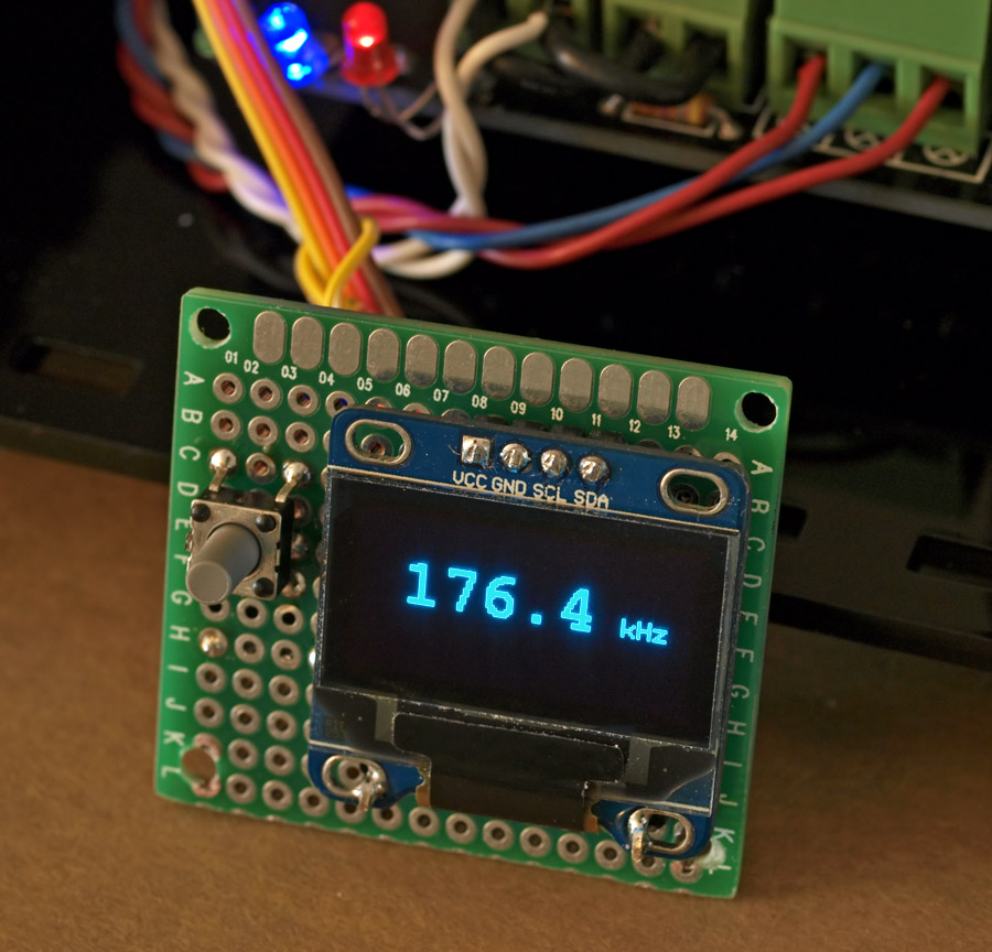

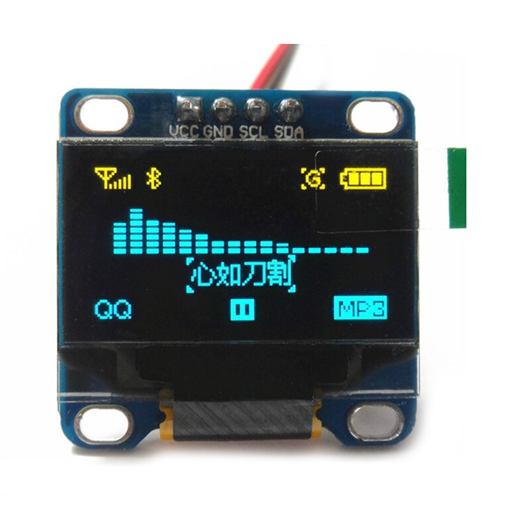

the small oled display is very popular with 'makers' right now. its a $10 part and can be found by search for 'oled 128x64 1.3"'. the i2c version is 4 wires but slow (not very fast for animation or motion, even page displays have visible redraw effect). the spi version is much faster and when the arduino uses its hardware spi, its 2x or even 4x faster and screen draws are nearly instant.
but remember, one down-side to this oled stuff is that it has limited run-time. that gives me pause, to some degree, since the rated lifetime is about 1-2 years of constant on-time. for a clock display, that would be bad. for a display that is 'on demand' and not always on, it could work. screen savers/blanking is also needed.
then again, for a DIY its fine. if you socket the display, then just buy spares and replace when the brightness starts to fade.
mounting that display is not easy, though. its not designed to be panel mounted and the mounting holes are not really useful (too close to the glass edges). what works for me is to solder the top pins to the board and to solder some wire to the 2 bottom holes that are solder-coated. that will secure the unit to a pcb below and THAT board can be chassis mounted or just be the main board, itself.
on a non-diy, I would probably make the display a board of its own with a connector and that way you can swap out the display without unsoldering, later on. stock the boards and displays as built-up modules and at least you have a solution that does not overly **** over the customers (remains to be seen, though).
I just really like the form factor of this display, how (mostly) simple it is to use, with the u8glib library and how there is no ghosting or contrast or side-view issues like old style lcd's. you have a few fonts sizes you can pick from and you can do limited 1-bit bitmaps for gfx, as well as discrete shape/line drawing.

here's the method I'm using.
you can see how I soldered to the bottom eyelets. that seems to hold it in place well and its still un-doable if you need to remove it.
a friend had made some 3d printed plastic nibs that would fit into pcb holes below and are wide enough to hold the bottom eyelets. you then just melt the plastic like a rivet to lock the display in place. may not last and is not fix-friendly but its another idea on how to mount this.
also, be aware that these are supposed to run at 3.3v but some do run at 5. when at 5v, you may even see screen flicker. if so, run at less than 5 (4 is fine).
for the u8glib, you may have to do a trial and error to find the one C constructor that works for the module you bought. there are tons of clones and they vary. that's annoying, to be sure. if you plan to build many things with this module, you may want to buy them in bulk to make sure all your parts are the same. buying a new lot from someone, even the same seller, may not get you the same exact part again! a friend does buy directly from heltec and that can save your sanity.
finally, they do make a dual color one but its lame. one group of lines of pixels at the top is yellow and the rest below is blue. I guess its good for a battery or antenna display like this, but seems too specific to be useful.
