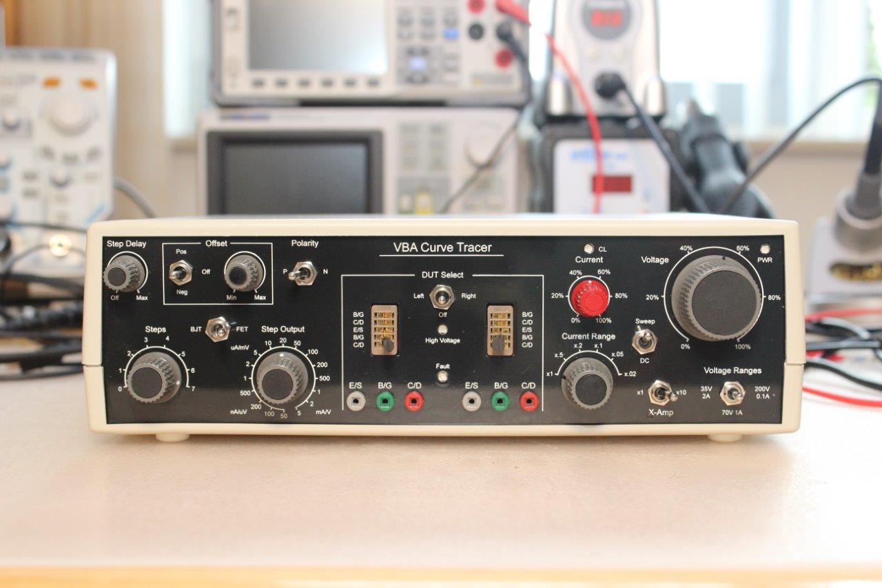

We have a small team that is building a DIY Curve Tracer. Not a Tek577, but a lot better than anything we found that comes close. We are close to the final stages and have a fully operating CT that I'm making measurements with.
If you're interested, have look on my blog. Eventually everything will be shared but we'll wait until we have finished the project.

1Audio, we have an external Z-Axis (blanking output) option for analog scopes. We don't think we need it since we changed the way we sweep the triangle with the steps. Have a look at one of the screenshots to see how close a DSO (which is much less forgiving) now comes to an analog scope display.

You can put two DUT's in the adapter and switch between them, just like any other good CT can do. Is that what you mean?
Otherwise, have a look at the prototype Front Panel to have a look at the DUT connections we will provide. Right now we use a ZIF socket (see first pic on the Blog) that later can be put on a little PCB and connect to the CT through 2mm banana plugs to provide an assortment of sockets and adapters.

Reading through your notes on the project it occurred to me that you have a lot of similarity to the 7CT1N curve tracer plugin. Its power limited etc. and does not rely on the mains power for any timing, instead running at 110 Hz with a triangle wave.
Creating a curve tracer capable of power is a major task and I'm interested in your project even though I have a 7CT1N.

Well Jan, it's no surprise that this design resembles the 5/7CT1N. I built one myself many years ago and even added a read-out functionality to it. That post is also on my blog.
I started building a new one after I sold all my Tek gear to a collector and I missed the 5CT1.

We have finished the design of the Curve Tracer and published all files required to build an instrument yourself.
Here is the link to the description: https://www.paulvdiyblogs.net/2022/06/the-vba-curve-tracer.html
And here is the Github repository: https://github.com/paulvee/VBA-Curve-Tracer
