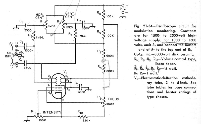

You mean an amplifier with a CRT display ?
Like this one.

Hey Ketje, thank you this is a great document. I am trying to make a similar tool actually, but without the amplifier. I am willing to make a normal ossiloscope that can be used with props...
I think on your document, the bottom part is the CRT and its power supply. I am trying to make this bottom part from scratch providing correct voltages to the CRT...

Is 3cm not a little small ? It's intended for monitoring as in the circuit I posted.The B4S2 used there has an assymetric deflection system, one plate at constant level,the other the signal.
There are also CRT with symetrical deflection, both plates the same signal but opposite phase.The data you showed doen't specify witch one it is.

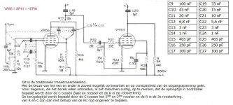

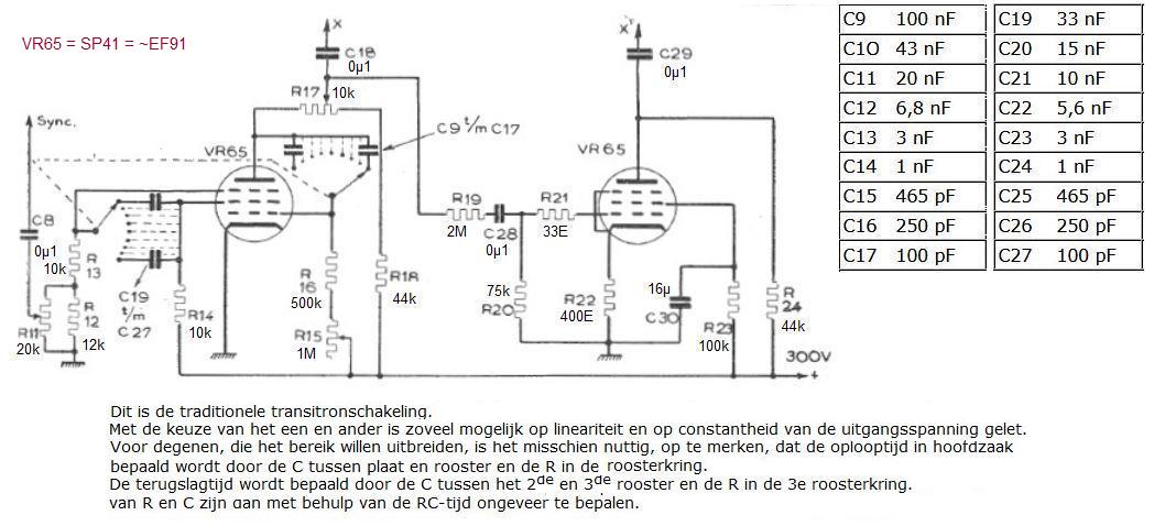

Here the horizontal deflection oscillator + phase inverter if needed.
It is the so called transitron circuit.
The explanation is in dutch, hope you can decyfer.
