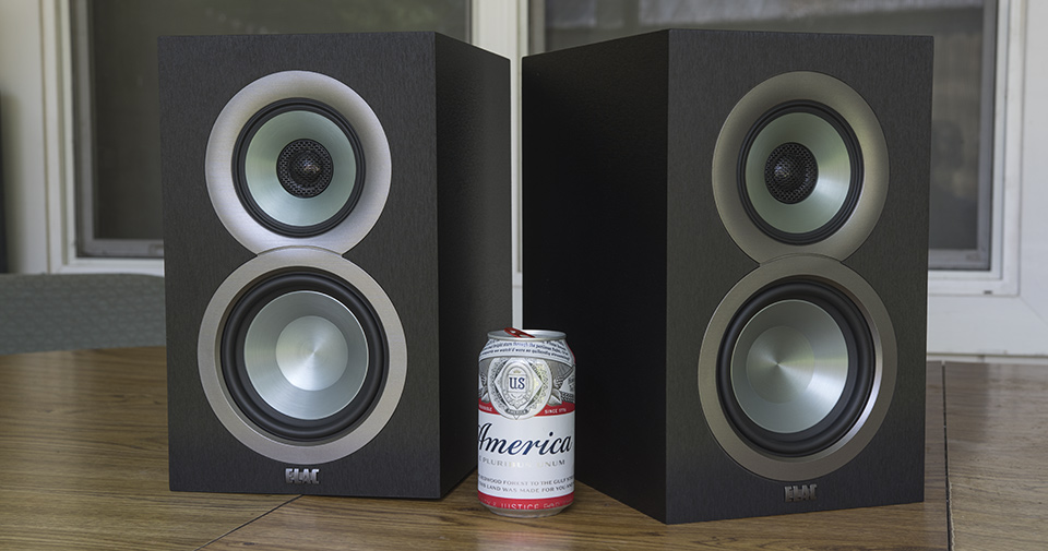

This is the ELAC UB5, featuring a concentrically mounted soft dome tweeter

Based on the discussion that I had with him, it turns out that I've had it backwards all these years. I've long noted that soft dome tweeters perform exceptionally on waveguides and horns, but I'd always assumed that it was because only the 'tip' of the dome is moving above 10khz. It turns out that's backwards; it's actually the part near the tweeter surround that is moving at ultra-high-frequency.
So... THAT'S why titanium, aluminum and beryllium dome tweeters 'mask off' the tip of the dome. Due to their rigid structure, they don't 'decouple' above 10khz, and due to that, the apex of the dome must be masked off
This also explains why the ELAC design, with it's soft dome, does not use a phase plug. While the KEF design, with an aluminum dome, uses a fairly complex phase plug.
