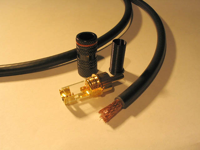

hello again,
done with the cables now and the results are here.
the analog does sound better than coaxial! more detail and more air around instruments for sure.
i made 2 cables to choose which one is better
cable 1, pic here
cable 2, pic here
the first one is Monarch's (japan) Oxygen-free copper, Neoprene with Neutrik RCA's, and second is Gotham's GAC-1 with Tasker Profi RCA's.
it's not easy to hear difference between them, but i kinda think that the first one sound little better : )
thank you all for your replies and suggestions!
ronald

coax
hello again 😉
these cables what i made are microphone cables.
but now i wanna try coax cable (for analog).
here in estonia i cant get Belden 89259 etc cables so i must find something else (as good as this belden 🙂 )
i found something here:
SPECS and PIC HERE
RG59B/U 75 Ω, halogen-free
Capacitance: 55 pF/m
Sheath: Black fluoride polymer
Dielectric: Cell-FEP, Æ3.7 mm
seems good, or what?
any comments? seems like pretty good capacitance and not some PVC **** sheath.
only, how about copper-plated steel?
greets, ron

jleaman said:mrz where did you get the end's. ?
Neutrik's are from local ELFA dealer
http://www.elfa.se/elfa-bin/dyndok.pl?dok=7476.htm
the Tasker ones are from same dealer.
greets, ron
