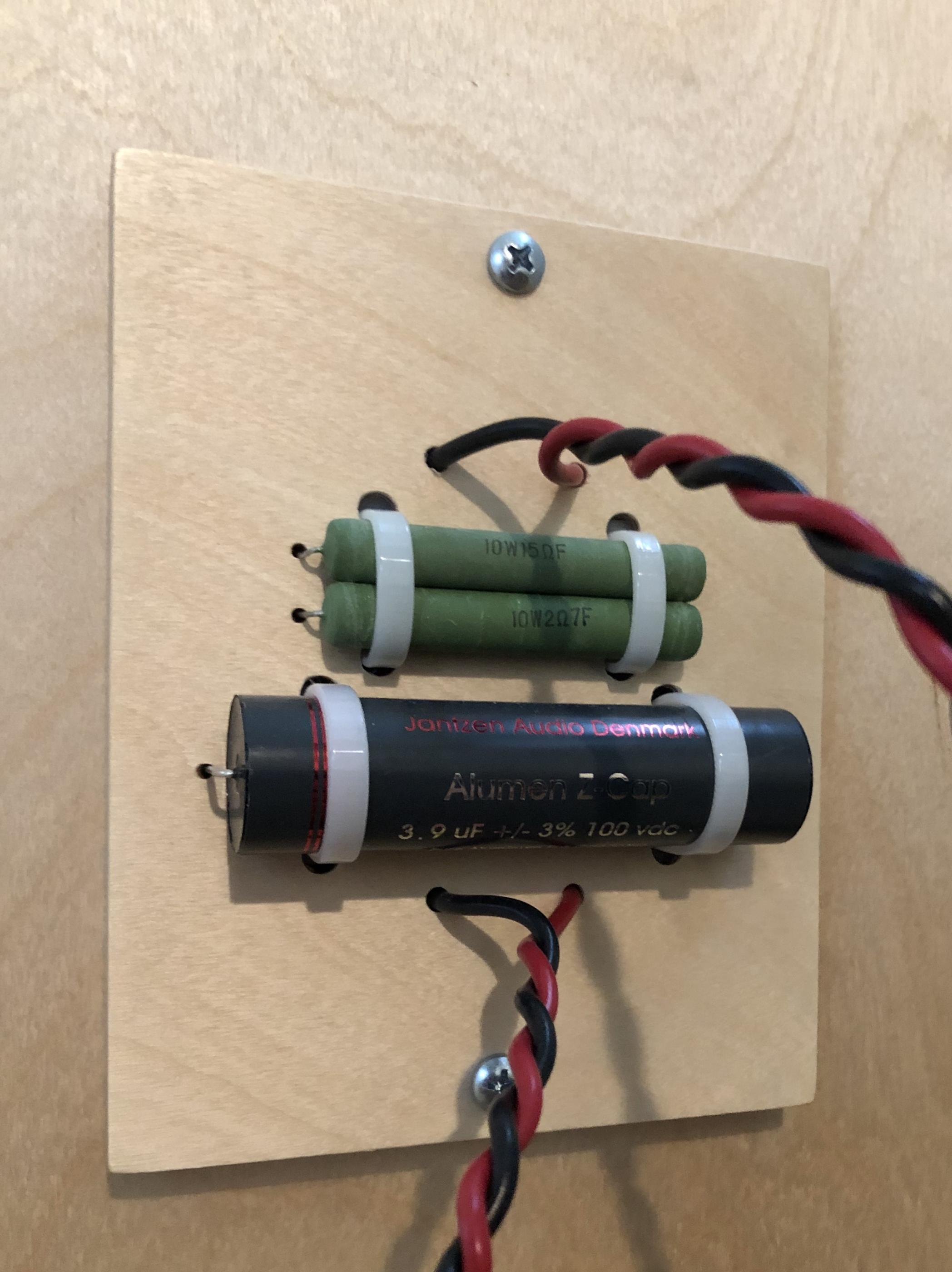

Did we mention this amazing clone of a DeVore Orangutan o/96?
That's it, crossover wise... 3.9uF and 2.7R plus 15R attenuator on the Morel Cat 378 tweeter. 😀
Well done, dualuxe!
