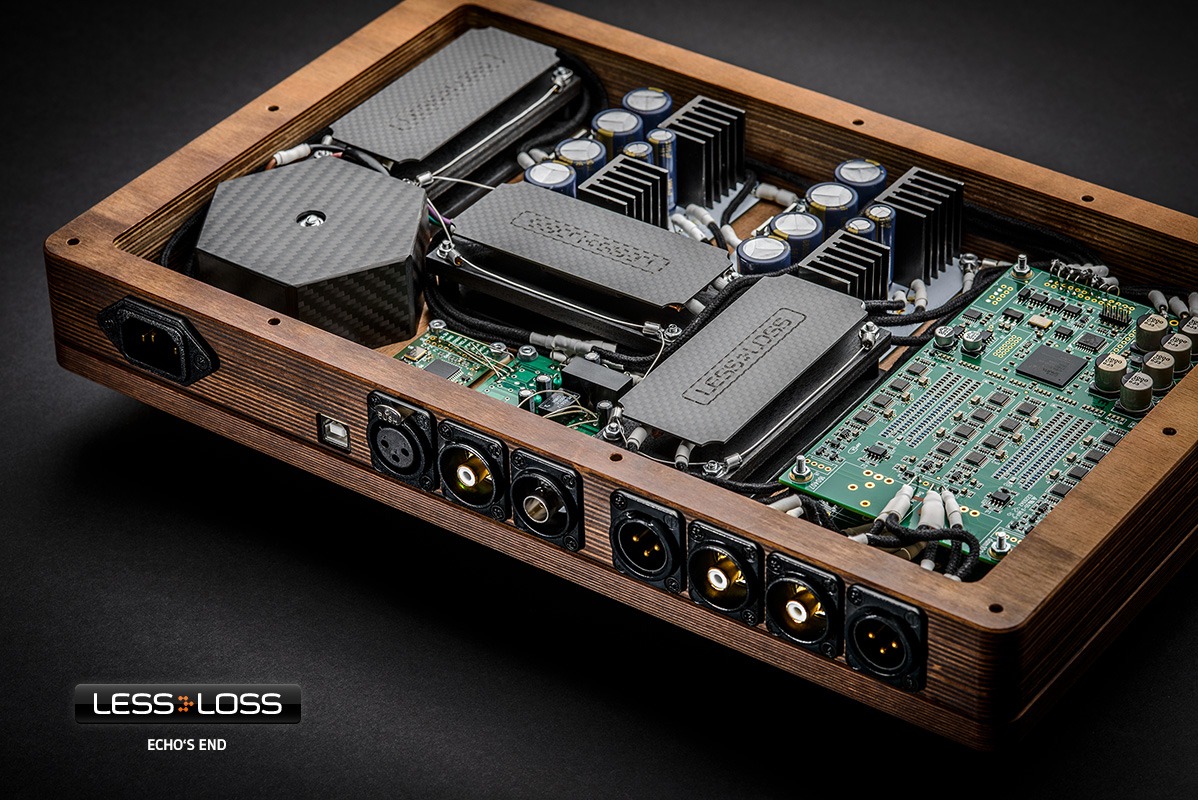

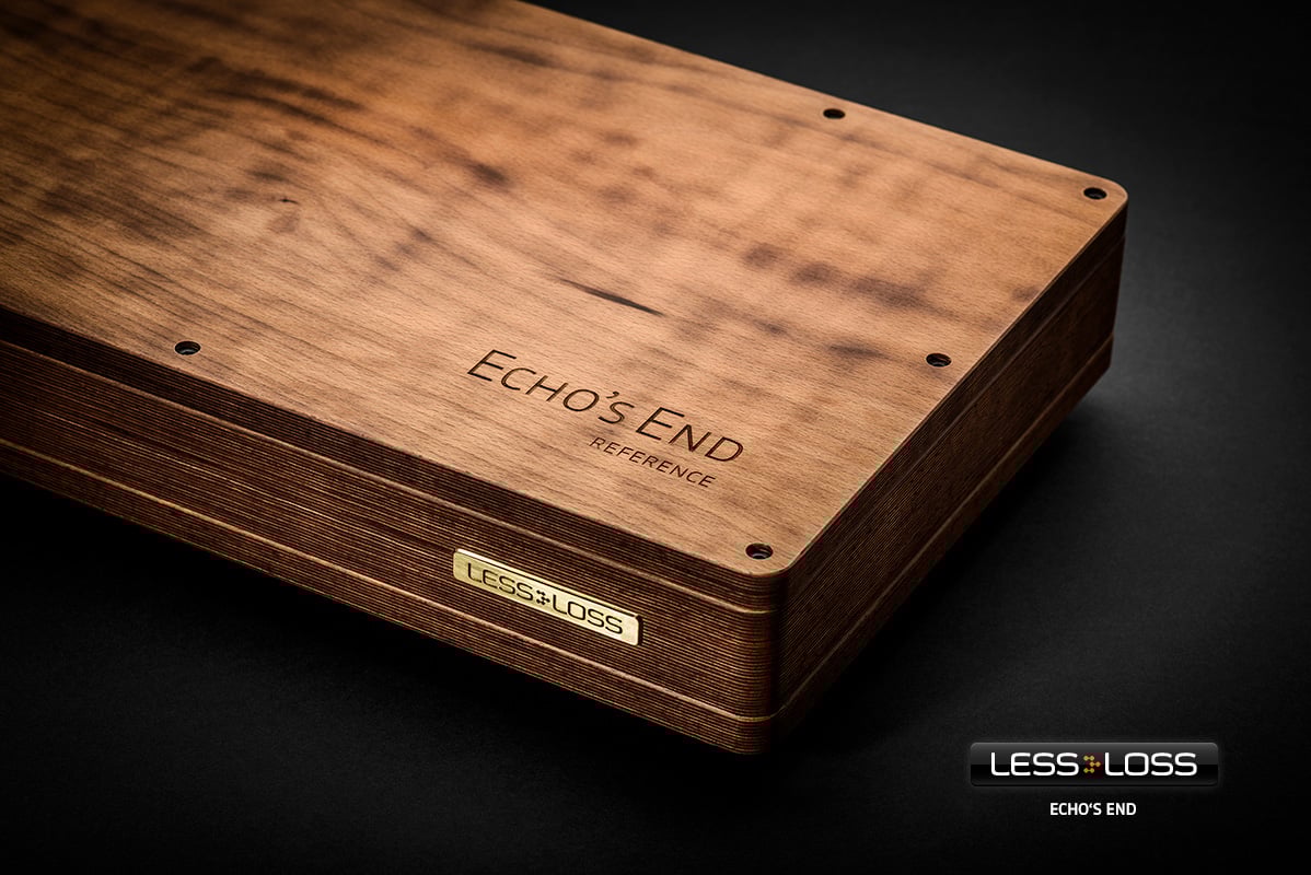

Diy chassis out of wood, what is needed to make it work?
I have some nice extra wood for Lampucera dac chassis, but this is not "usual" thing to do so asking can it work?
-If i use Aluminium foil tape for sides inside, it should work right?
-Should i make "double layer" of copper tape over aluminium?
One use case from lessloss
  • LessLoss-EchosEnd-_FON3744-8bit-1000px.jpg.bed7ee53575bcb58f3188d940619697c.jpg

  • LessLoss-EchosEnd-_FON3891-1000px.jpg.00c6a0e3d51dc44b3a70d513f46f9325.jpg

Copper foil would be easier to work with as you can solder on it , GND.

Old vintage equipment was made in wooden enclosures .

Copper foil is mostly effective for high frequency radiated EMI/RFI. If the copper is in the range of a few to several skin-depths thick at the lowest frequency of interest, then it can be effective. However, if there are holes in the copper shielding then there can still be EMI/RFI ingress problems by way of the holes. Good to pick up a book on "electromagnetic compatibility engineering" for more detailed info. The book by Henry Ott is very good and mostly practically oriented.
Also, often its better to use steel instead of copper. 18 gauge steel is good for LF fields as well as HF fields. However, if using steel maybe good to keep sensitive circuitry at least 2" away from the steel itself.
The basic difference between copper and steel is that copper is reflective and steel is lossy. Also, the skin depth in steel is much thinner than in copper.
