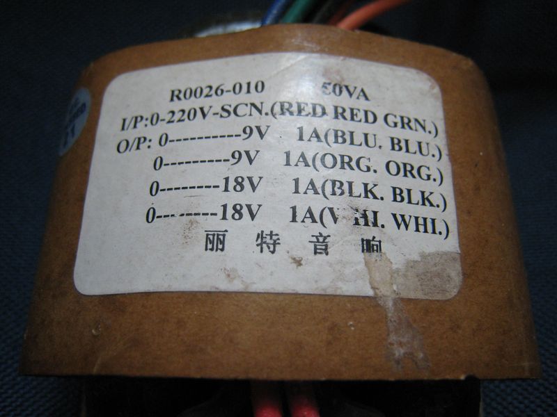

Any 0-12V AC transformer that can supply enough current with smoothing voltage regulation to +5V and +12V will do the job. Watch out for the current draw of the drive, though. Mine wants a hefty 1.5 amps on the +12V line and 1 amp on the +5V line. It's probably time to break out those trusty 2N3055 and some Z diodes again.

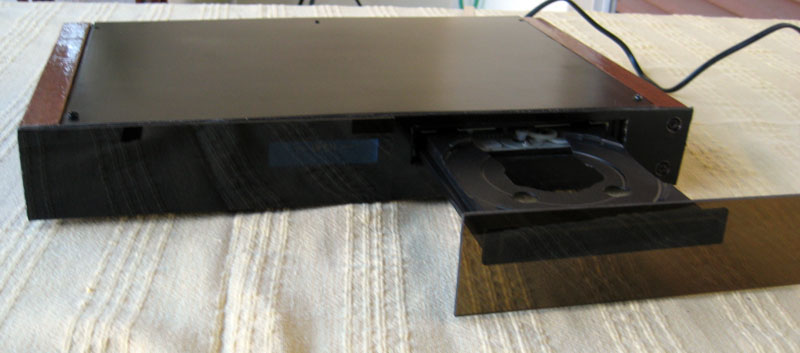

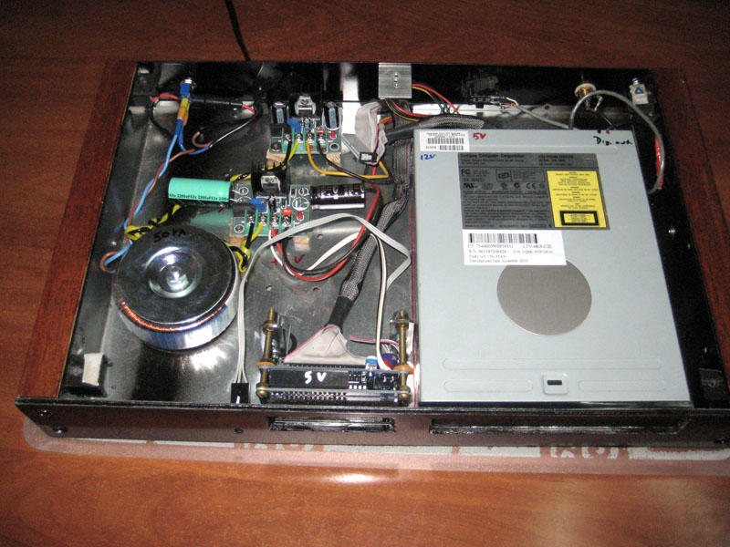

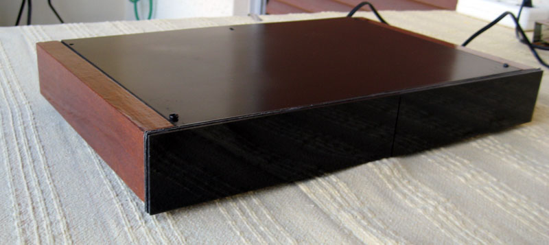

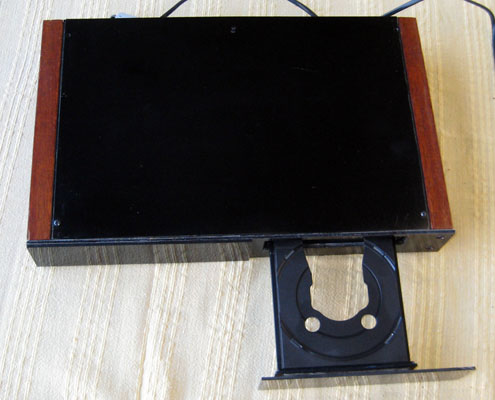

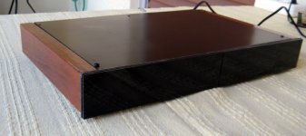

This is my version of a CD player based on a computer CDrom.
I used a "Compaq CDROM LTN-486S 48x" ide device that had the best sound out of allother cdroms had in stock.
Sound quality from the digital output, is Very Good, detailed and natural, (analog output sucks).
I am using this as my main CD player together with my DAC.
YouTube - DIY CD drive based on a computer CDROM
