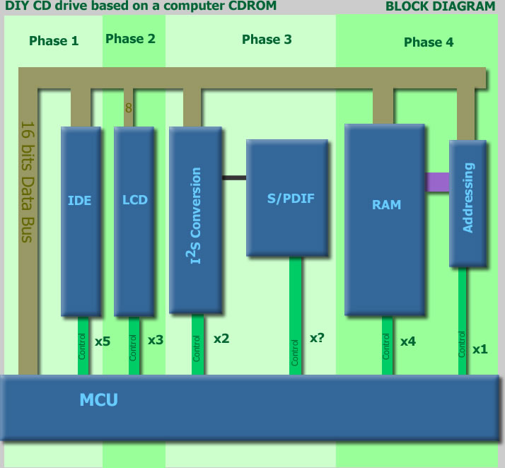

Block Diagram
Here is an attempt at a Block Diagram for our project.
:bored:
I2S conversion
I just wanted to run thru this timing and see if I understand it correctly.
First, I2S is simply 16bits of L followed by 16bits of R with a serial clock and a LR clock that switches states depending on whether the data is L or R.
Assuming we have done everthing else and we have a position in ram begining our data and a function to extract just the L and R data.
The timing of 32 bits is 1/Fs and assuming Fs = 44100 is:
that means we have to transmit 32 bits in 22.68 us
So our serial clock period would be 22.68 us / 32 or 708.6ns
or 1.4112 Mhz and the left/right clock would be 88.2khz or
11.3 us
if our MCU is 33mhz and its instruction time is 1/1 each instruction would be 30ns.
So... do we have only 23 instructions in which to do everything?
What am I doing wrong?
If we simply clock this out without intervention we would still have to do the ram addressing and control the rd/w control pins in this time frame would we not?
Gregory:scratch:
Re: I2S conversion
Konnichiwa,
I actually figured on halve that. I suspect the solution lies in multiple uP's and a shared global memory (classic PC/Mac Architecture) where the drive controller fills the Memory with Data and conrols the IDE Bus, a second controller (much more primitive but fast) that applies the memory reads and another controller for the Buttons, Display and overall control.
Probably a 33/50MHz 16 Bit processor to control the Drive and another to read out the data on external clock and manage buffer size, plus an 8Bit/8MHz dinosaur to coordinate the shooting match...
Sayonara
Thorsten and All,
This is kind-of what I have been saying for a few days. This can not happen with a high level language and now, even with a single processor.
Perhaps we could do the conversion in gates or with an FPGA but still 23 instructions in a single 8bit uC just isn't going to happen.
Using multiple processors would work but that shared memory is going to be a real pain in this short number of instructions. Even highly optimized assembler code would require quite a few instructions to assemble addresses and moving 16 bits arround is no walk in the park.
Is there some sort of IDE or Memory controller chip that we might utilize to solve this issue?
Perhaps there is a way to use the peripherals in some uCs to control the pulses. We could easily use a PIC in SPI mode to generate the serial clock, transmit data, and an extra pin or maybe PWM mode to create the LR clock. Here the Harvard Architeture rules... Then the only instructions required are addressing and moving memory and controlling the bus. Still a tall order....
I want this DAE/Buffer thing to work, I just find that trying to identify and solve the complicated issues upfront make for more successful projects.
Still using a phased design with the easy stuff working and breadboarded we might encounter a solution and be able to expand into the advanced phases.
There has to be a better solution than building our own PC.
Lets put our heads together and figure it out.
Gregory
