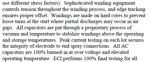

and caps do get wound tight, burned in too - where performance demands - like high power "pollution factor" rated industrial motor run caps
http://www.apec-conf.org/wp-content/uploads/2013/09/is1.3.1.pdf
So they over volt them and at elevated temps? Sounds more like trying to make them fail. I'd prefer a new cap that hasn't been abused 😉
