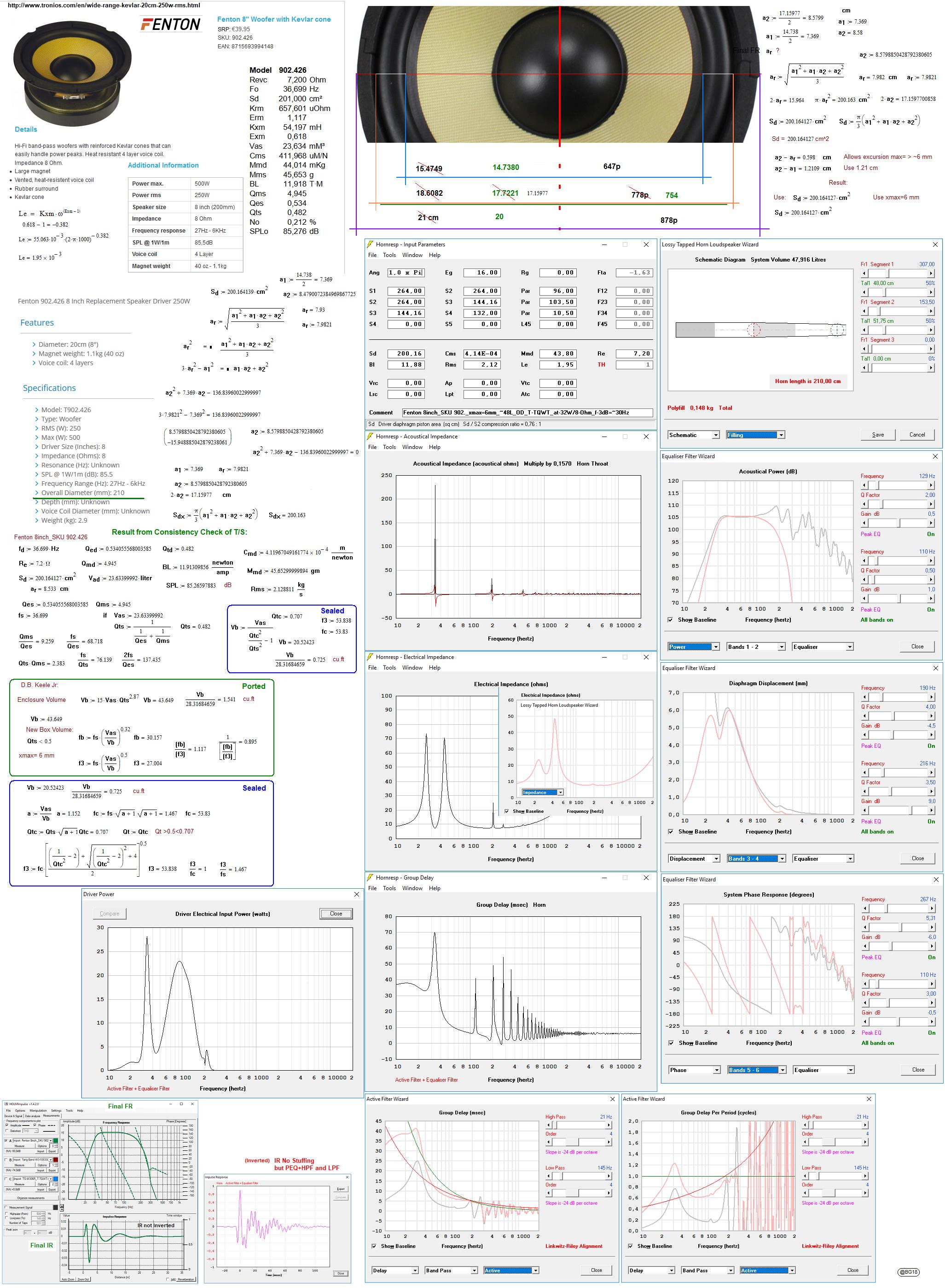

Is there a way to simulate/calculate the effect of stuffing the interior?
Some real tests, arguably better than a simulation:
Data-Bass

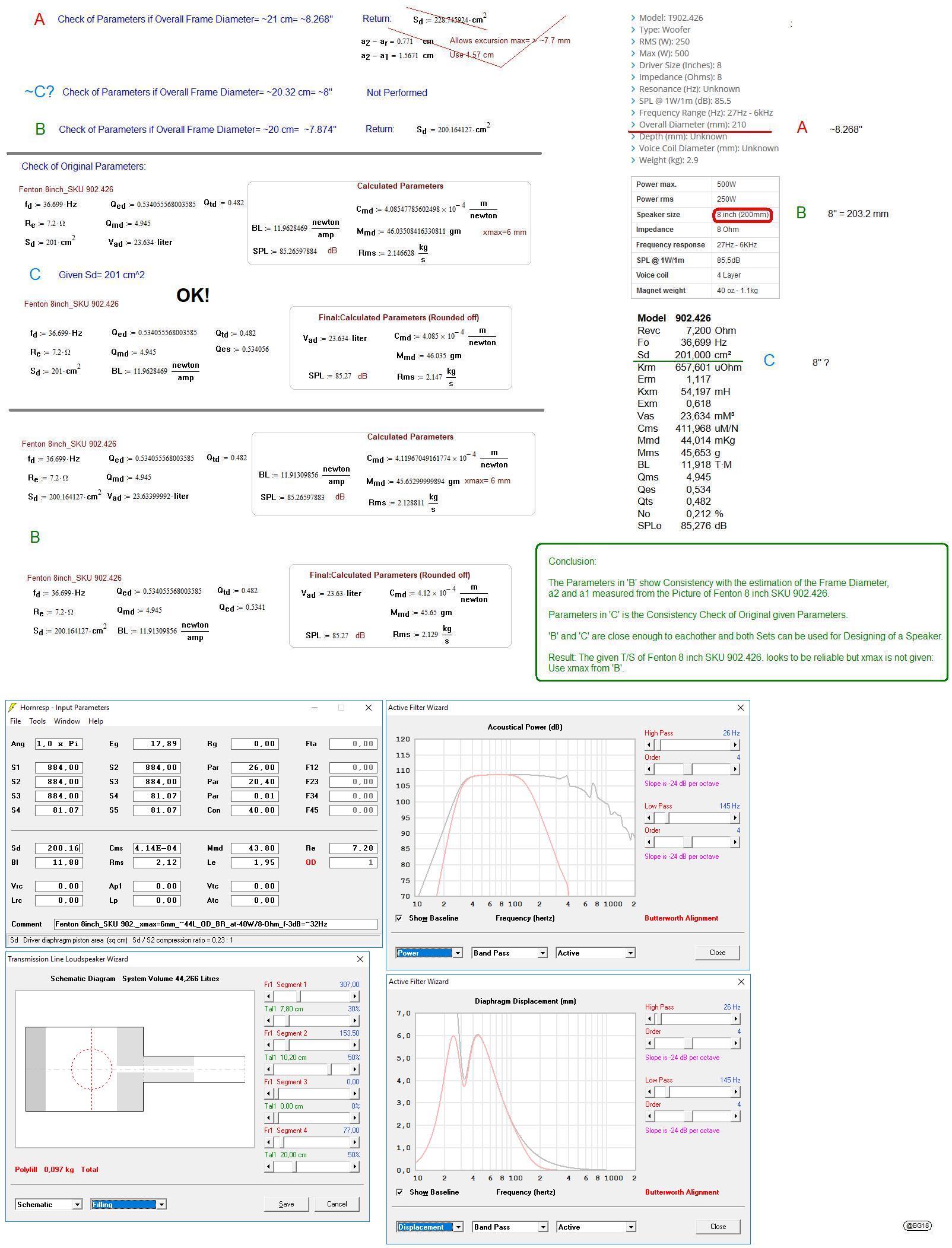

Bjorno's calculations look good. I had to zoom in to make them legible :)

The simulation provided by bjorno states the driver dimensions are actually off, is this correct?

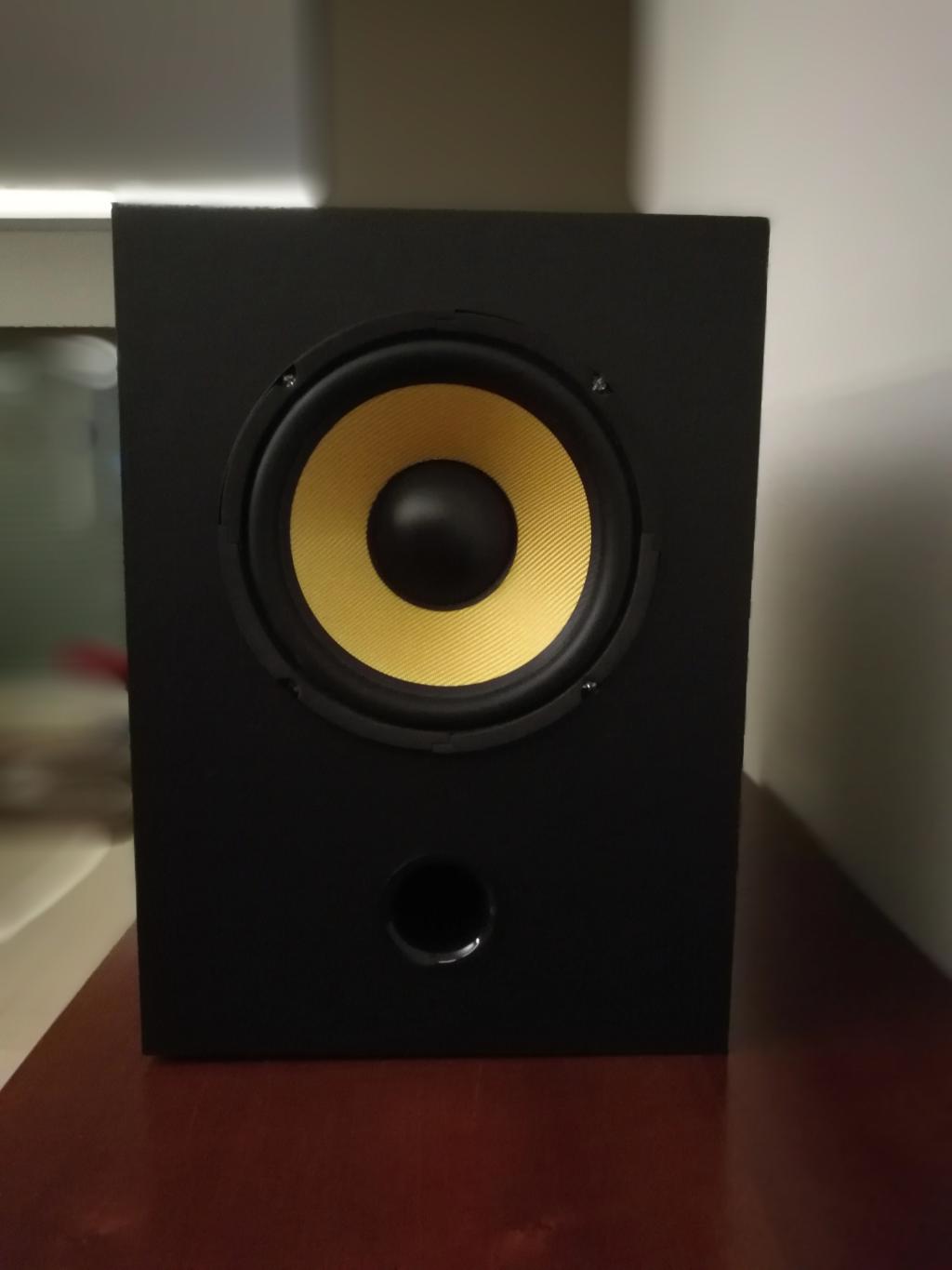

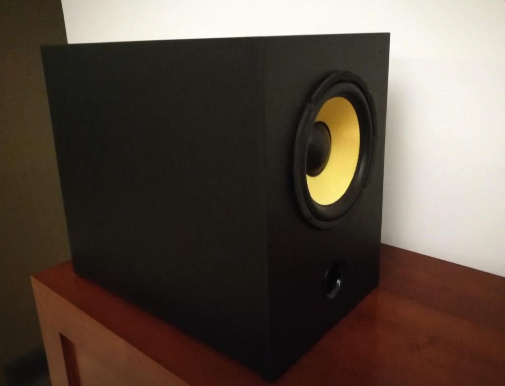

I already built the subwoofer and and just waiting for an opportunity to assemble the electronics, post some pictures and actually test it.
The final enclosure had 290x400x462 mm, and was built from 16mm MDF. This had to do with the space available in the living room, the size of the panels commonly available and the cost. The speaker in the front, with a round port below.
The interior and all exposed faces were "sealed" with several layers of a solvent based product, and the exterior was covered with two layers of a very thick primary, sanded to 600 grit. Instead of painting, I found a black vinyl with a good looking mate texture and used it. It looks nice and was _very fast_ to apply.
A brief test up to 50W provided very nice results with a clear and deep bass (it seems to fit the purpose). However at this level of power, many problems can go undetected.

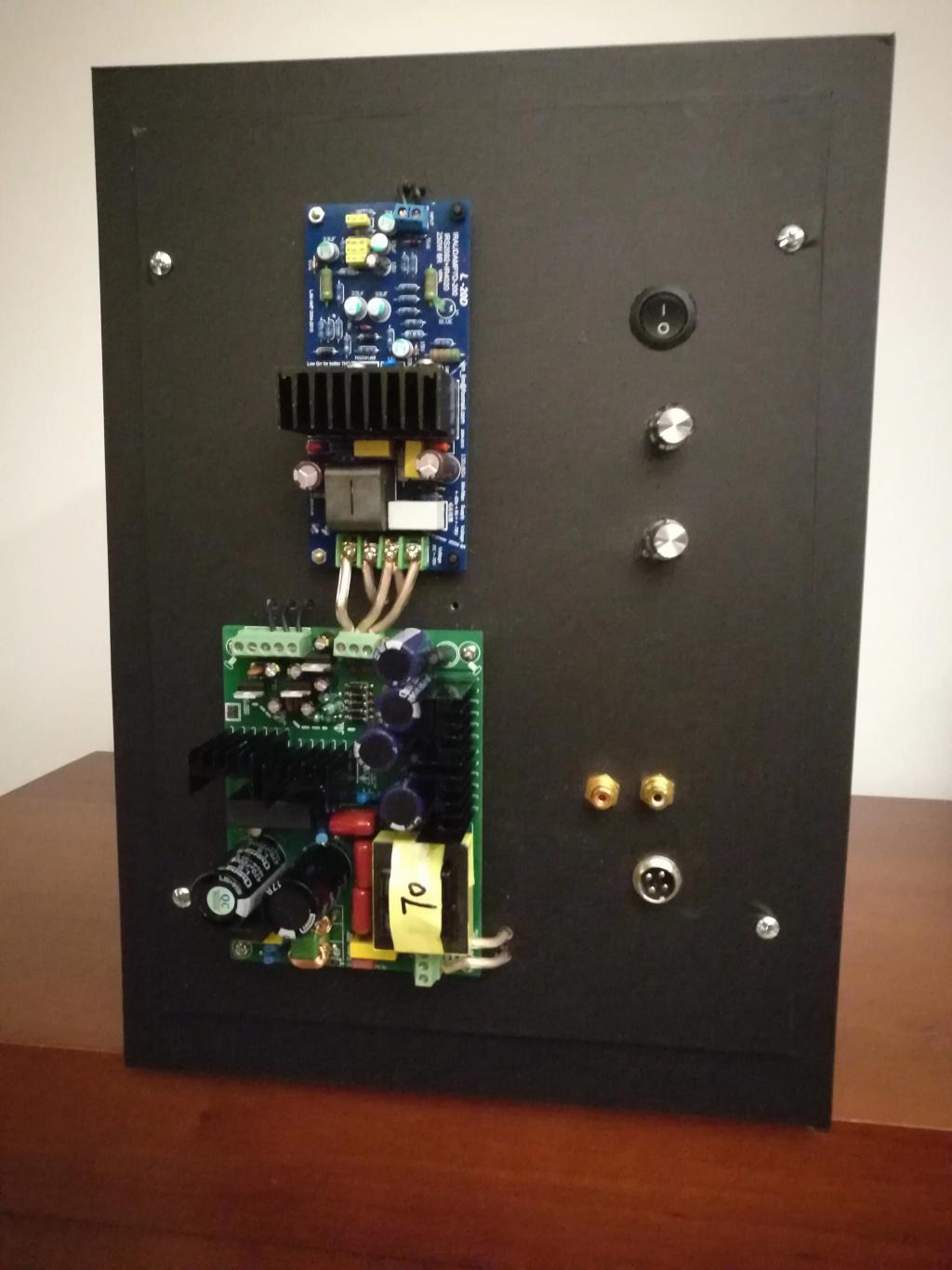

First prototype implemented:
- 5532 based Pre-amp and Filter
- L20D Amplifier
- 500W SMPS
- Currently connected using speaker levels (Right channel) from another Amp.
Amp and Power supply are outside in the back, while Pre-amp is inside the enclosure.

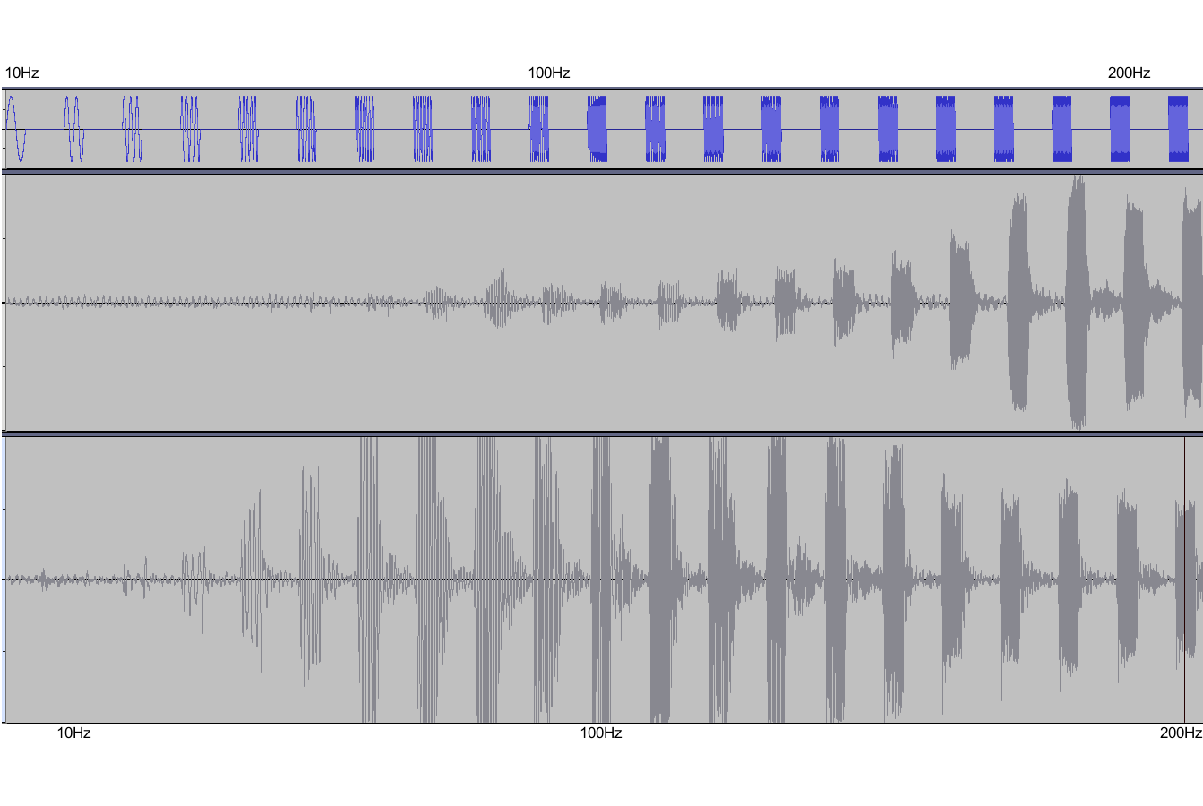

I generated 100ms impulses, with 10Hz of separation (top line), and recorded the output from the Speakers (middle line), and subwoofer (bottom line). Microphone is not calibrated, nor expected to be linear. The subwoofer complements the speakers by adding quite a few frequencies and starts putting tones at ~20Hz (with audible attenuation).
It should be noticed that the speaker and subwoofer lines are delayed by about 300ms (I was using bluetooth)

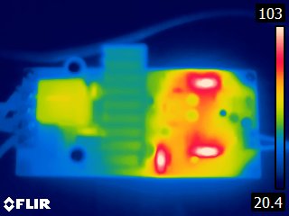

In the meantime, temperature images of the L20D and SMPS.
Based on this I will probably increase the wattage of those resistors.

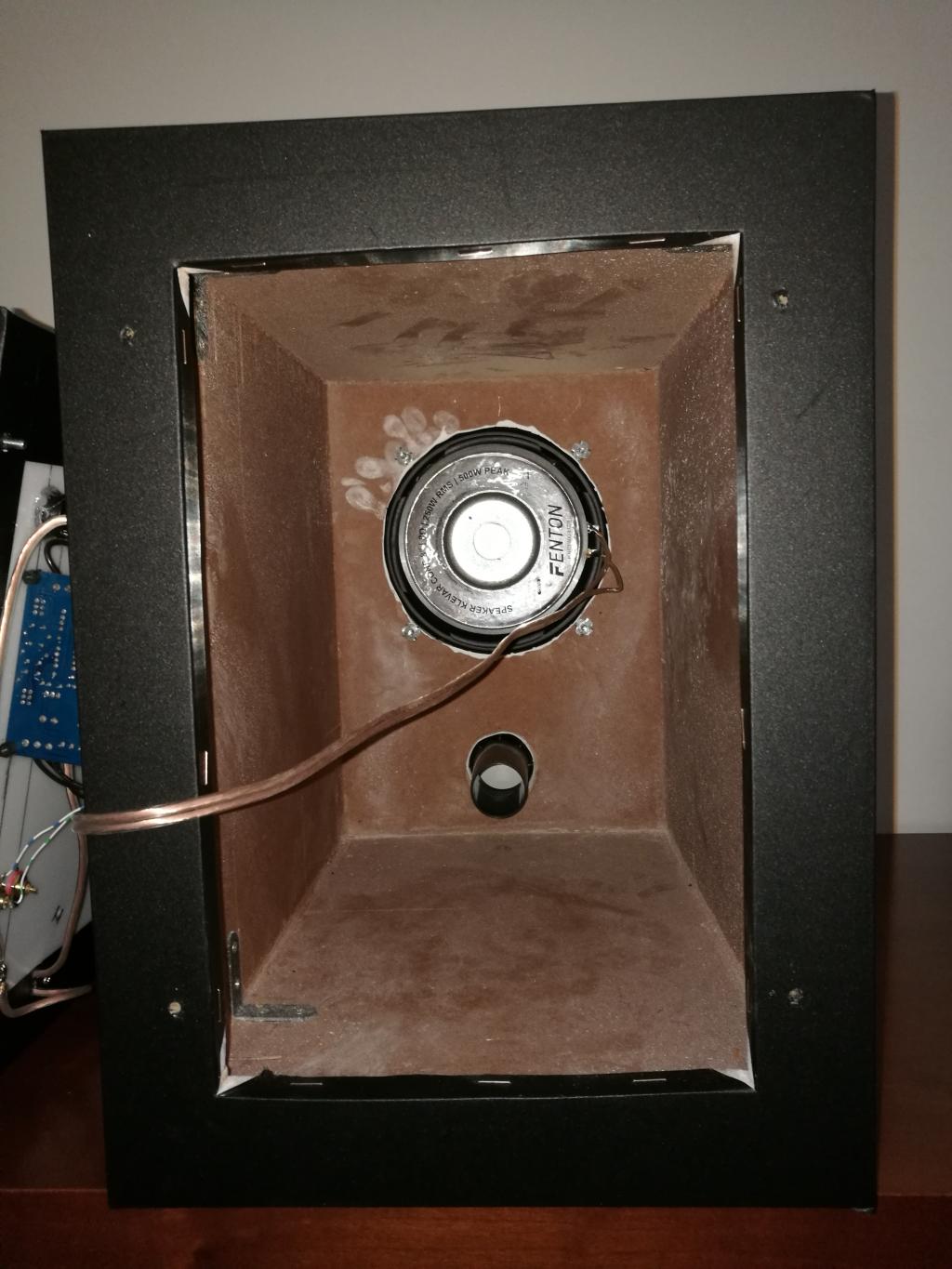

Some photos of the current prototype, still missing many things.
The back plate is still PVC and will convert it to steel or aluminum after the positioning is correct.
No internal bracing as it will be used for comfortable levels.

Yep. Not sure if the components will go inside the enclosure or I add a protection to the outside. Don't like the +100ºC of those resistors, but the amp + SMPS should be very efficient (>90%).
The current approach will be to leave it in the outside, then enclose it and monitor the temperature. Probably I will also add a small fan (6v) because the resistors are near capacitors and that is a recipe for failure.
