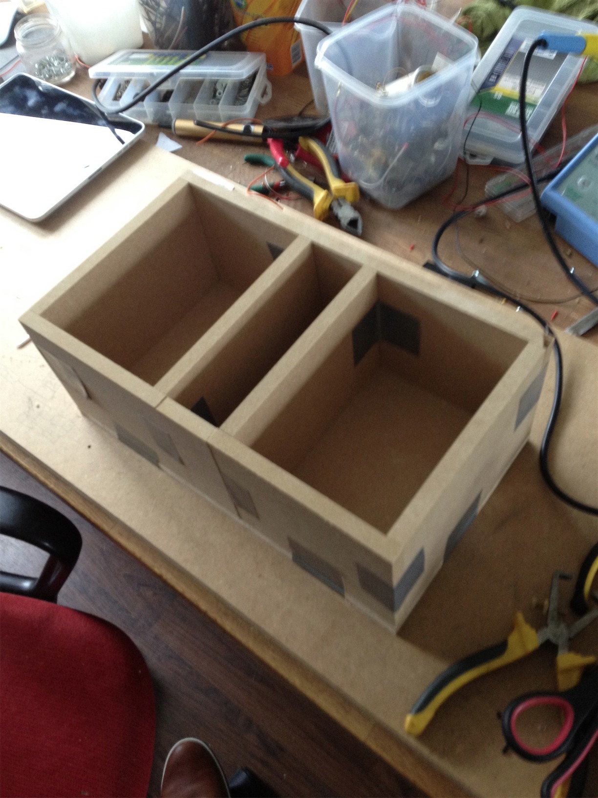

Hi Everyone! My first post, and here to draw on your knowledge and experience.
I build this boombox for my little sister because she likes to listen to dubstep.
Its made of random old parts laying around the house. I don't even know the power ratings of the speakers or the amp. It surprised me by how GOOD it sounds!
So I here to ask questions and build a better version that really kicks and reproduces sound more accurately!
Can you guys give me some pointers?

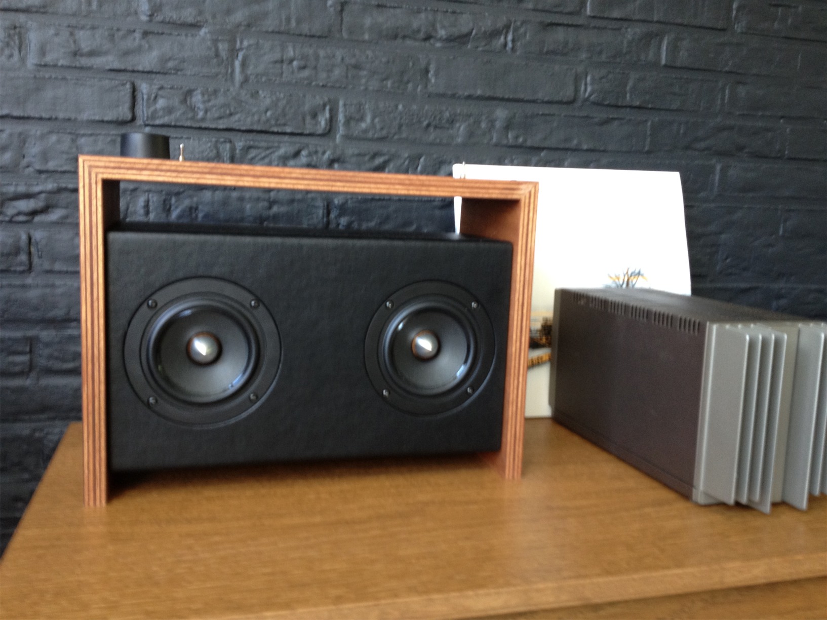

Hi!
I almost went the same path and had the same question. So fist I built a car amp with car speakers in an old tube radio. Than I decided to make it more audible and portable. So I did some reading and off course I red the Boominator thread. But without speaker software I decided to find a speaker DIY kit so I could read some reviews about the sound and some information about the used amps.
So in the end I build two ct218 speakers (lautsprechershop.de) and combined them with a ta2020 an li-ion battery. (I will place some pictures later) a bluetooth module....put I all in an enclosure and voila. And yes it sounds brilliant but for a party this not (yet) your machine but maybe a point to start from. Why? Not yet for a party? Well the volume is there but I want a bit more bass so I am planning on building the exact same enclosure with a bass unit with its own amp and power supply.

Wow thank you guys!
My target is to get good bass I can feel, and quality sound!
I want to the sub to be around 500 - 750 watts, powered by a mono amp.
And 125 watts for the 3 way speakers powered by a 2 channel amp...
12 So i can take it to camp, and hook it up to a deep cycle battery.
At home I will used a quality 12v PSU with 1000 watts rating...

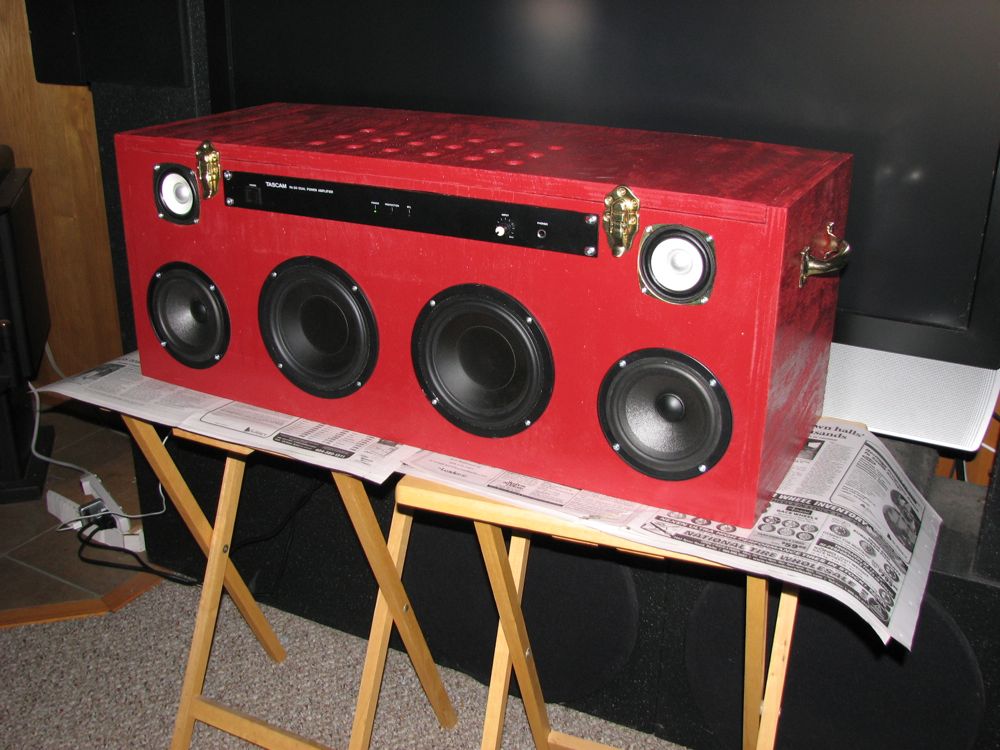

You can do it up nice, but the better you do it the heavier and less portable it gets. I need help if I want to carry this baby more than 50m.
7 compartments
2 amps, 125w plate and 30wpc Tascam
7", 5.25" and 2.5" drivers
3/4 plywood
Designed to resemble a toolbox

Wow! That looks cool ^^^!

I'm sorry but..
Divide all those power ratings by 10.
1000w @12v = just over 83A.
Consider for a moment that speakOn connectors used world-wide in PA systems are rated at 30A per contact - you'd have to run 6 contacts total, and even then, I'd expect the plug to get warm.
That woofer won't stand a proper 500-750w amplifier, and the smaller drivers won't stand 125w. The battery that could sustain up to 1000w for a few hours would be large, and incredibly heavy - not even approaching "portable".
30Kg for a 100Ah 12v SLA. This would run full power for maybe an hour and 10 mins. It also costs >£200. Two or three of those would get an evening of entertainment done, but the amount of weight to carry would be silly.
I honestly hate to take a whizz on your bonfire, but the numbers you've mentioned are bonkers.
