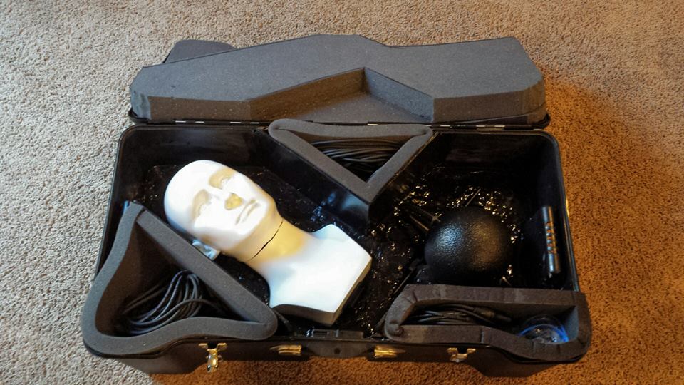

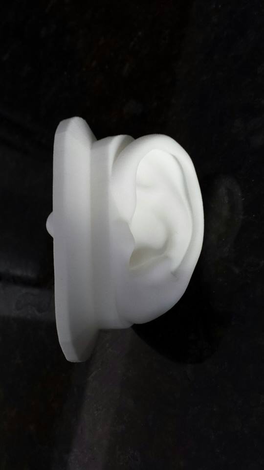

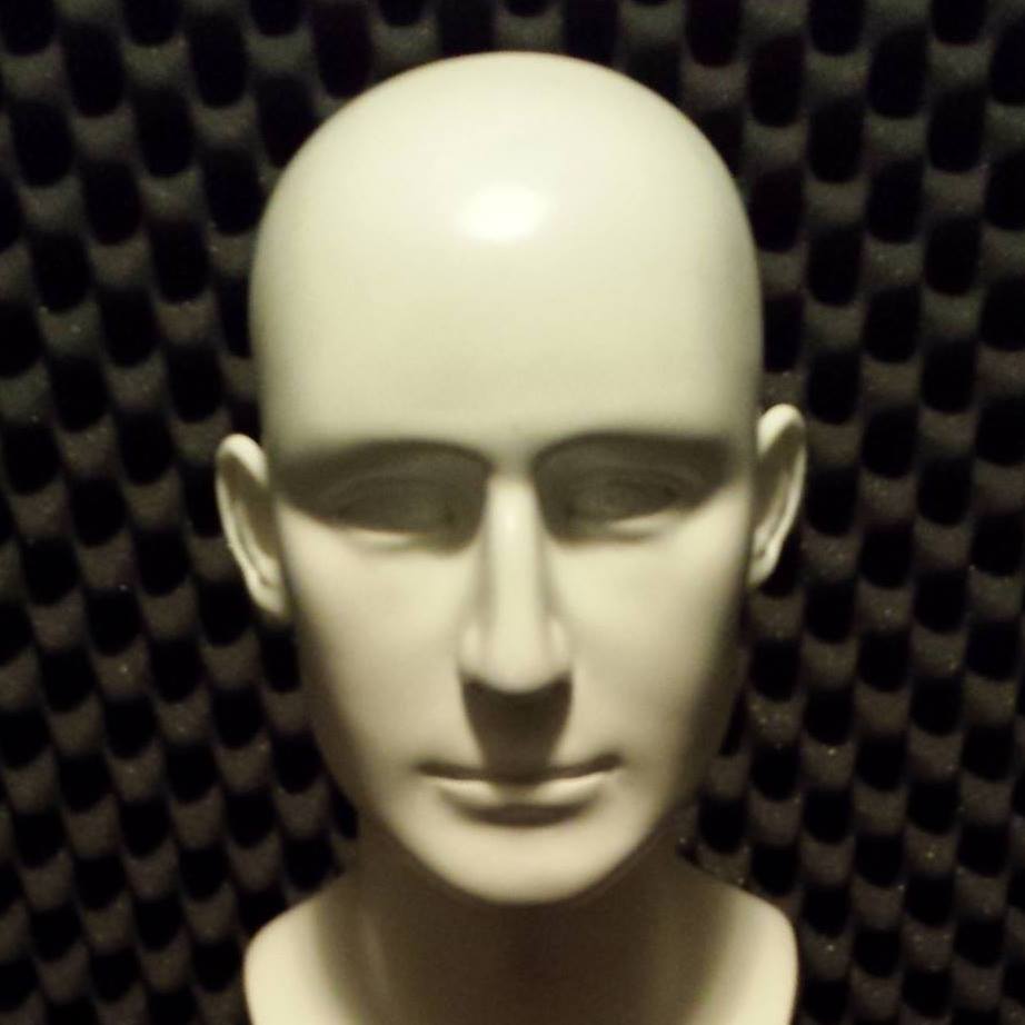

I thought I might share a couple pictures..

Just a quick note to say I've built a Mk2 version of Ed. This time I've added 5mm (inner diameter) rubber tube from the pinnae to the mic capsule. 5mm was chosen because it matched the diameter of the entrance to the capsule. I know the ear canal tapers, but this'll do for now.
Result: much much smoother mid-high range. Before, there was a very deep dip at 8kHz. Now, there's a fairly shallow dip at 10kHz. Still ragged further up, though.

Hi Chris,
I'm glad the canal seems to work better for you. This confirms my own observations of the canal being necessary for proper binaural recording.

I do remember the response being somewhat more ragged with the plastic tube in respect to my ear model. I suspect the abrupt transition between pinna and tube might be the culprit.
I did not pass through a model with smooth transition and a straight canal (after the smooth transition area).
I just went from straight tube to anatomically accurate canal so I can't be sure about my assumption.
