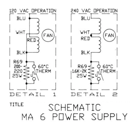

Madisonears - I am definitely interested. I have a question/ information. On my current setup my Rane AC23 has all RCA fittings. When I go to my Rane MA6 I use RCA wiring until I go into the amplifier. There I use a RCA to TRS adapter. The support person from Sublime hinted that this could be a complication. They had balanced or unbalanced. Souns like my set-up sort of went down the middle. Any thoughts about this?
You don’t need balanced outputs for short cable runs. Just be careful of the grounding.

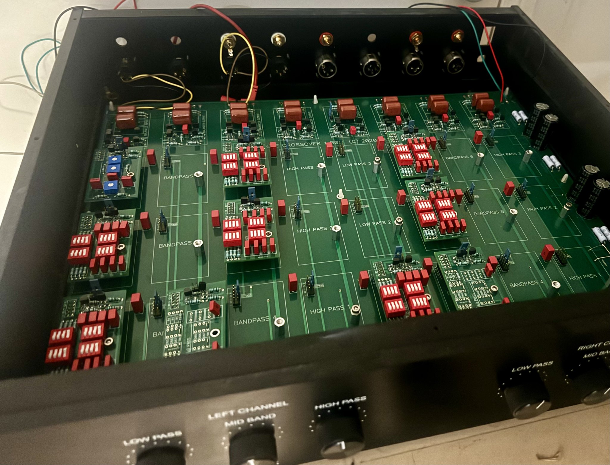

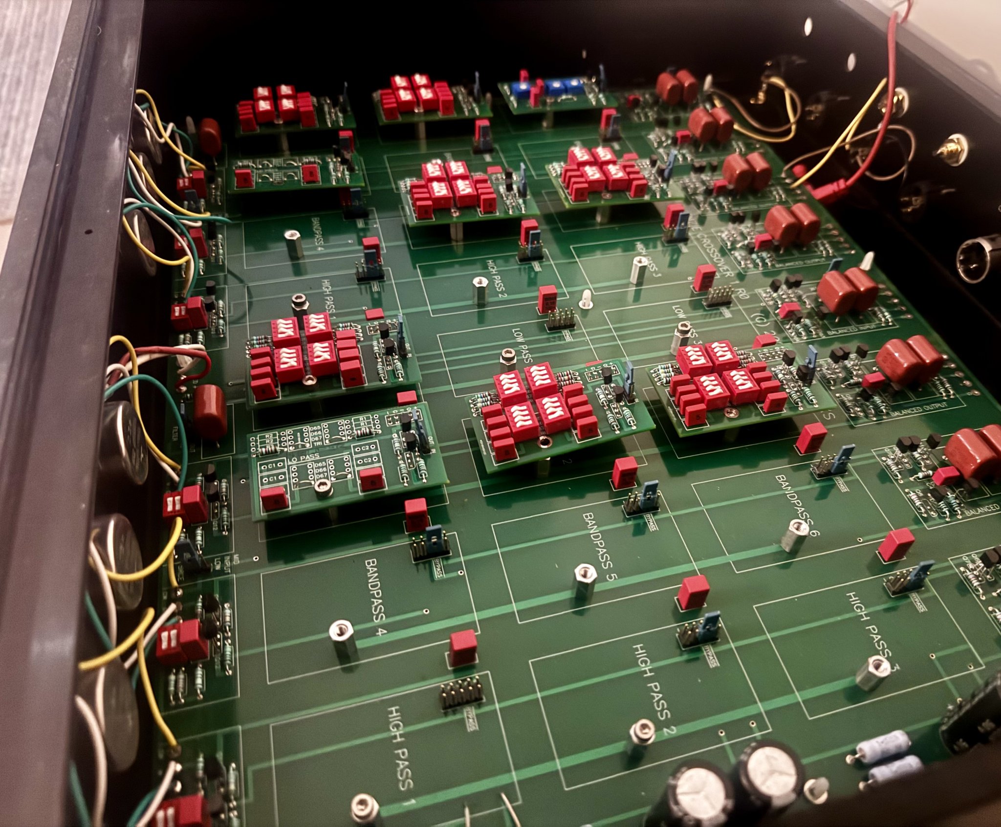

User adjustable crossovers
One thing Nelson and l looked at was adjustable trim pots which allowed a good half octave of adjustment for the crossover frequency when we were evaluating the prototypes.
Nelson went with dip switches in his FirstWattB4. But that can get confusing when you have a rows of dip switches like in the attachment.
Below is one of the large format Jfet crossovers we worked on. It’s not a kit or in production so don’t ask. But you can expand the Kit Pass 6/24 kit to scale up your system.
