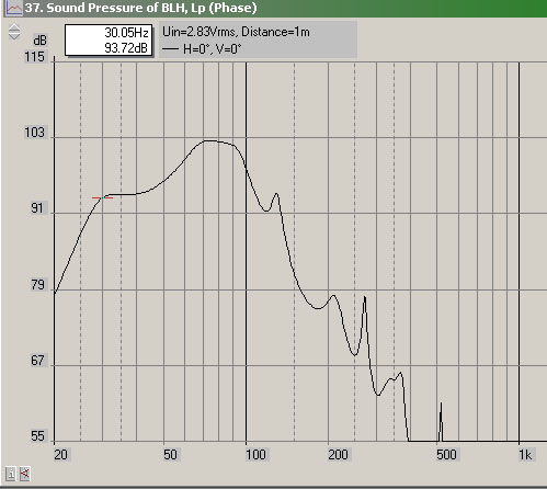

OK GM, here it is, Bon Appetit: 😀
Filter 'LPAmp' | second order Butterworth lowpass
fo=0,15kHz | Plate amp variable freq
{ Q=sqrt(0.5);
b0=1;
a2=1; a1=1/Q; a0=1; }

You'll notice the active filtering (amp+computer) and the rumble filter of the amp.
BTW, I think both programs assume totally rigid boundaries, so the difference should be elsewhere.
I found out so far that the Radiator Element (10cm*150cm slit between wall and bDEAP) is actually in full contact with the wall, while the above script has it floating 75cm and 22cm away from it. Changeing this to 1cm distances gives 30Hz@100dB till 90Hz around 112dB. Still 5dB short of HornResp @30Hz, but if i remember correctly, HornResp just assumes radiation into 1/8th space, while in this case AkAbak correctly assumes it radiates about 75cm *away* from the corner. Unfortunately I can't find a way to make AkAbak point the Radiator into the corner ( Check out Def > Def_Reflector ... and click "Bottom Corner" and move the sliders), but I'm sure if it could be done, the extra 5dB loading in the lower octave would pop up.
I'll try to explain how i think hornResp's SPL curve would be attained:
Press your wrist against the wall and your fingers into the corner fold. Then move back a little bit and tilt your fingers so they are about 1/2 inch away from the fold, keeping your wrist against the wall. The external airpath starts then at your wrist and ends in your fingers, exactly into the corner. This is what Hornresp models with the extra external segment included.
If you keep your wrist into the fold and do the same with your fingers, the external airpath ends *away* from the corner fold. This is what AkAbak models here and I think this is why there is less sensitivity that expected from HornResp.

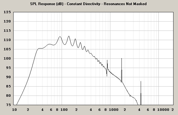

Hi Cordraconis,
Just to elaborate:
At very low frequencies there is a theoretical +6dB improvement in SPL response each time the solid radiation angle is halved. 3dB is due to improved acoustical loading conditions (enabling twice the power to be radiated), and the other 3dB is due to the doubled power radiating into half the space. Going from free space to eighth space therefore gives an 18dB increase overall.
At very high frequencies (assuming constant directivity) there is only a +3dB enhancement - the acoustical loading conditions do not change when the solid radiation angle is halved. Going from free space to eighth space therefore gives a 9dB increase overall.
With a directional horn, at very high frequencies there is no change in the on-axis SPL as the solid angle is halved. This is because the sound radiates in a "beam" fully contained within the defining solid angle boundary.
The top chart in the attachment shows the constant directivity response for a simple exponential horn. The black trace is the eighth space (corner) response and the grey trace is the free space response. The 18dB difference at low frequencies and 9dB difference at high frequencies can be clearly seen.
The bottom chart shows the on-axis directivity response for the same horn. Once again the black trace is the eighth space (corner) response and the grey trace is the free space response. The 18dB difference at low frequencies and 0dB difference at high frequencies can be clearly seen.
Does AkAbak give the same sort of results?
Kind regards,
David

The directivity tool works with a single segment straight horn so that is why my bDEAP model (with the added external conical segment) had it greyed out. Ditto for the AkAbak directivity.
Once I figured that out, I've done the comparison with a single 300cm long conical segment from 180 till 2213 cm^2
I couldn't find out how to overlay Free Space Vs Corner loading responses with 0° off-axis in HornResp, so Cptn Photoshop came to the rescue.
Sorry for the delay.
Honestly, it doesn't seem such a clear-cut case as I tought. The ripples make it more difficult to see. Should I compare with the peaks or the troughs?
AkAbak makes the whole curve smoother and shifts the sensitivity up. If there is some LF lift, it is not so pronounced.
HornResp mainly shifts the sensitivity up and there is some LF gain, but the ripples are more obvious.

Hi Cordraconis,
Many thanks for the feedback. I am not sure why Hornresp and AkAbak results turn out to be so different in this case.
Cordraconis said:
I couldn't find out how to overlay Free Space Vs Corner loading responses with 0° off-axis in HornResp.
1. Calculate the Free Space 0° off-axis response, then press Ctrl+C or right-click on the SPL chart and click "Capture current results".
2. Calculate the Corner 0° off-axis response, then select Tools > Compare Captured or press the F4 function key.
I would compare the peaks.
Kind regards,
David

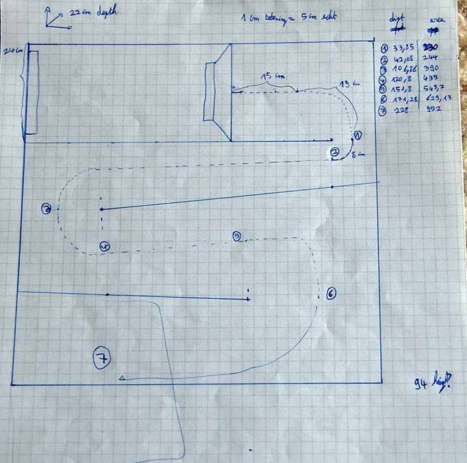

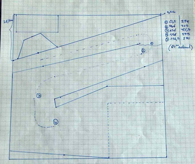

Hm, didin't realize it has been so long since I posted about my progress, or the lack of it. 🙂
My next step was to make the cut plan to squeeze as much panels as possible out of a 244cm*122cm MDF panel (18mm thick)
For MJK - who was interested in my plans to use them with a 8" car subwoofer - I took a snapshot of it so he can beat me to the punch if he gets his hands on some MDF before I do:
Sorry for the white rectangles but i tried to remove as much non essential things out of the pic for compression reasons. It should be clear how to proceed. The separate 61*22cm panel will come from a MDF leftover I had from my previous sub, so I'll only have to buy one large panel for the rest.
I'll try tomorrow to send an email to the AkAbak authors to ask for the discrepancy between HornResp and AkAbak 's LF loading in corners, but since I'm using the free Version 1, I doubt the'll give feedback.
Like they say around here: "You have a NO by default, you can get a YES if you try and ask".

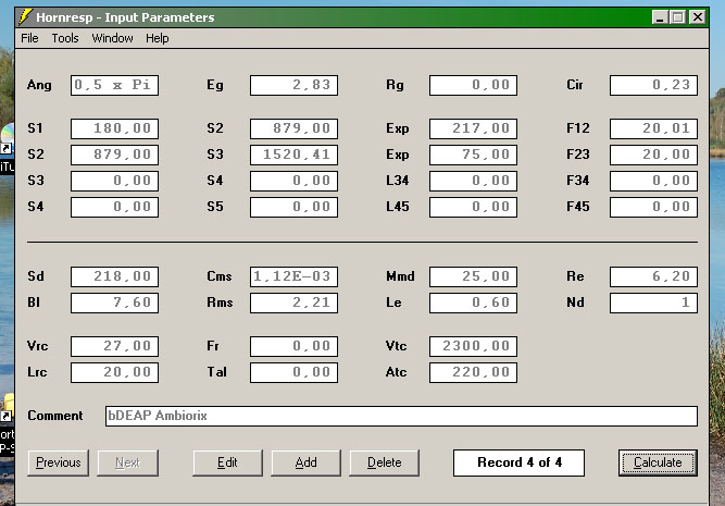

Once the woofer was mounted, it was testing time! HornResp said it would give usefull output till about 50-60Hz with the backchamber open, so that should do for now.
I used the large glass doors as the boundary and toed the tip about 50cm outwards. This flare rate was too high but I couldn't do it otherwise without a free corner in the house.
