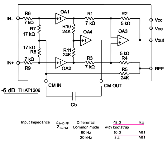

An excellent chip for line receiver work.
Input impedance is 48K. High for many purposes, low for some internal probing.
Since it includes all the precision trim, you could drop a pair of unity-gain TL072/? in front to get infinite Z with large CMRR.

I would look at exploiting the CM feedback with external opamps to reduce any common mode, especially if you need gain from them. I would use something like an OPA2134 for FET input opamps for lower noise and better linearity.

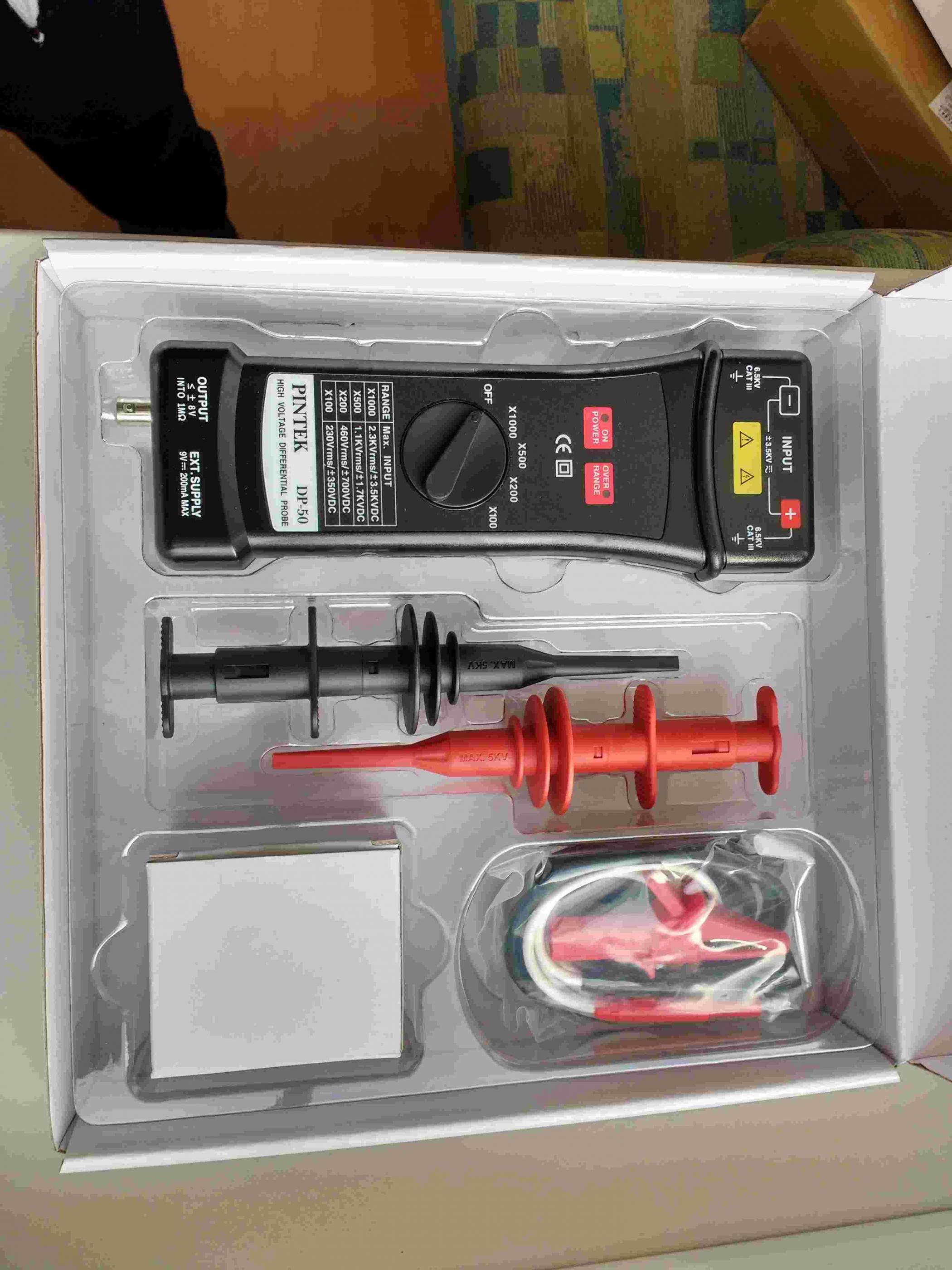

Last year i have bought the 50 MHz Pintek DP-50 probe.
The price was about 330 €. The probe does what i expected.
The housing is of very good quality, a bit too big maybe.
The circuit is in principe the 3-opamp differential amplifier.

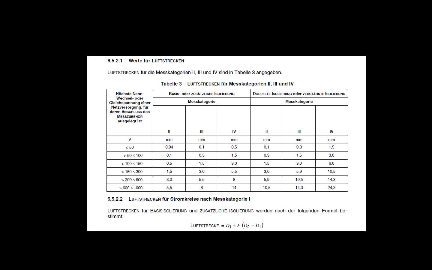

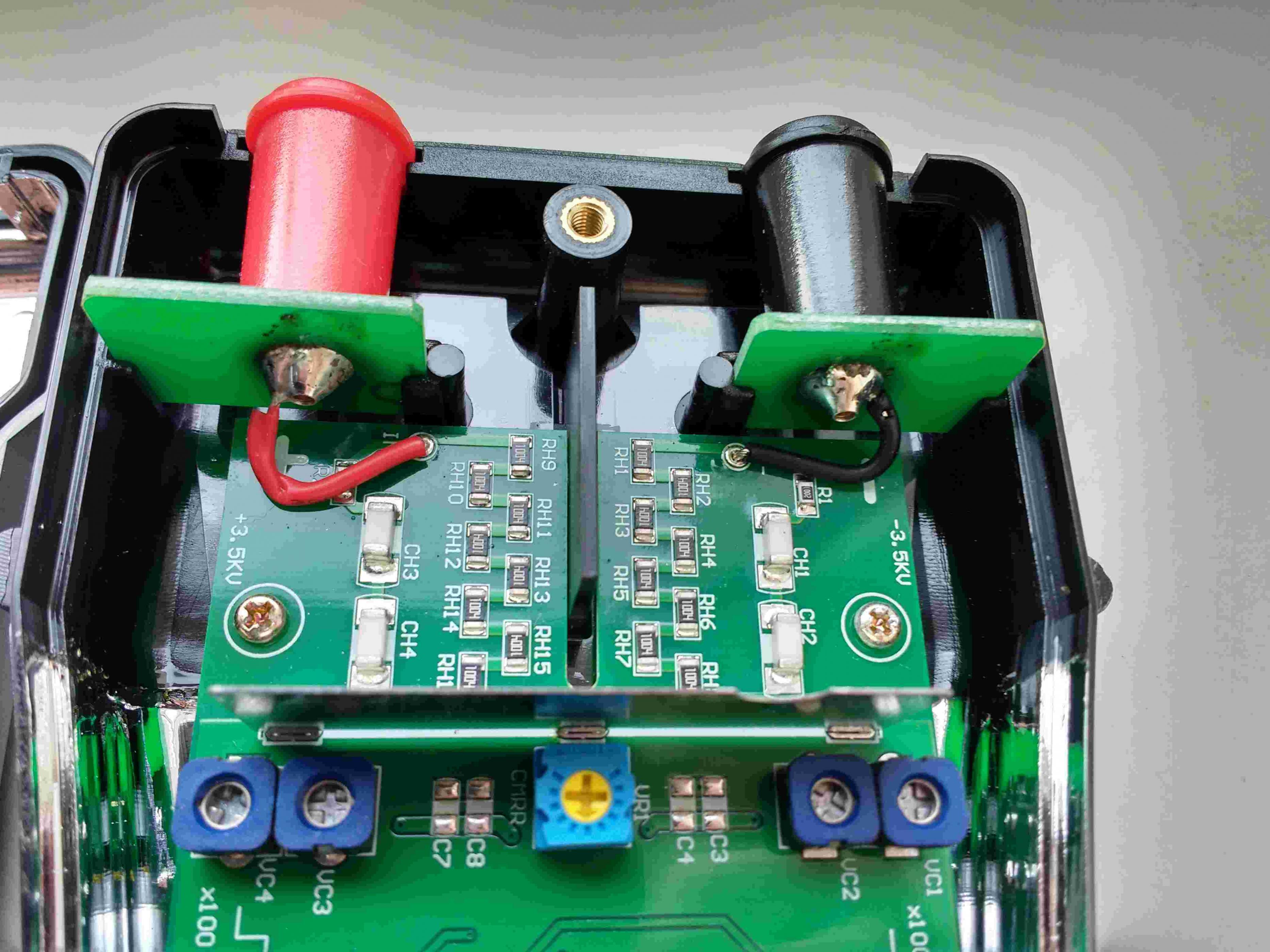

The big dissapointment is the input protection:
The creapage and clearance distances are no more than about 2x 3 mm
(or even less - can't remember now)
That makes it only a 300 Volt CAT-III probe (See IEC 61010).
Be aware that this information is not stated anywhere! The label 6.5 kVolt
CAT-III on the housing have criminal tendencies!
And i don't trust the tiny and brittle input capacitors and resistor network.
This capacitors are prone to cracks due to mechanical stress.
The PCB is not very clean, and the big switch in the middle makes it
necessary to route the high-frequency signals
forward and backward half the print.
Otherwise the print is of good quality.
The handbook looks good, but is crap too.
Important information like the input impedance is clearly wrong
(8 MOhm measured).
The supplied leads and grippers are of good quality.
The BNC cable is even isolated, so that you have
additional safety in case that the input divider is faulty.
This approach is problematic because it does not work well with high voltage or high speed input
transients and it lowers the effective common mode
impedance. In most cases you want a very high CM impedance.
In addition the common mode rejection is always limited by the input resistor tolerances and not by the active diff-amplifier.
So no need to use fancy circuits.

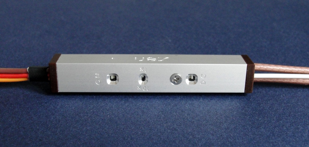

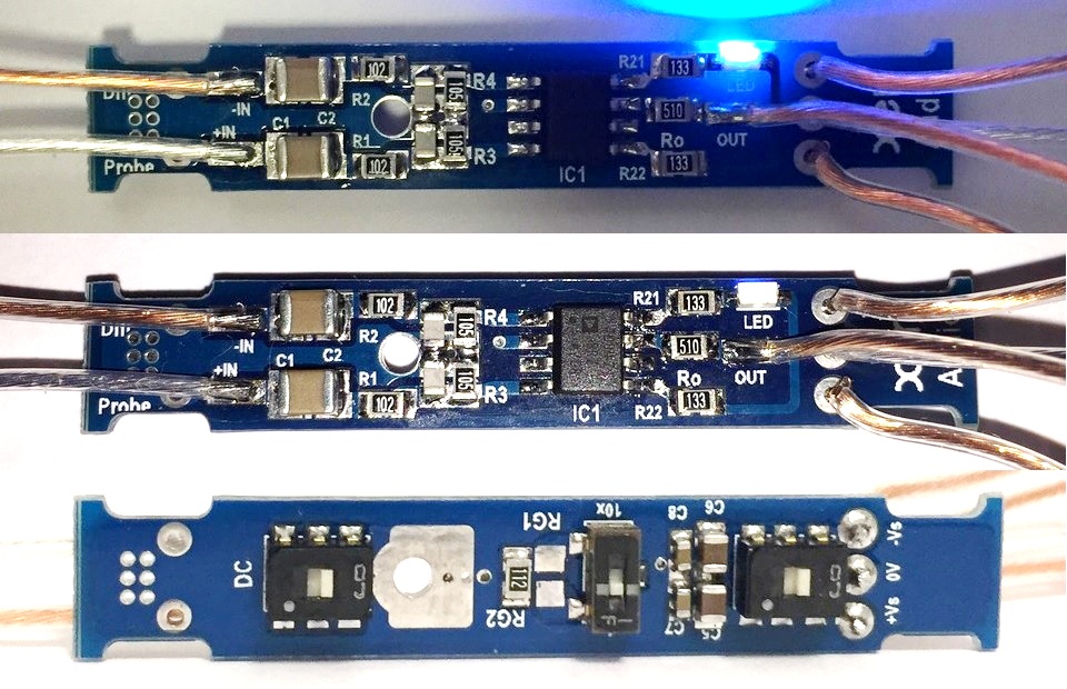

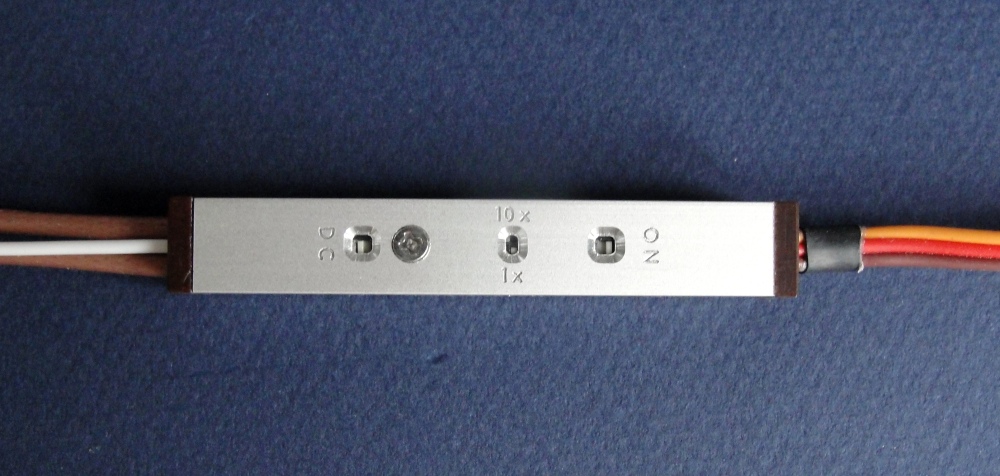

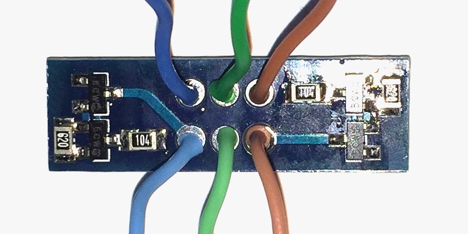

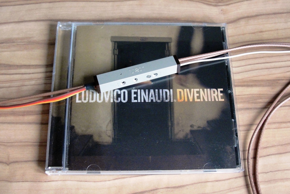

A bit late for the fun.
We needed one and we made one, for audio use.
Essentially a single AD8421 with a pair of 1M ohm attenuators upstream.
(You can choose your ratio to suit application. I used 9:1.)
Switchable AC / DC coupling, switchable differential gain 1x/10x.
Option to limit bandwidth with a shunt cap (NP0).
With 0.1% Susumu 0805 resistors, we achieved better than -75dB CMRR from 100Hz to 50kHz on our test board.
Expect that to improve further when properly housed and shielded with battery supplies.
PCB is 54mm x 8mm. Will fit into an aluminium tube of 10x10x60mm. PSU external.
PCB layout is fully symmetrical for both inputs.
Signal cables in (2x) and out will be RG179.
Quite happy with the results.
Really good chip, especially the high input impedance.
Patrick
PS the picture posted here is a low voltage version with no attenuation (1:1000).

To much work to make product, especially the machining.
We can send you PCBs. How many do you want ?
You can make your own housing if we publish drawings ?
If not we need to see when we can do ourselves.
Currently CNC facility is not operational.
Will take a few months, unfortunately.
Patrick

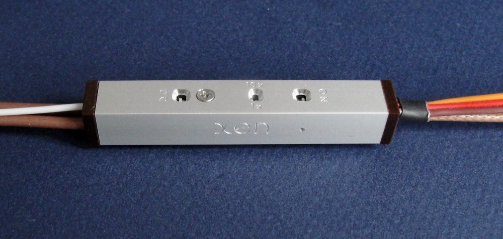

We are famous for taking ages.
The electronics was easy, but the mechanical stuff takes a while.
Very pleased with the results though. 😉
Patrick
Patrick

Looks nice, now fit a 7A22 in that box. 😀
It does everything for me, thanks to the very nice AD8421. 🙂
Shall be making 30 of those (mechanical parts) and make them available to a few friends here.
