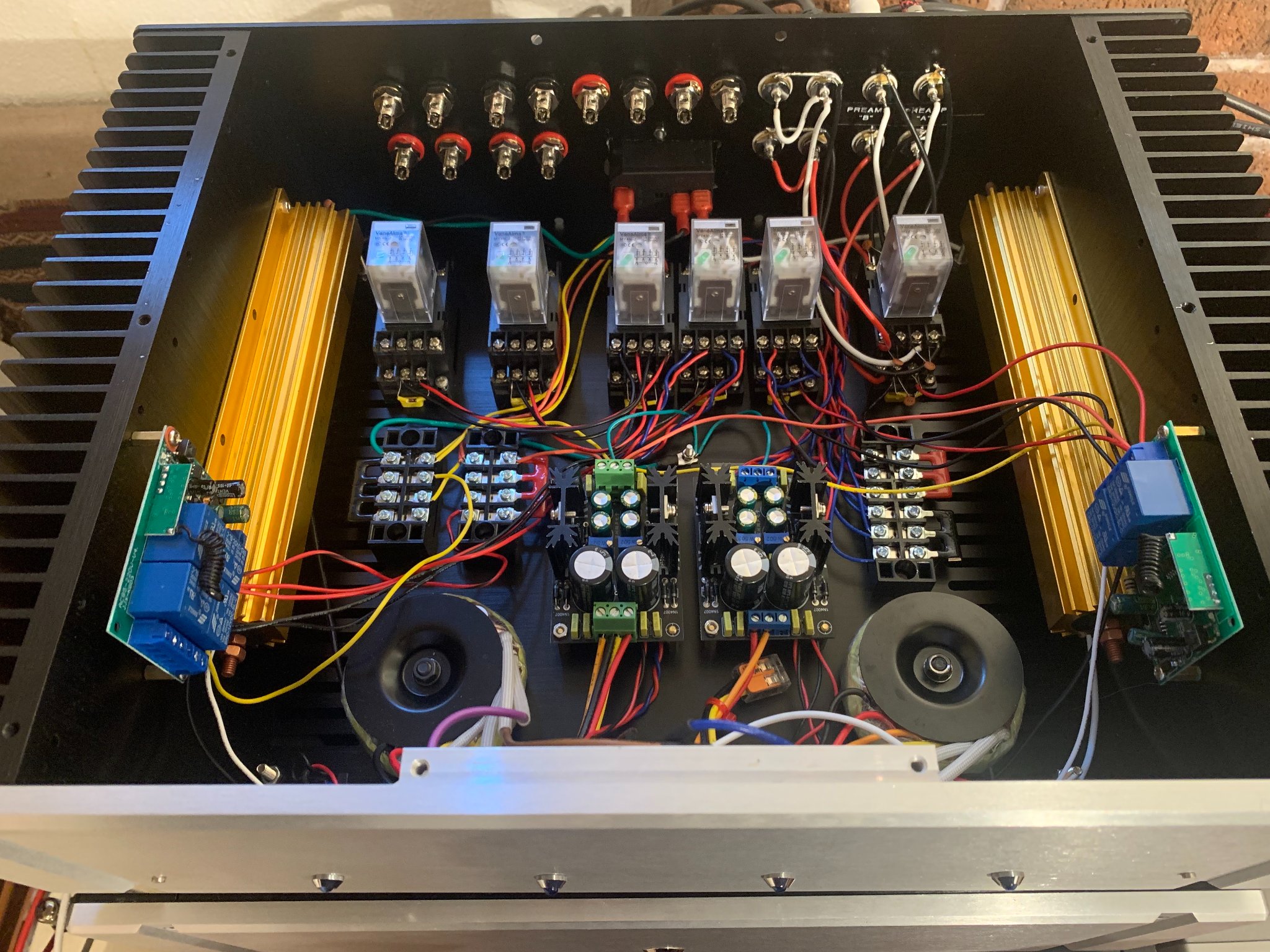

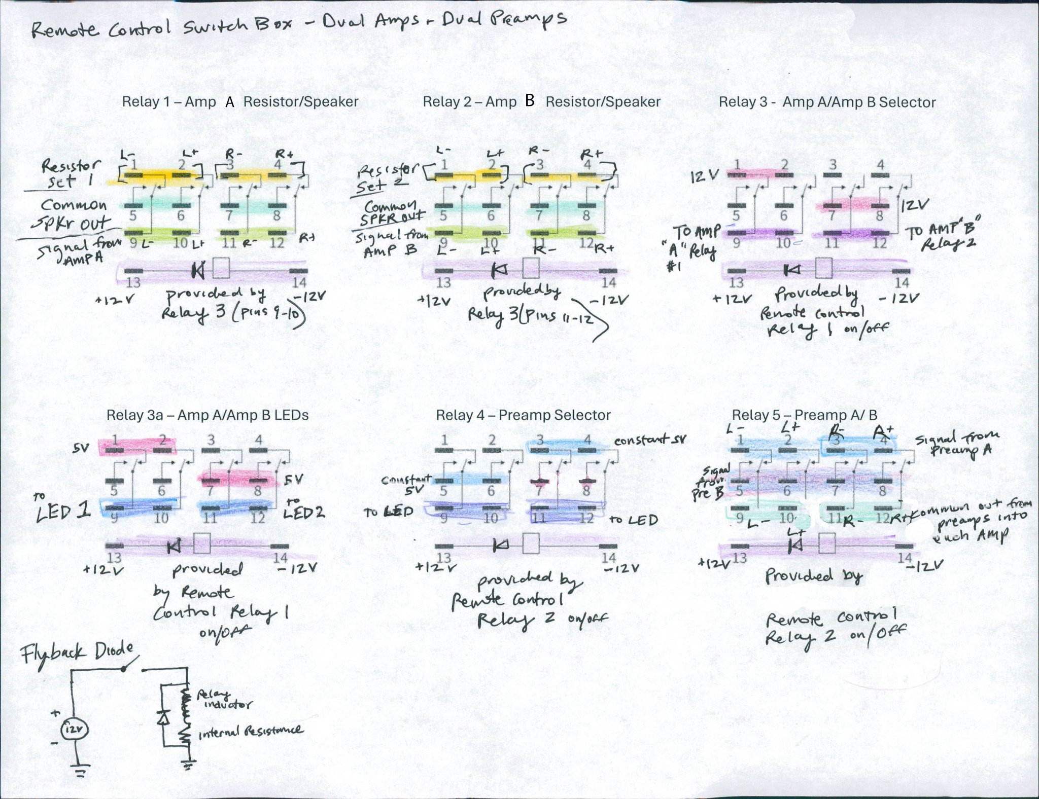

I’m building a switch box to do A/B comparisons of two amplifiers as well as two preamps. I’m including a diagram of the relay contact assignments of the relays that handle the audio signals that I am routing through the device. The two selector relays (3 and 4) are turned on/off remotely from two different remote control units. At this point I have the preamp relays (4 and 5) wired up and switching properly from its remote unit. The signal path is correct and I am able to switch between two preamps, but there is a loud pop each time signal relay (5) turns on or off. Using a scope (without a preamp attached), I’ve measured the spike going into the RCA plugs of my device at the moment of the relay switching and it ranges from 50mv to just under 200mv and lasts 250-300ms. If these spikes indeed account for the popping noise they shouldn’t be enough to harm a speaker, but they are quite unpleasant.
I have 1N4148 flyback diodes across the 12v voltage input pins of the relay, but I’ve actually tested for the surge without the diodes and it is about the same. My best guess is that voltage from the switching pins is able to jump to the signal pins. I would have thought that they would be well isolated. I’ve tried installing .5uF caps across all the connections (power and signal) but hasn’t helped.
Is there any way to fix this problem?
Is the problem that 12v relays are too high powered for my application? I haven’t found any 5v 4PDT relays in the format that I’m using now. Low power relays signal relays could potentially work, but that would completely change the design and scope of the project. Or is there something else that I could do to supress the pop?
I’m attaching a diagram showing how I configured the relays and a couple of photos of my build so far. I’m really a beginner with this stuff, so please please excuse any shortcomings. I welcome any advice you might have regarding anything in this design since I dreamed this up on my own. Thanks, in advance, for your help!
--Jonathan

It's not easy to figure all that out at a distance tbh but what I would suggest is you disconnect the preamp feeds and add shorting links across where the preamps feed in and just see if the preamp relays then switch silently.
Loud clicks are often a result of switching a change in DC conditions so also make sure all signal inputs to the relays are at 0.000 volts and also that the power amp inputs are also at 0.000 volts when not connected to anything.
Hi Mooly. Thanks for your quick response! I don't detect any DC at all from any of the preamps or between any of the connection. But when I shorted the inputs as you suggested the pop softened quite considerably. Hardly an issue at that level. How might you suggest getting rid of this when the preamps are connected?

I'm happy to report that the "pop" is gone. I capacitor coupled (47uF MKP) the output from both channels of the preamps (between Relay 5 Pins 9/10 and 11/12) and added a resistor (4.7k) to the signal ground of the RC "preamp out" on the back of the case. That quieted things a bit. The thing that made the big difference was getting the signal ground out of the relay path. In other words, the signal ground runs from the input terminals to the output terminals directly and the relay only switches the signal. I should mention that the signal ground is not tied to the chassis ground. When I tried tying it to the star ground near the rectifier board it picked up RF noise.

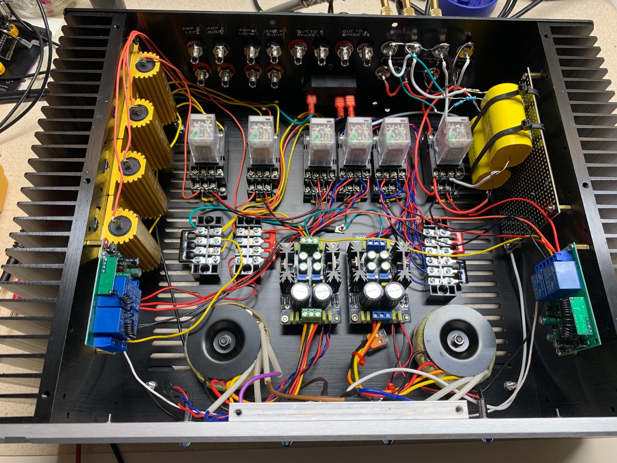

Thanks so much Mooly! Here's what I have so far. I described the capacitor coupling wrong in my last post and can't seem to edit it. Basically, the signal goes through the capacitor (not the relay) with a resistor to signal ground on the output side of the cap. --Jonathan

Hi Chris. Yes, exactly! I have two sets of wire wound resistors, one for each amp under test. Without any voltage on the relays each amp is connected to its own set of 8 Ohm resistors. Both amps receive a signal continuously. When the control relay fires, only one amp at a time can be switched to the speaker outputs.
Is it true that SS amps don't need a load? I have been operating under the assumption that they do. Still, I have 3 tube amps so I need to have the dummy load either way.
About the relays: They are inexpensive Van Aimes relays from China, but from what I an tell they are made to a high standard. Silver alloy contacts and I don't think they are making relays for the hobby market. I hope I'm not wrong. BTW they are just a few bucks a piece.
That has to be blocking DC in which case it would have a desired effect.
They don't need a load and should be unconditionally stable without. This covers 99.99% of designs.
Valve amps are different because of the transformer coupling to the load (so the same would/could apply to solid state if it was an unusual transformer coupled design). With no load such a transformer could generate very high voltage transients if signal (and also power on and off transients) was present and that can cause breakdown of the insulation on the transformer windings.
