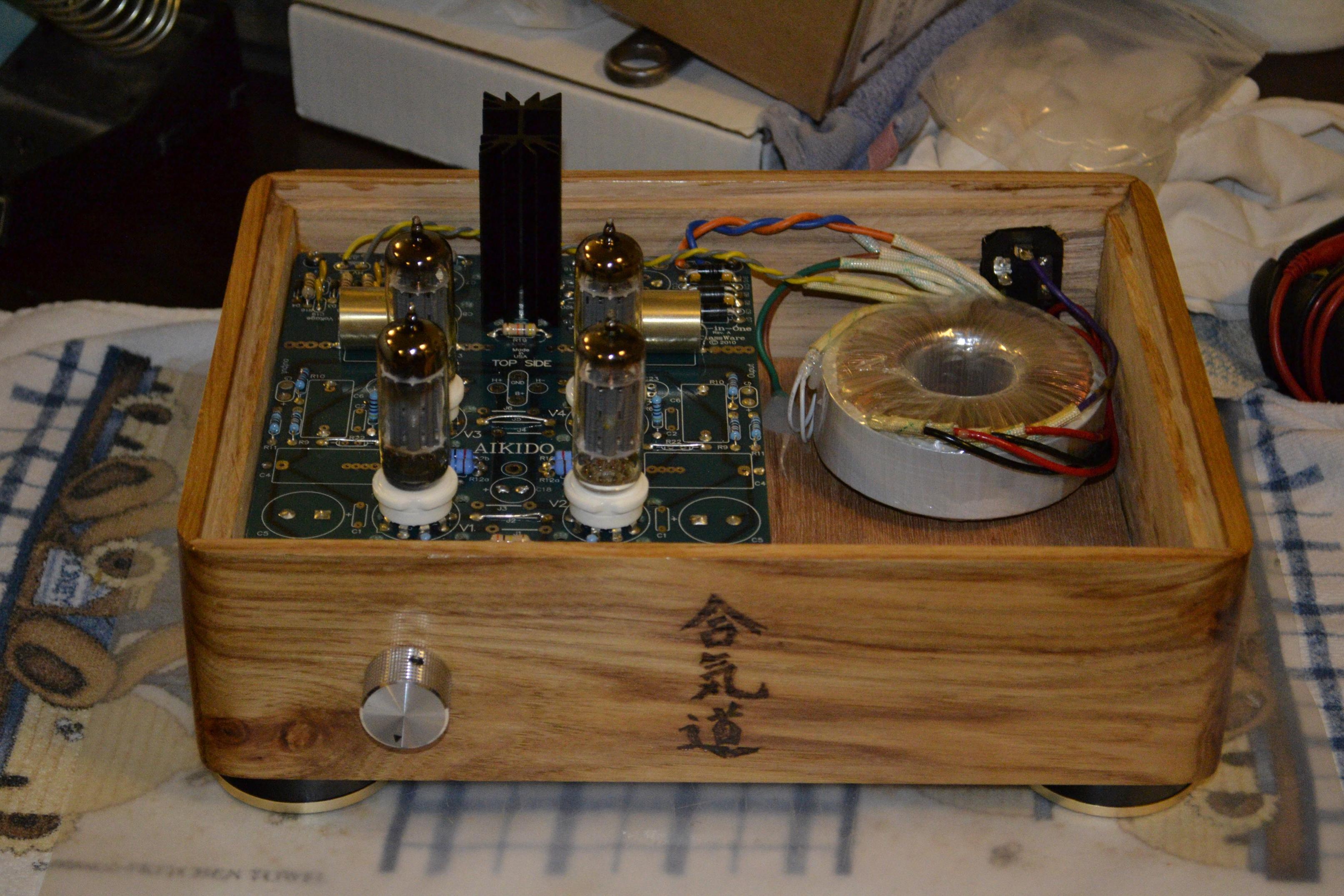

I will be driving it with an all 6CG7 Glassware Aikido.

Si,
Thank you for your kind words.
Yes I did use Obbligato Golds.
The design on the front actually says Ai-Ki-Do in Japanese.
I did it with a my soldering iron w/ a 1/8" tip.
I took the writing from Google Images and scaled it down to the size I wanted.
Then I taped it to the front and traced it with an X-Acto knife.
Then removed the paper and filled it in with my "wood burning" tool.

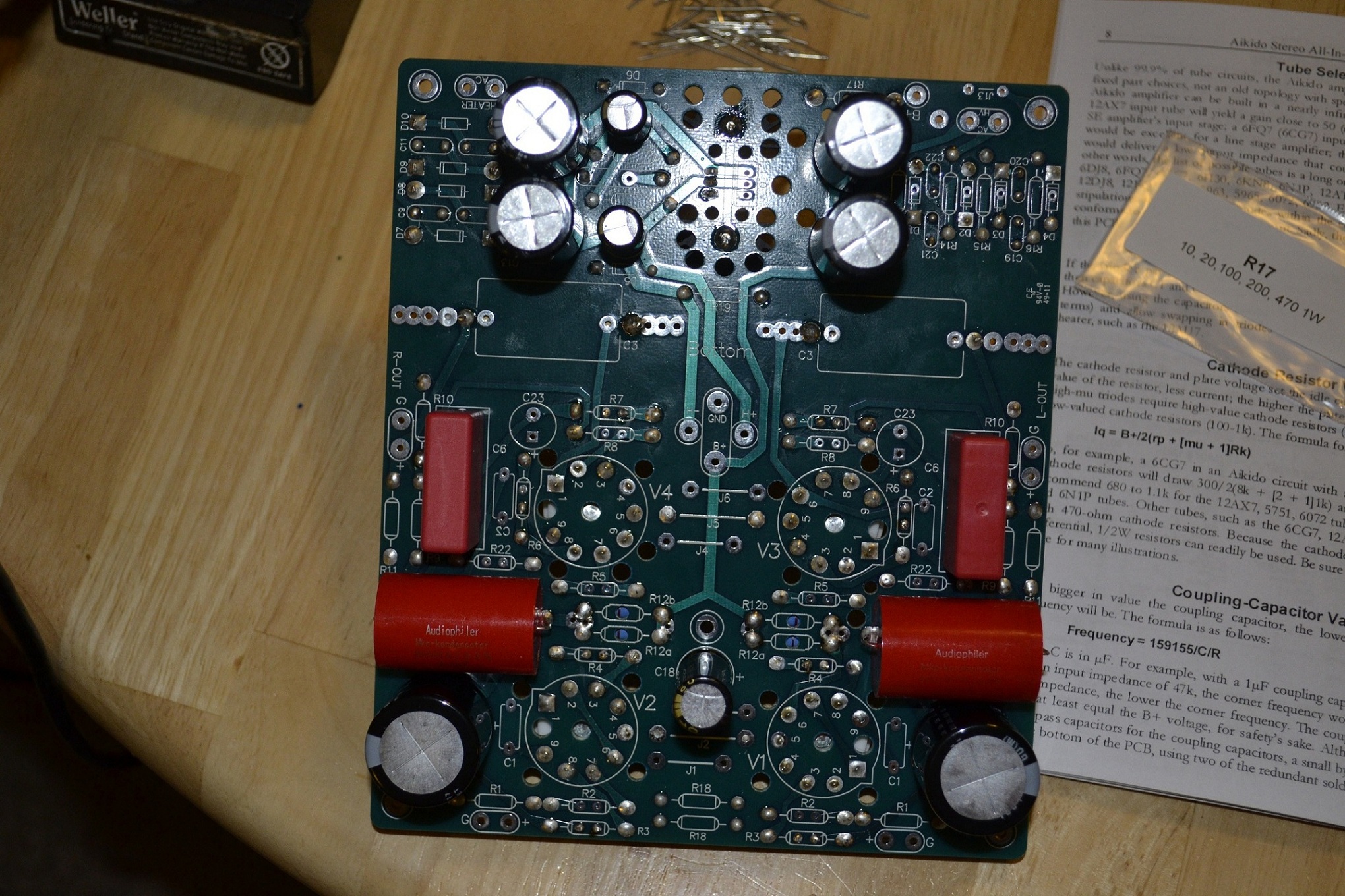

Thanks Einric
I assumed for some reason, they were probably 'coupling caps'.
But seems not.
HT power-supply bypass instead.
I have the circuit schematic somewhere on the computer.
What are the 'red-Wima's' used for in the Broskie ?
