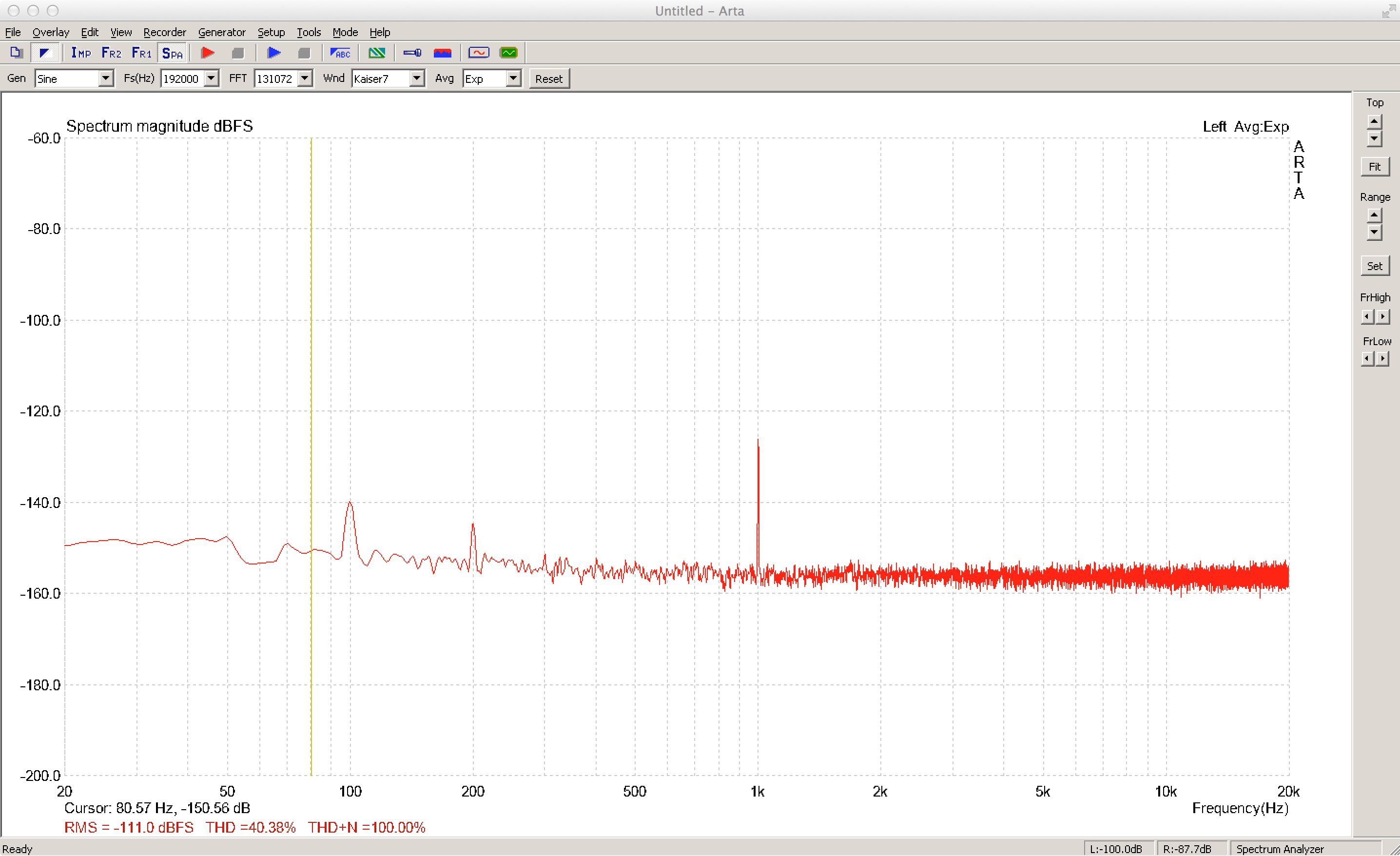

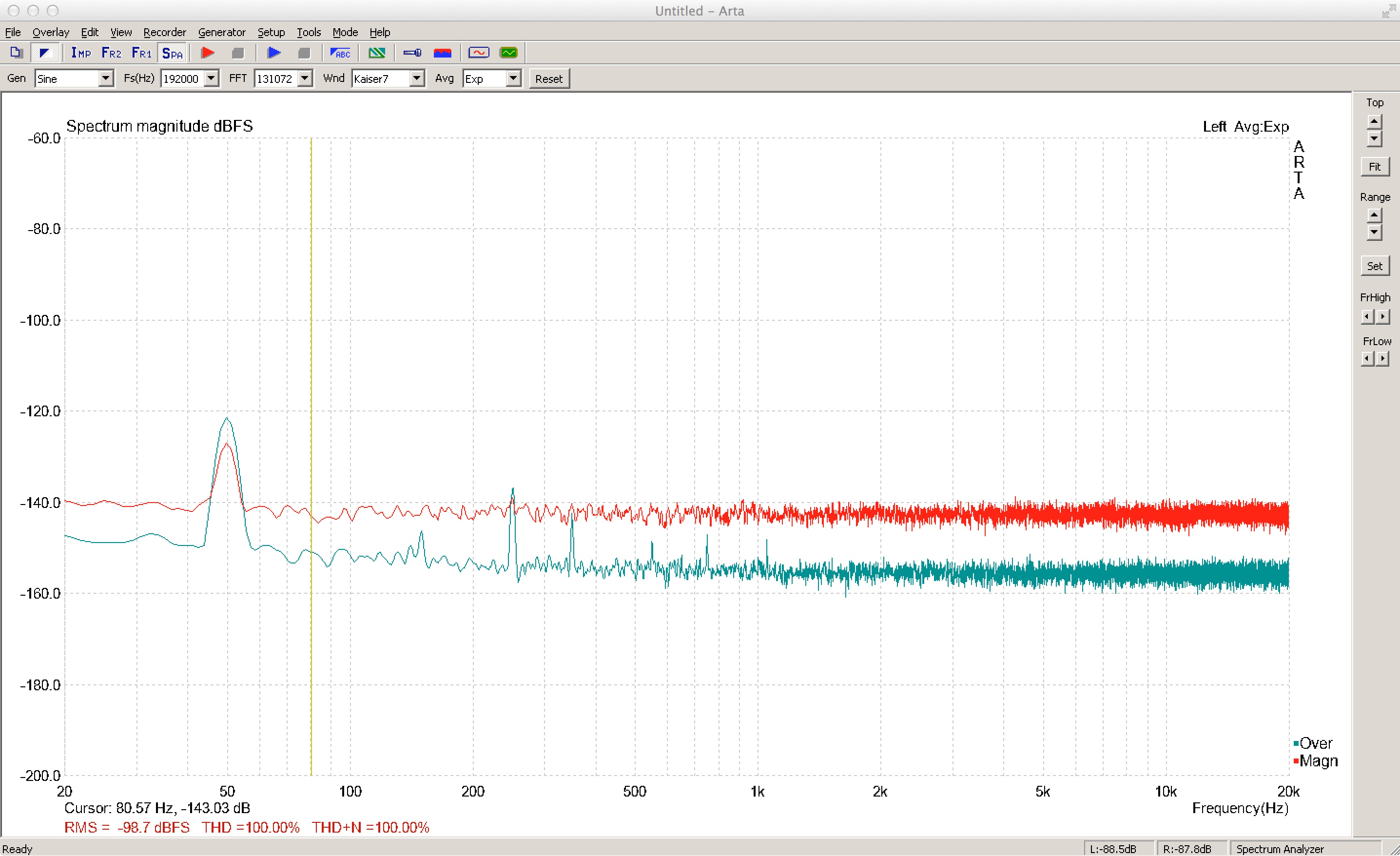

First let me stress that with termination only with the resistor I get always the low noise floor. Weirdness enters only as soon I add the capacitor to the termination in parallel. Input setting always 0dBV.
I made a new cable. The new cable has a slightly different layout: The shield of the differential pair is connected to the shield terminal of the XLR connector (only). A separate ground wire is connected to pin 1, which is used to ground the terminator.
The old cable had the shield connected to pin 1 and used the decided ground terminal of the analyser. As shield and pin 1 are grounded on the analyser side, there is no topological difference (... well see the end of the story).
To reduce possible fault reasons, I soldered the cable and the ground connection directly on the the termination, so avoiding the RCA connector.

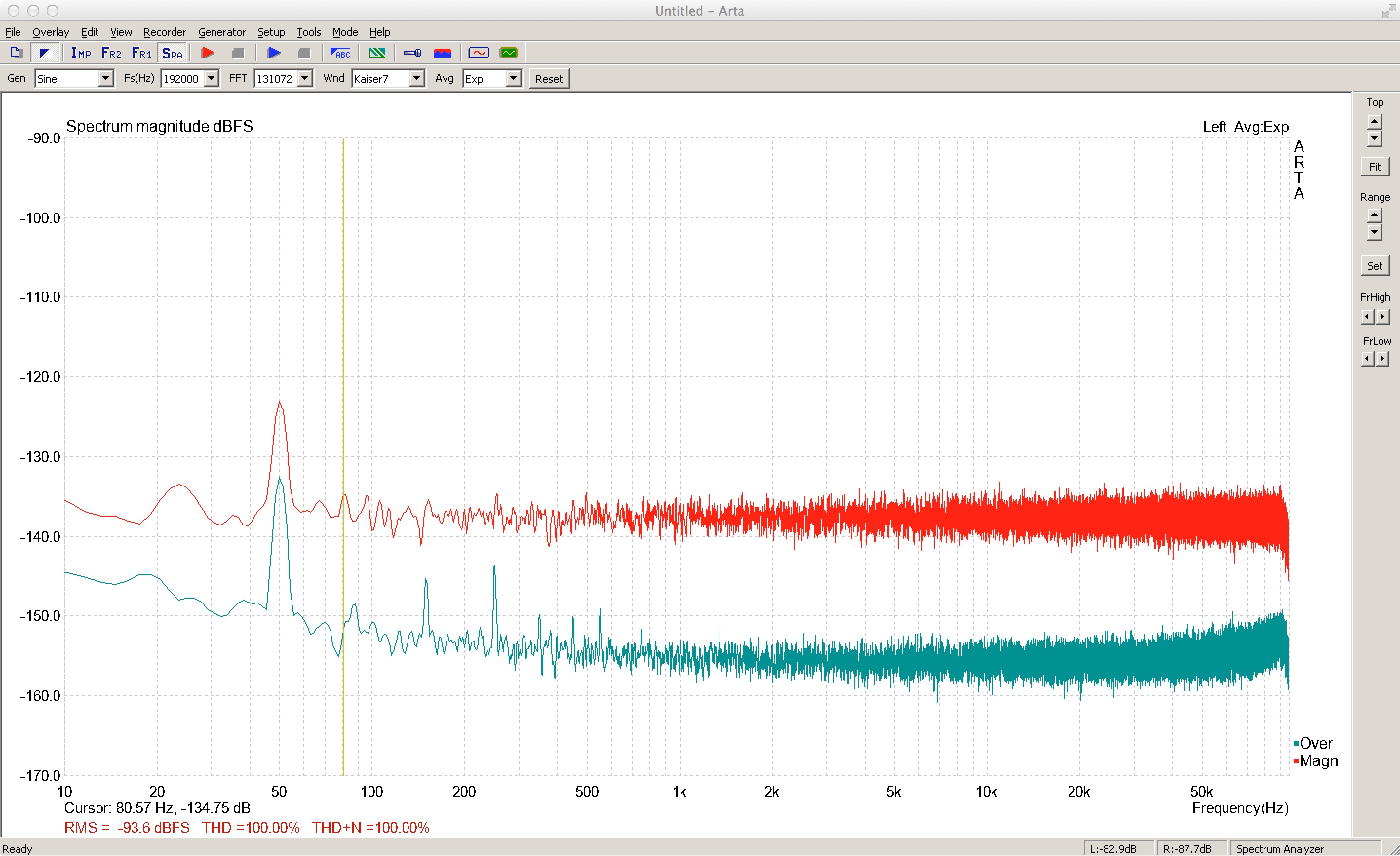

Green curve 620R termination, red 620R plus 1.5nF termination ... same picture as with the first cable.
Note that the higher noise floor looks like the noise floor with floating input, however the floating input noise floor (red) is slightly higher that the noise floor with 620R plus 1.5nF termination (green).

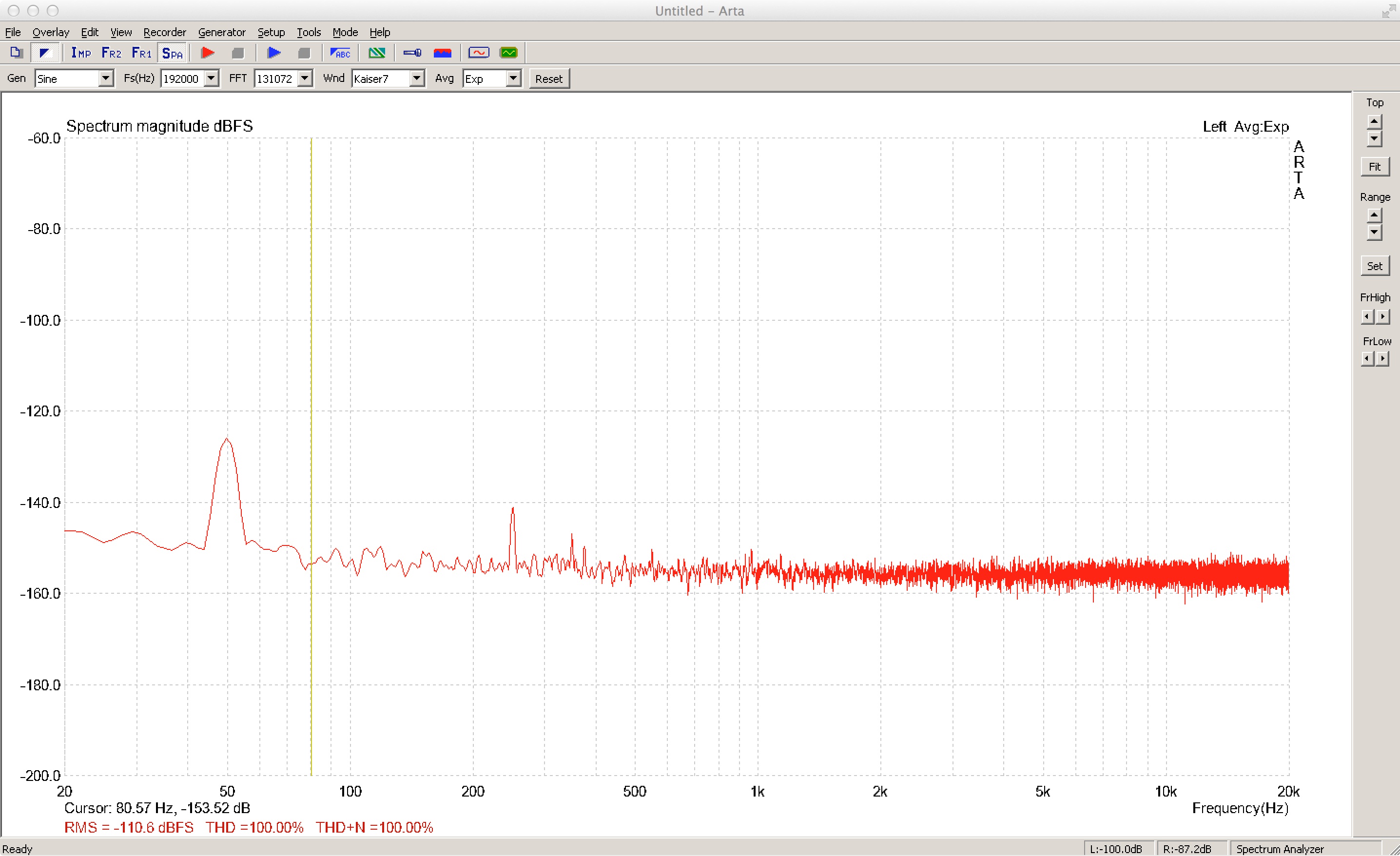

So far not much new ... but then I removed the metal housing of the XLR connector of the new cable and plugged it in the analyser to make some measurements on the contacts ... and by magic the noise floor (620R plus 1.5nF termination) dropped to the resistor only noise floor. There were more and higher line artefacts, but they disappeared when I connected the now floating shield to ground via the dedicated ground terminal.
This is twofold weird.
1. that the noise floor dropped.
2. that the noise floor did not raised again when I connected the shield to the dedicated ground terminal. The XLR input connector of the analyser has internally connected shield terminal and and pin 1 (ground).

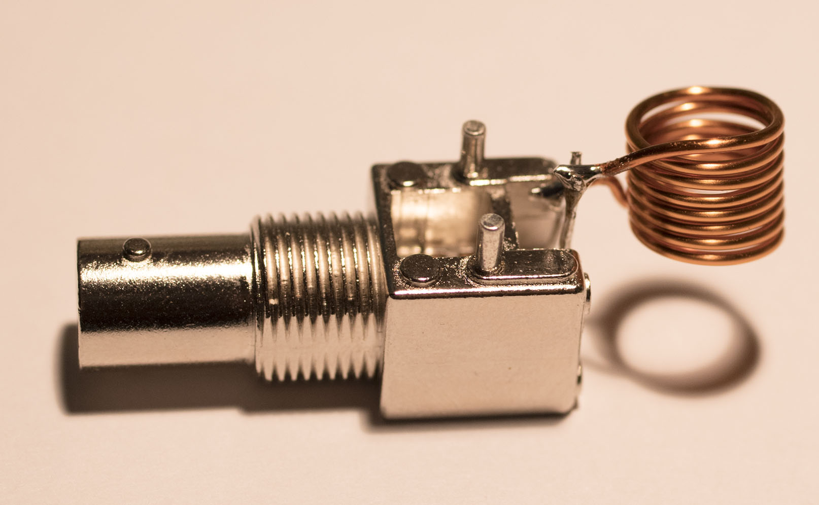

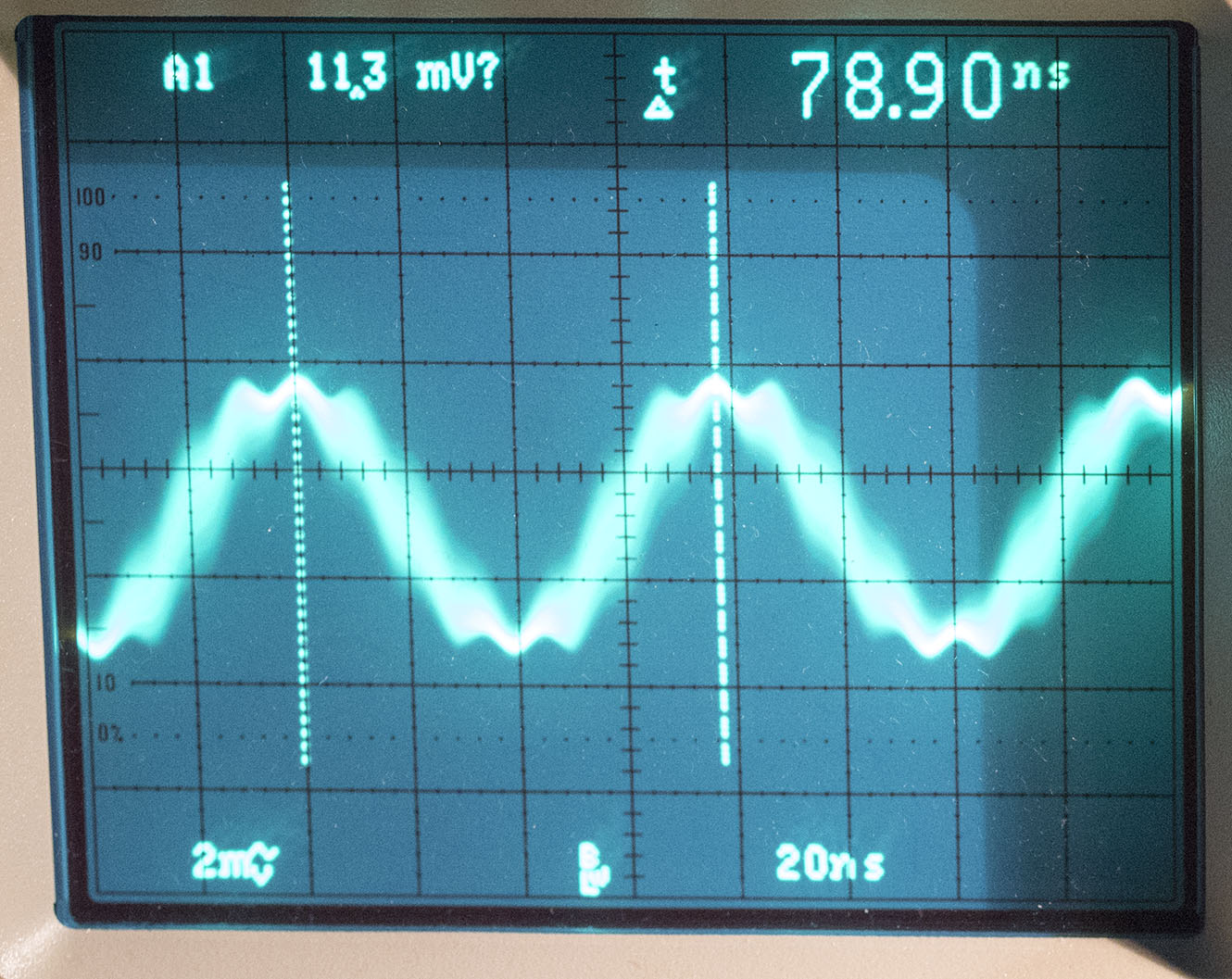

With the suggested coil probe I found a signal correlated to the higher noise floor:
So the oscillation is of about 12.7MHz. There is some higher frequency component that is independent from the RTX-setting.
The displayed curve goes away if I go away with the probe from the termination. It goes also away if I remove the shield of the XLR connector (i.e. get the lower noise floor). I get a similar picture with the first cable.

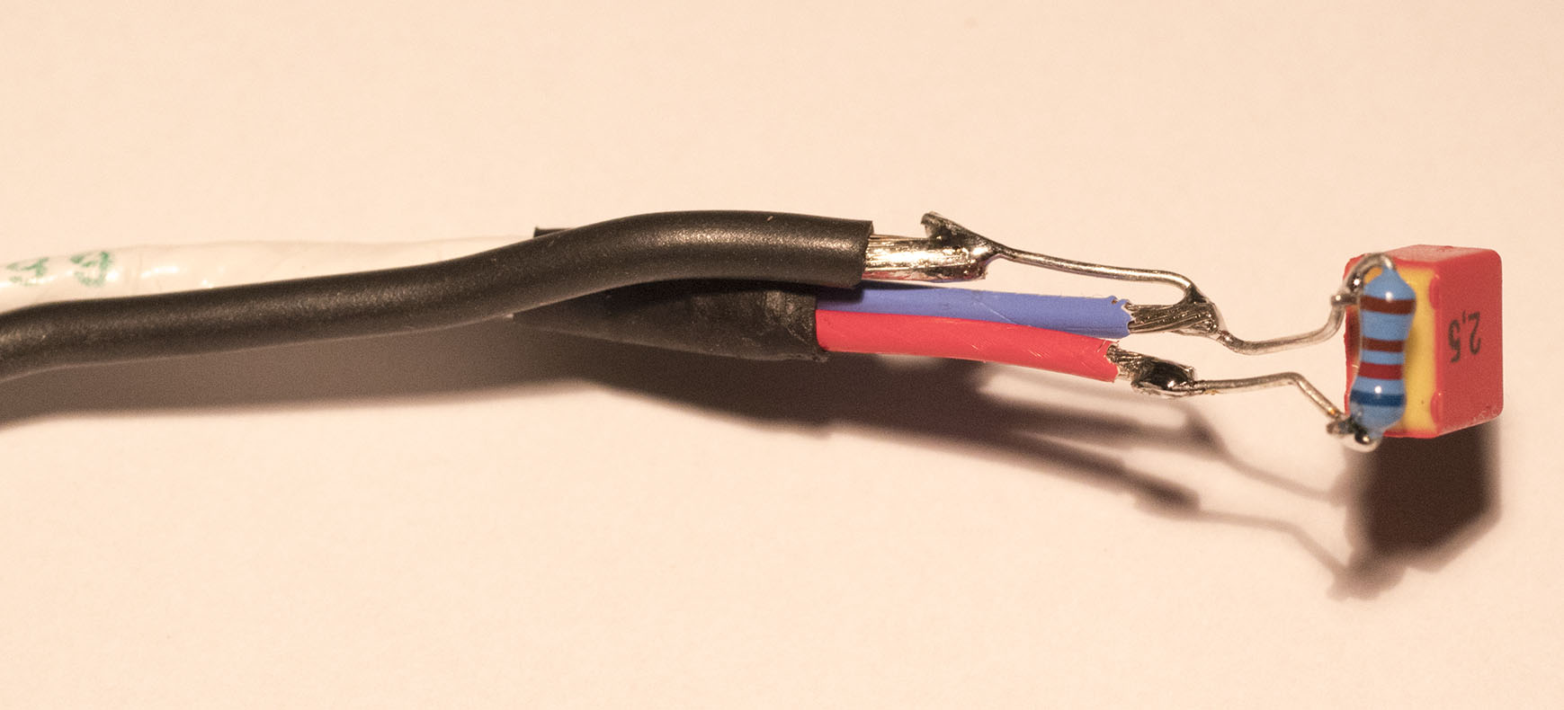

Here a picture of the coil probe. It has an inductivity of about 0,4uH.
Here a picture of the termination of the cable.

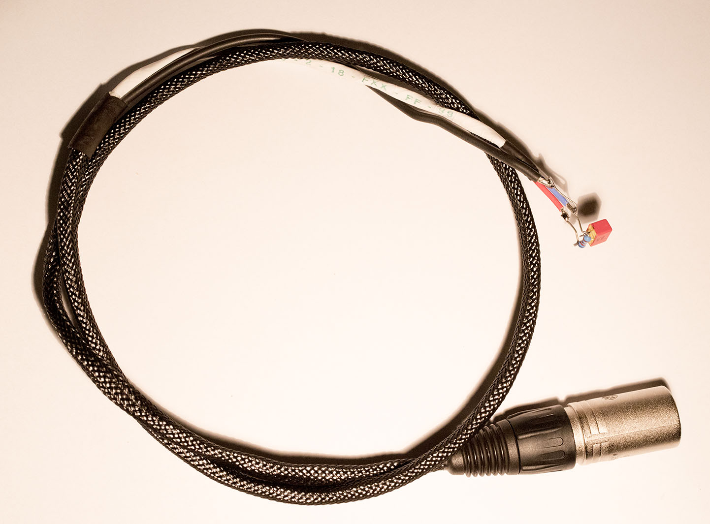

And here the cable itself.
The cable with the balanced pair (white sleeve; twisted red,blue cable) is 18AWG (0.8qmm) wire as well as shield and has double isolation PTFE over Kapton. Red is to XLR-pin-2, blue to XLR-pin-3, shield to XLR-shield. The black ground cable (XLR-pin-3) is 16AWG (1.5qmm).
The length of the cable is about 80cm.
You get the best reading of the oscillation, when putting the coil right on the red and blue cables just before the termination.
The first cable was a microphone cable with an RCA connector on one side, thinner wires but shorter.
