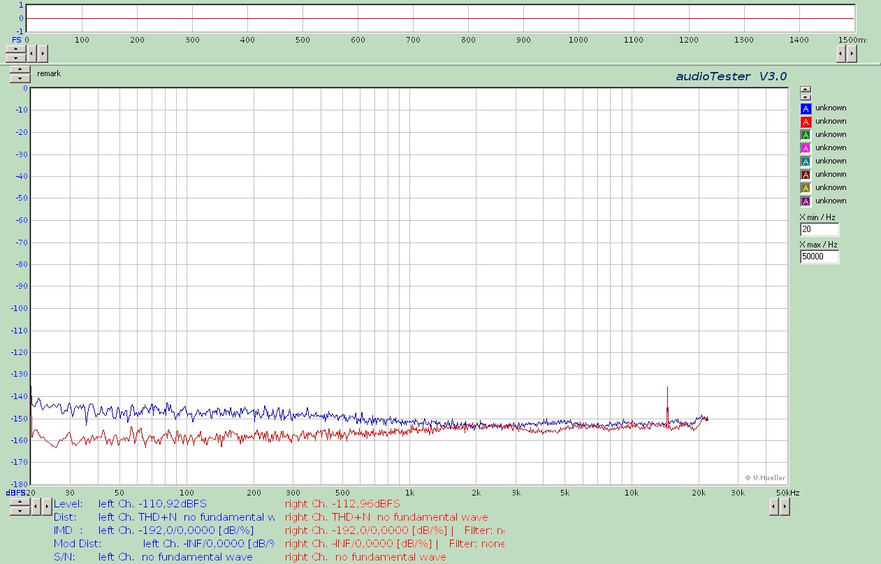

One more ADC to compare to, the Beis AD24QS DIY-ADC (CS5381 based: AD24QS and DA24QS - Audio ADC and DAC, 24 Bit / 192 kHz).
The ADC is single ended. Use the input floating or shunted does not make much difference, especially there are no 50Hz-line artefacts.
The measurement is made at 44.1kHz sample rate for convenience (Mac Pro optical-in limitation). The difference of l-r and the 30Khz spike of the Beis ADC is only there since a not 100% successful attempt to repair it.
In the case here - a loopback measurement of the RTX6001 itself - the no-17 connection makes no difference as the sleeve of the BNC-out is connected to ground. It makes essentially no difference where I connect Pin 1 and 3 - at source side, at ADC side, or just connecting them and leave the 2-pin floating - I see the same.
I attached pictures for all input settings from 40dBV to -20dBV and, to compare, the last one the same (channels reversed) with a RME Fireface800 with -10dBV input stting.

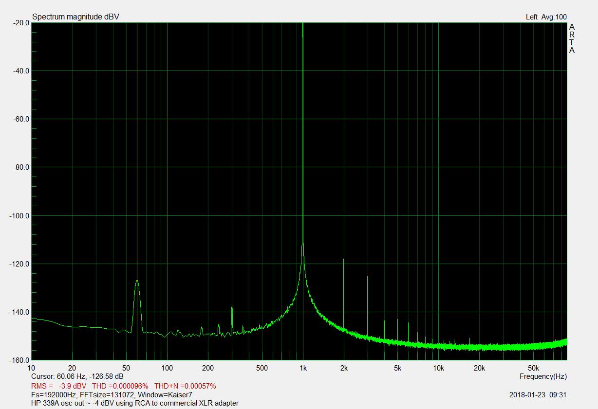

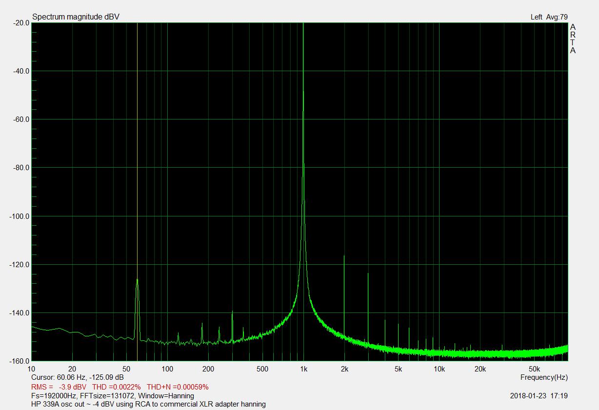

I've never heard of an FFT window setting of Kaiser7 before, and I was suspicious of the exceedingly low distortion numbers I was getting using it. My normal setting for an FFT analyser is the old Hanning window. That one I know returns accurate answers, or at least answers that agree with other methods of getting a number for harmonic distortion.
Here are a pair of screens showing both windowing selections on my HP 339A distortion analyser. Which of these do you believe is correct?

I use Kaiser 7 for most of my measurements.
I have also used Hanning and Blackman Harris..
Anatech: That one I know returns accurate answers, or at least answers that agree with other methods of getting a number for harmonic distortion.
Second part of the statement is true, they are just different ways of applying windowing. Measurements performed with different windowing may or may not be directly comparable.
Hi Kevin,
I'm going to use the Hanning window. It agrees with the industry and gives me a more realistic answer. I don't need or want "sunshine up my rear numbers". The cold hard facts will do nicely, thank you very much.
The Hanning windowing generates answers close to what my distortion test set returns. and that agrees with almost every distortion analyser I have used in the past. The Leader instrument was also overly optimistic, especially when looking at 10 or 20 KHz fundamentals. I found out later that it's response was diving at 30 KHz (filter out) and not the 100 KHz claimed. Of course it read low distortion at higher frequencies. I had used it for years without knowing this. I can't stand it when equipment lies to you. This is what is happening with the THD measurement using a Kaiser7 window.
The Kaiser7 window might be useful for tracking down problems and for the IMD test. I'll have to see if it agrees with known correct answers. That's as soon as I can find something to compare to. But when designing and exchanging information about what numbers any of my creations are operating at, I could do without the embarrassment. If anything, you would want to be a little pessimistic.
I don't think it's lying. I think it's just using a Kaiser window, which is different to a Hanning window. There is no "right" or "wrong", it's just different. Like apples and oranges.
The second graph in post #1623 is very interesting - the THD+N figure is lower than the THD figure.
Uhm, well, maybe that software is lying. 😀
Well, I know that the answer depends on the window being used, but I still think there is a right and wrong. The Hann window is appropriate for single tone THD tests whereas the Kaiser7 window is better for the two tone IMD spaced closely.
What I think is important is that the answers you get and figures you quote should agree with the world's accepted standards. It is entirely pointless to quote numbers using a system intended for a different measurement. So in that sense, using Kaiser7 for THD tests would be incorrect, it's the wrong window type if you read up on the various window types. As a crosscheck, the Hann window generates numbers that can be verified using other test instruments.
I can't understand why anyone would wish for overly optimistic figures in the first place. The answer just is, and looking at numbers generated by using the wrong windowing is a complete waste of anyone's time and energy. I don't believe there is a conversion that can be used between the two THD numbers either, making the wrong windowed numbers utterly useless.
It would seem that either members using this equipment bone up on windowing and what each type is good for, or they need a short course on the subject.
-Chris
There is something very wrong with the Hann measurement you've shown in post #1623, and it's pretty meaningless to compare Hann with other windows based on that measurement.
I use Hann 99% of the time also (the only other 1% is when comparing results with other people, like in here, so using the same windows others have chosen). I just compared Hann and Kaiser 7 in ARTA using the same setting you've shown, the THD difference is within 15% but not 20 times.
The measurement of the THD+N that is bigger than THD is not right!

Hi ej25awd,
Check your last post with the plots. The THD and THD+N readings for both don't make any sense at all.
Yup, I know. I copied the screen and saved into a file. Check the picture carefully and you will see the settings are as I indicated. ARTA seems to make gross errors sometimes. Please note that the connections and levels were not adjusted between screen captures. The only thing that changed was a new window type and acquisition. The average was linear at 100 samples as was recommended earlier by someone.
Anyway, there is nothing that I can do to make ARTA read that way. It does it's own thing. The Hann window gives me numbers that correlate to what my analog distortion measurement set reads, an HP 339A. The Kaiser7 window is completely unrealistic.
I just tried the same measurement again just now. All I had to do was turn the equipment on and plug the oscillator output from the 339A into the RTX-6001. I still get similar numbers with the THD+Noise reading much lower than the THD only reading. THD= 0.0016% THD+Noise=0.00068%. So that's a day later with the equipment having been turned on just now. So it's impossible that the program was in an odd memory type problem, a total, hard reboot of software and hardware.
This isn't a problem with the RTX-6001. It is an issue with this expensive software program. It isn't anything that I am doing as this is beyond my control.
