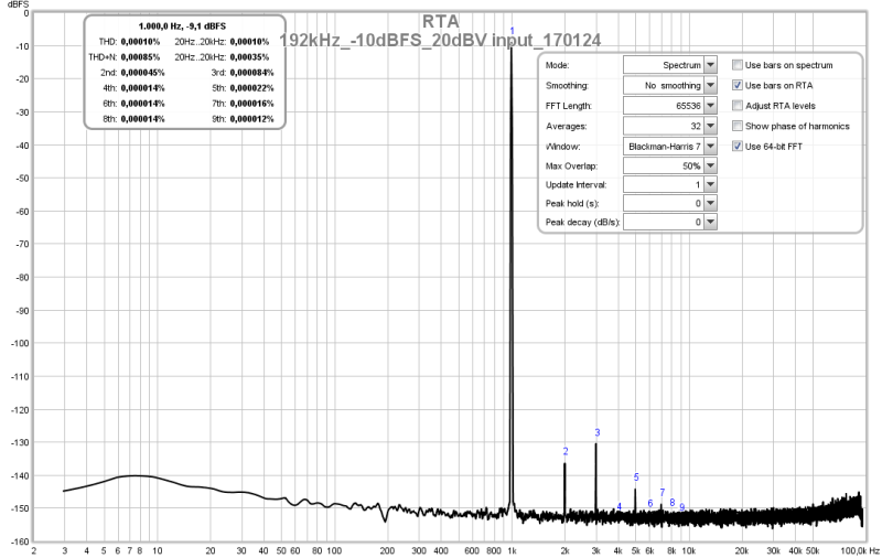

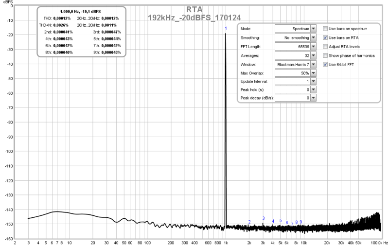

I made some loop back measurements with the REW generator and RTA analysis. It was the first time that I used it, so bear with me if it is does not cover all your wishes. I measured at output levels of -20dBFS, -10dBFS and -3dBFS. For some reason the program would not let me go higher than -3dBFS.
At the high level it is clear that the distortion of the DAC increases.
