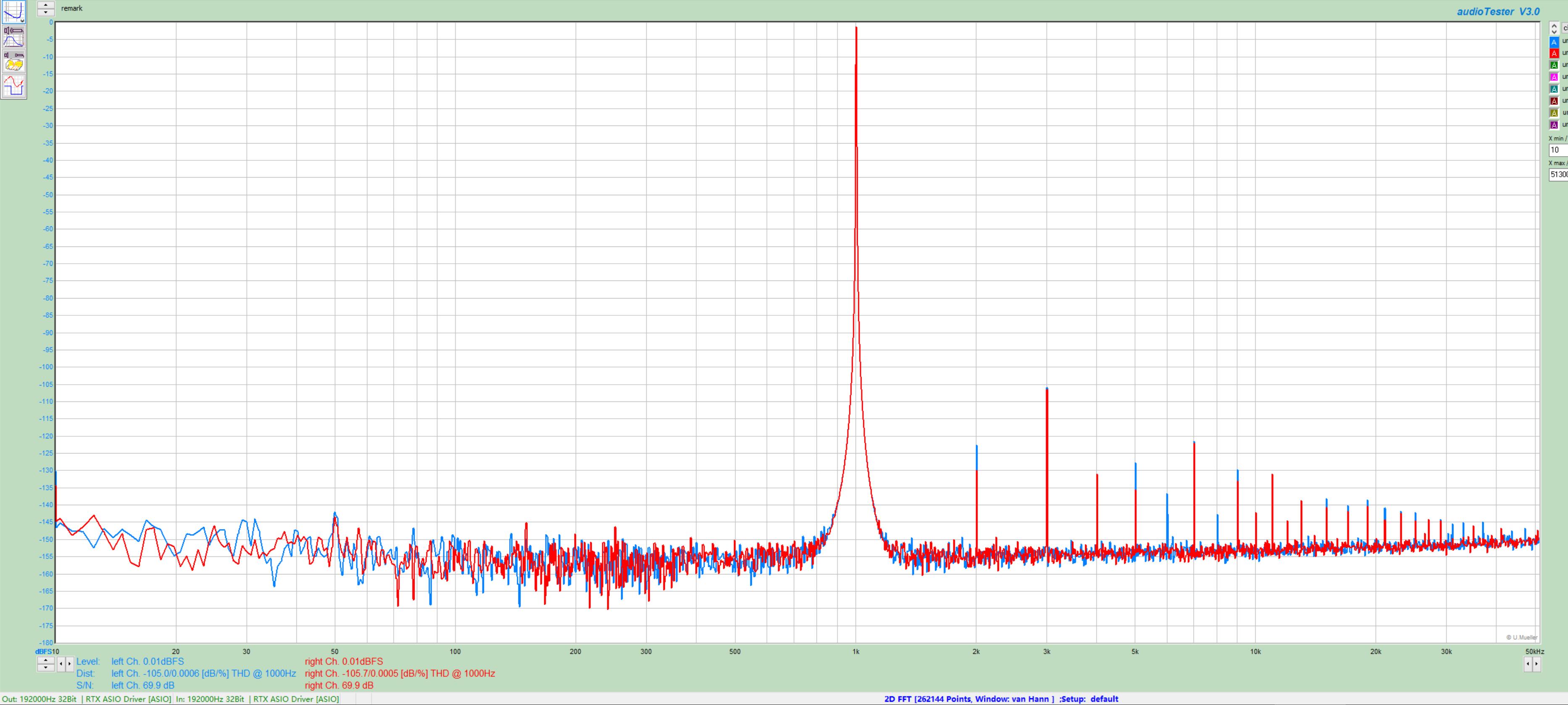

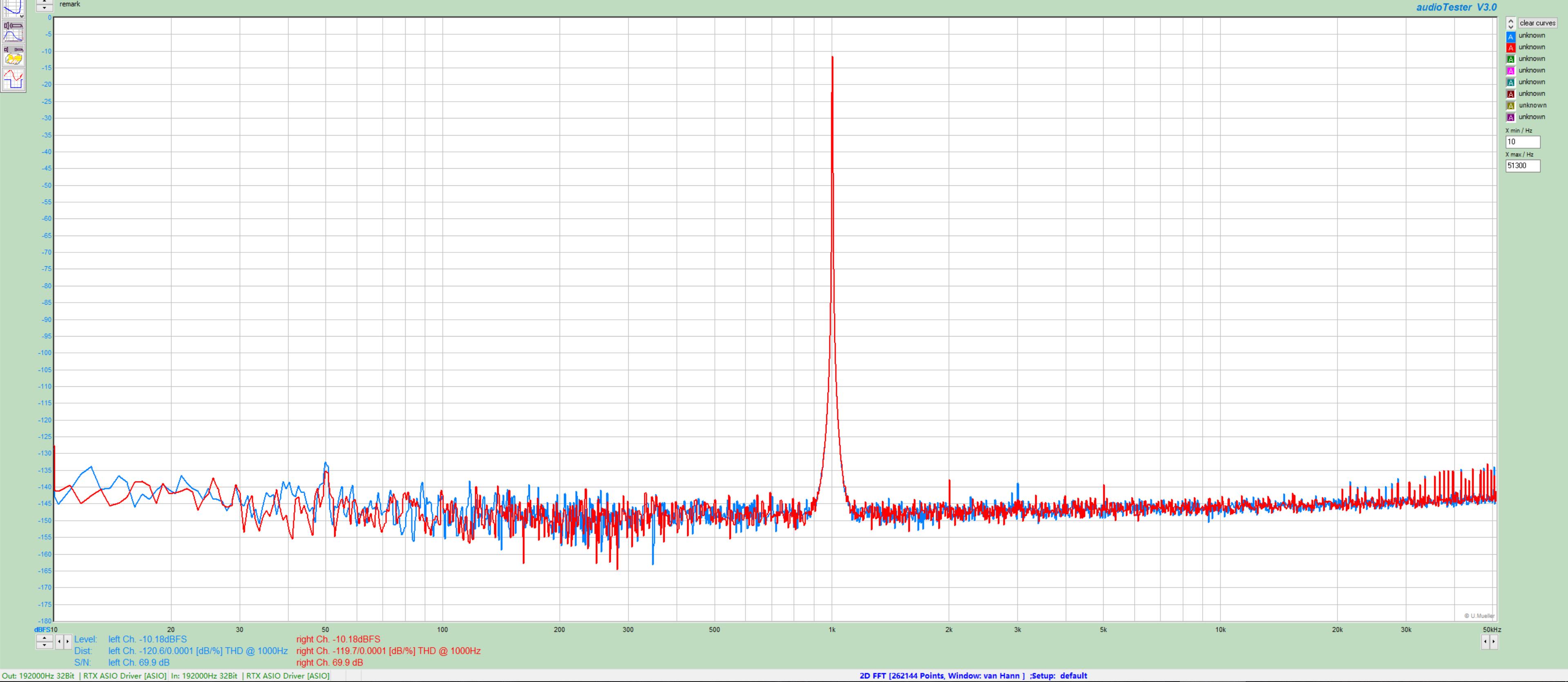

harmonic

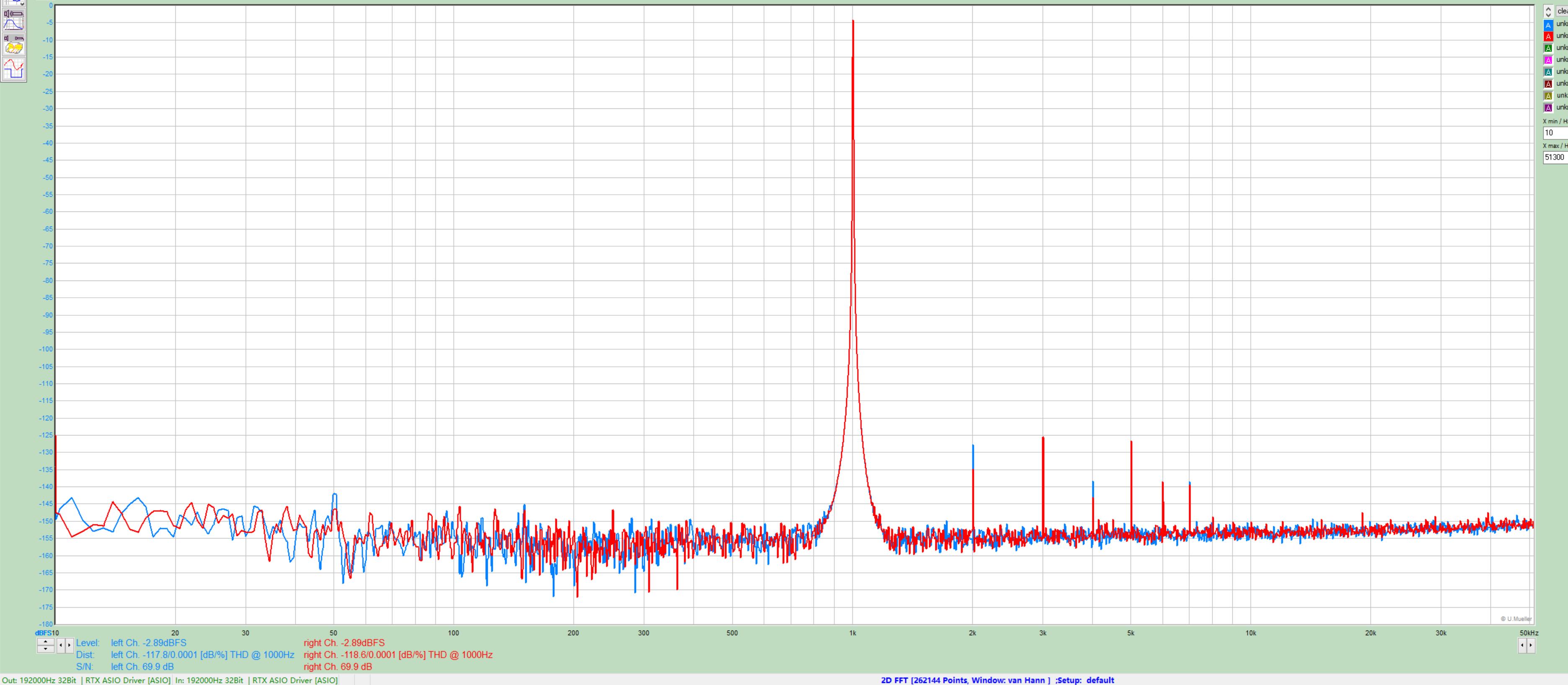

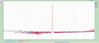

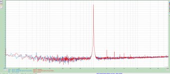

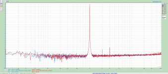

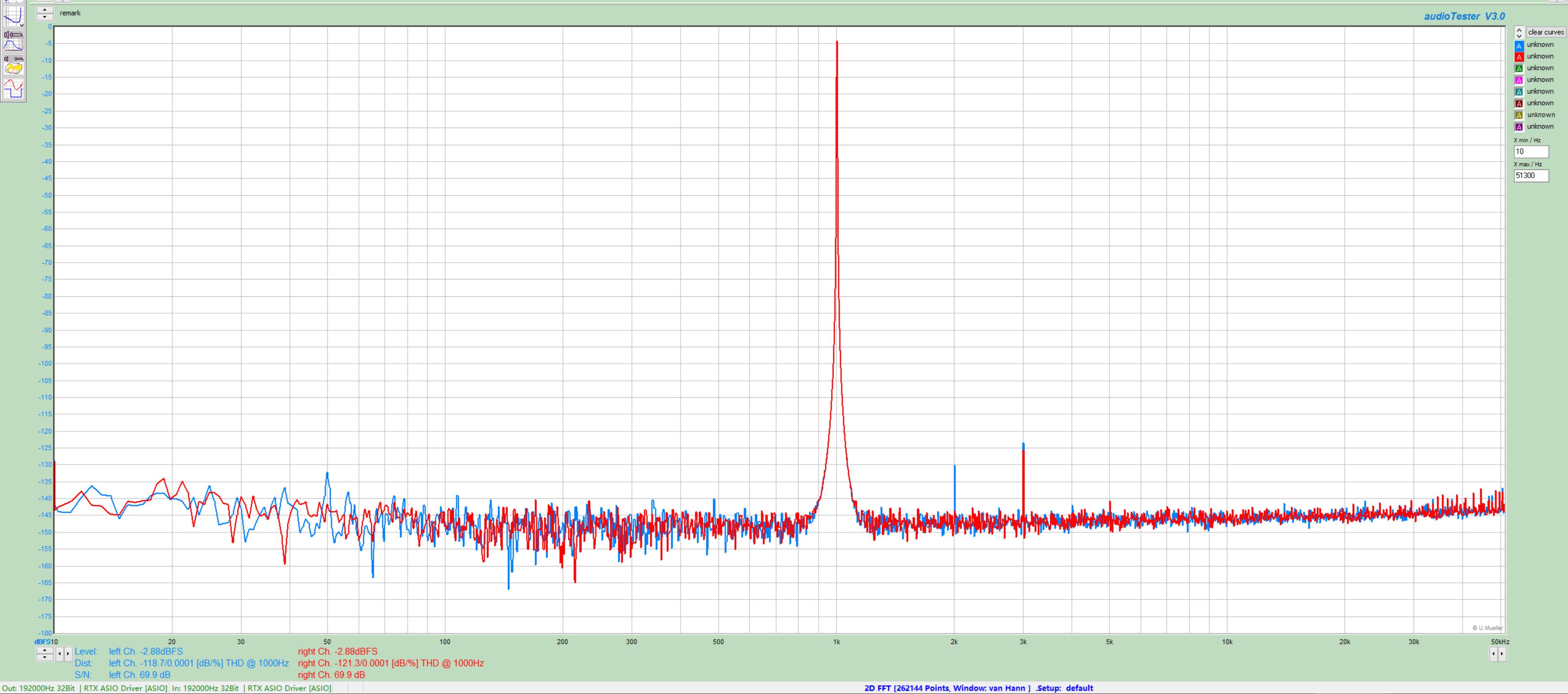

I test my RTX6001 by loop,i get some high level harmonic,is that normal?😕
1st PIC is 0/0dBV ,audiotester set 0dBFS.
2nd PIC is 0/0dBV ,audiotester set -3dBFS.
3nd PIC is 0/0dBV ,audiotester set -10dBFS.
4th PIC is 20/10dBV ,audiotester set -13dBFS.
5th PIC is 20/10dBV ,audiotester set -20dBFS.
