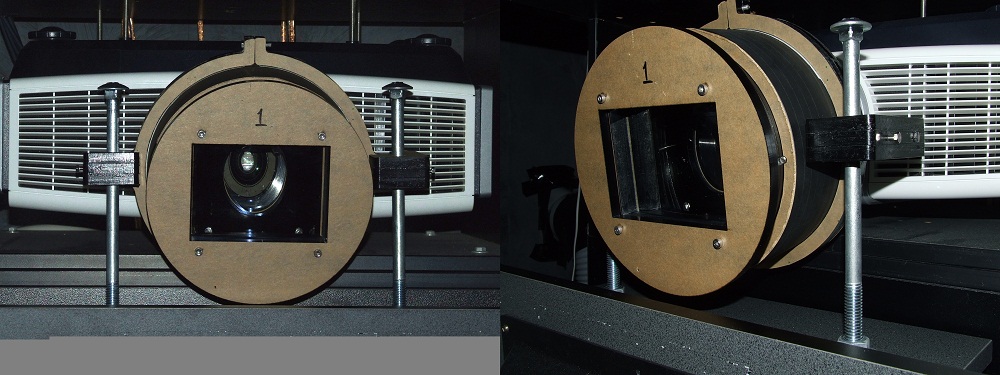

Anyway, in case anyone is interested, here is my latest project - the MK5.
attachment.php
