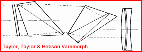

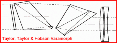

My thinking about front and back elements got started for me when I saw the attached picture from the Widescreen museum (http://www.widescreenmuseum.com/Widescreen/wingvv2.htm) showing an early prism based design. Even in this early design they were using leading and trailing elements.

And it makes sense too. If I am understanding the diagram correctly, they have used an achromatic doublet (Miniscus lens made from bonding a bi convex to a bi concave - each part made from different glass to correct for CA as well), then two prisms, then a final (focal?) element...
